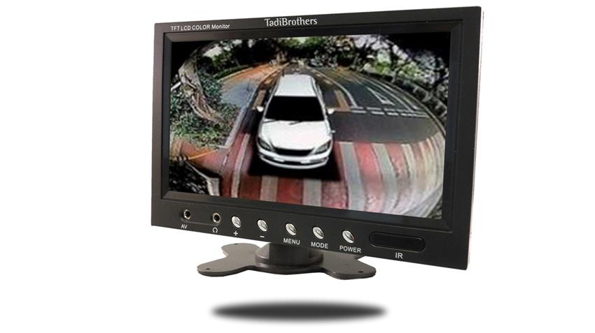

My garage door is going to be pretty narrow so I am thinking of installing a 360 camera that would provide "always on" (if desired) capability that would enable me to see around the entire car. I also want the Rear View / Reverse functionality with the gridlines. These 360 systems are now starting to come standard on OEM vehicles. However, the aftermarket systems don't have much customizable attributes. The most desirable one is to actually have our SLC car pictured in the center. I am pretty persistent and did A LOT of research. I found a company here in the USA that makes there own software and are willing (at a cost of course) to modify their software to put our SLC into there software.

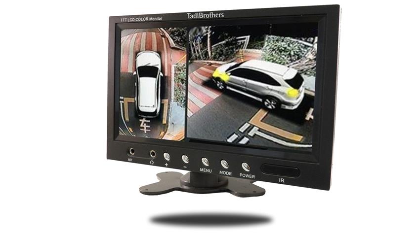

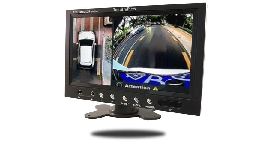

Here is the link to the system which costs $550 and comes with the 4 cameras, wires and 7" LCD display. Also below are a few screen shots of what you would see. (NOTE you will need to image the car being an SLC :cool: instead of the Grey SUV)

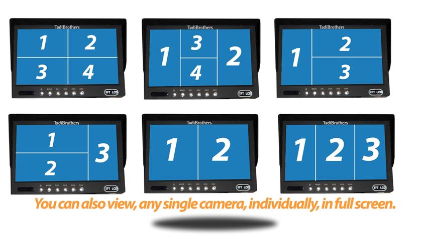

And a figure pictures of how the system works.
A few points on how it works:
  1. There are 4 cameras that are mounted (in the rear, under each side mirror, and on the front)
  2. During the install you calibrate the system so that the cameras mesh their images together and then you can have overhead, side, front or rear views looking back at your car AND/OR looking out from your car.
  3. Note Shown in the Pictures above - but there is also a Reverse system that activates that gives you all of the same rear view reverse functionality found in all vehicles today
  4. The system also has a 28 hour DVR that records for play back. This would be ideal for track days or if you encounter any issues from other vehicles while just driving around town.
