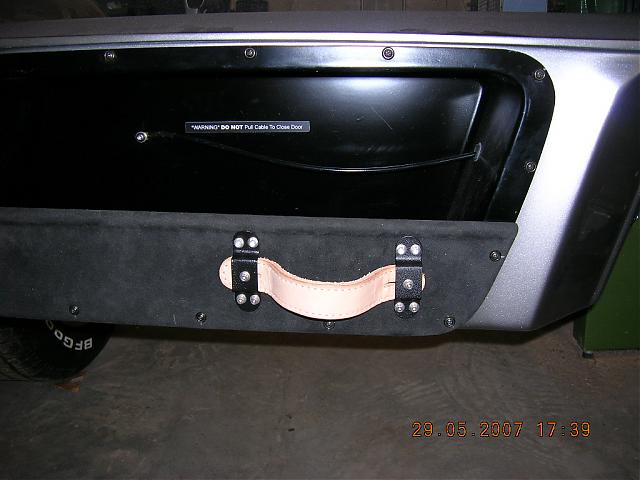

My understanding was that a few people (usually excited passengers) had been yanking on the cable to pull the door shut. It's not surprising that the connector might fail under that kind of mis-use.
As I'm sure you all know, no two original GT40's are alike in every respect. The car that SPF patterned their car after had the cable style door release mechanisms. There was a tech bulletin released shortly after the release of the first SPF 40's that said "DON'T USE THE CABLE TO PULL THE DOOR CLOSED" I took that to heart and made the labels and door handles shown below. I was told by Tim Ganskop (a forum member) the he was the one that supplied all the original design drawings to Hi Tech Automotive that they then used to build their version (warts and all). It would have been nice if they had picked the best of all the different design ideas but that is not too practical unless you want to spend a decade doing the research and surveys to see what customers think is "best". I find that the cables work just fine as long as you don't yank on them. It takes a very light touch to actually operate the door mechanism. There are many areas of these cars that are "delicate". They were designed to last 24 hours and if they never ran again so-be-it. SPF tried to replicate the original race car faithfully and I think they did a pretty good job.....warts and all. There are a great many items that SPF could have improved on (and I personally wish they would have) but they made the decision to keep it as real as possible and they did. A perfect example is the weather seal. The originals leaked like a sieve.......guess what......so do the SPF cars. Don't drive in the rain without a wet suit.

For what it's worth, the cable pull matches the Ferrari F40. The cable pull seems to be one of many steps several manufacturers have used to "reduce weight". Having said that, I am concerned about the cable pull when shutting the door so I like Lynn's idea of installing a handle where I want it. On somewhat of a related note, I asked Ian Grunes at Dynamic Motorsports to see if SPF would fabricate a locking outside door handle. It seems a lot of guys want a bit more security inside and outside the cockpit.
