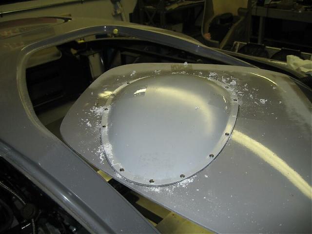

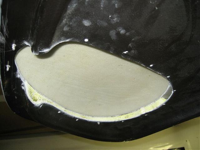

Hi guys. I'm looking for ideas and experiences with finishing the interior half of a Gurney bubble. Since mine is a street car, I can;t really leave it in its current configuration - see pictures.
I opted to fasten it to the roof with (6-32) screws, because I like that look on the original cars and because I didn't want to fiberglass it in. I'm thinking about releiving the inside fiberglass a bit for a little more head room and glassing over the gap between the inside and outside roof panel. Before I can glass that gap in, ouf course, I'll neet to fasten #6 nut - probably epoxy them to the bottom side of the outer roof panel but I'm open to alternative ideas.

Mark, I intend to stick mine down with 3M 5200, the mother of all bonding agents, and put screws in for decorative purposes. I think my door is hollow and if it is, I will be shooting in some expandble foam to stiffen door and provide a base for tapering the door into the bubble.
Brian
Ben, the underside has a very small taper and isn't flat. I haven't measured but I believe it allows a full 2" of additional headroom, which is more than I needed. I'm only 6' 0" tall, but have the torso of someone who is 6'4". My head barey touches the ceiling when I sit in the car, but without the bubble I would have to slump in the seat if I were wearing a helmet.
Jimmy, I think 4-5" relief of the inside panel might be a bit too much - I'm thinking something like 1.5-2". But it would be nice to see how other folks have done it. Yes, I have eyebrows also and intend to fit them.
Brian, you can see where I injected the expandable foam in the second picture - I drilled a 7/64" hole in the edge of the door and injected a bunch of Dow "Great Stuff" expandable, flexible foam sealant (I used the Door and Window variety). As you can see, the foam didn't fill the entire door cavity, and I need to get another couple cans of that goop. I'm also running it inside the spider cavity.
I guess a permanant seal with 3M 5200 or epoxy would make sense, since I can't think of any reason I'd need to remove the bubble after the car is finished.

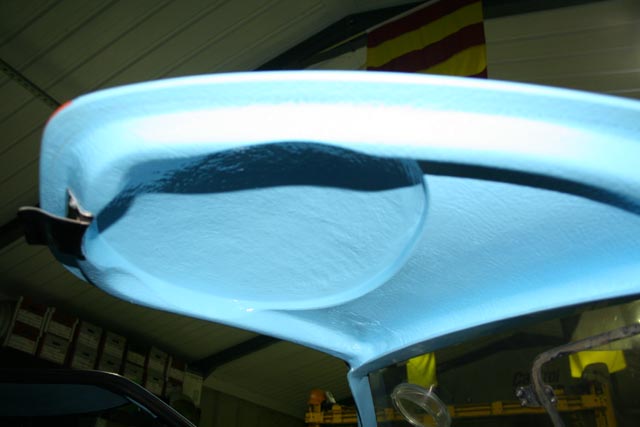

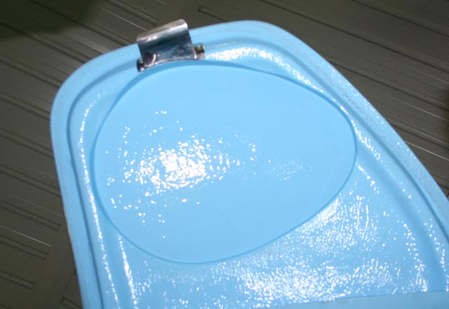

hi Mark, nice to see some shots of your car, not seen many for a time. Are you making yours as shiny as Brians?
I have just put a gurney into my car. I attach some pictures but I suspect they won't be as helpful as you would like because I glassed mine in. Well I didn't, Lee Dawson did. He did a great job and I highly recommend him.
A couple of comments, I think you might to look at the strength of the door top as you seem to have chopped out part of the inner moulding that I would expect to have given strength to prevent flexing. If you are to glass in that bit, can you glass in some ali or stainless reinformcment to replace the lost bracing? Your bubble seems quite far back on the door top.
The bubbles are tear shaped so is there a "right" way and a "wrong" way to fit them? I don't know, I left that to Lee to do as he saw fit. He had the original GTD template to help though.
I have used mine both with and without helmet. It made a big difference in head room and I no longer have to scrunch down with a helmet on. Huge improvement. I am only 6ft.
I would have put in eyebrows but no one seems to have metal eyebrows on the shelf. Plastic ones yes, metal no. There is a market there for someone....

Thanks for those pics, Malc. Nice job on your install. No, my GT isn't as shiny as Brian's, I've been kicking up some dust in the garage lately, which is a good thing.
I'm not too worried about door strength because the top of the door appears to be non-structural with its only function to keep the elements sealed out of the cockpit. With regard to location on the door, I sat in the car in the seat with my arms on the steering wheel and had my brother stand outside and position the bubble for maximum headroom. I guess I can call mine a Worthington bubble, because mine is customized for me!
Hmmm, I guess it would be fairly easy at this stage to glass in this bubble from the bottom and then just fill in the gaps with some body filler.
Malcolm
