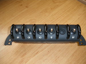

Hi Robin,
I don’t see why your idea wouldn’t work. My only reservation would be that it would have to be quiet wide strip to give the necessary cover to the switches when they are in the on position. It may also seen by the inspector as a clear test fudge. I’d be more tempted to have a separate panel with the switches bunched up to meet the requirements or just add switch radius protector, similar as fitted first generation BMW Mini
Andy
Same as Andy recommends IMO.
CBS do them, but at £6ea and you need two per switch, it could add up to a bit. I plan on just bending up some spare brake pipe and then doing a similar thing
I have seen someone else here or on another forum that used small drawer pull handles as the protective hoops and it looked quite good actually. Another thing you may try would be large diameter, yet thin, fender washers that were bent to provide the radius and the switch retaining nut would hold that in place.
I do like the look of that panel that Andy has shown above.
