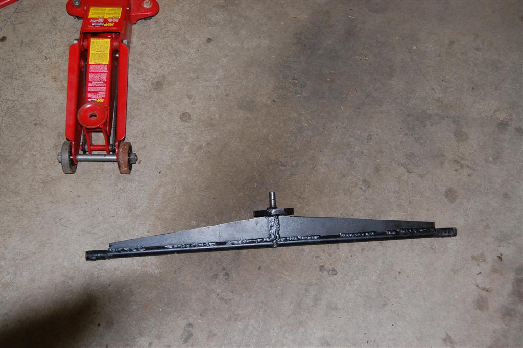

https://www.gt40s.com/attachments/dsc_0200-large-jpg.55646/
This is what I use at the front. At the rear just use a hydraulic jack under the square tubing. I think trying to use a manual quick lift at the rear would require a very long jack considering the weight. Although the Rorty Jack above is a good design be careful where you would use it up front. The under tray in the radiator area is not suitable for lifting.

Thanks, Dave. This is terrific, and I love how the bar is reinforced and connects securely with the floor jack. If you know of someone who could fabricate something like this please let me know, as my own skills aren't the best.

I would think any local welding shop could fabricate it. I made it myself.
