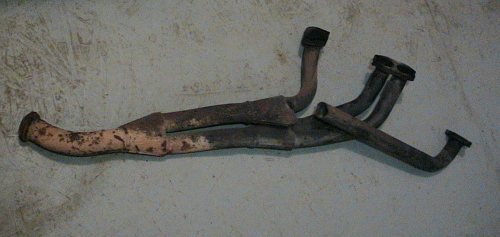

First snag. I removed the header to take it to HPC for coating, and this is how it came out.

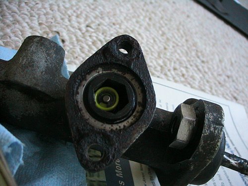

Still lots to do before this thing is driveable again, as the car had been sitting for 15+ years: brakes, shocks, rebuild clutch master & slave cylinders, sort some electrical issues, probably will need to replace the valve springs, ...

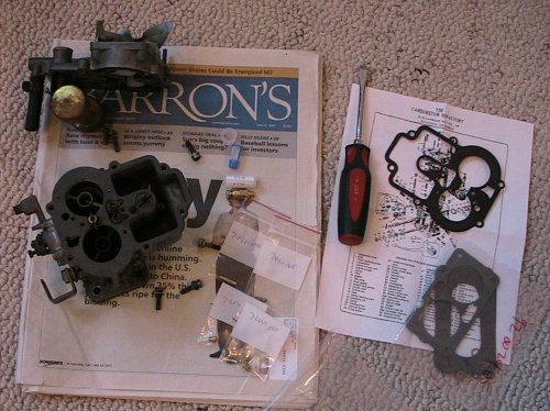

Rebuilding & re-jetting carburetor for high altitude operation. I'm going one step leaner (e.g. 55->50) on each of the idle & main jets to start. It sure is a lot easier just having to change 2 pairs of jets instead of 8...

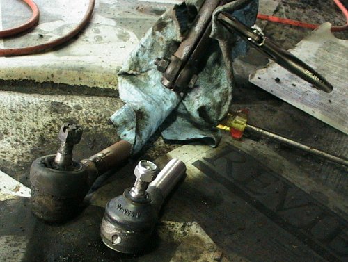

Driver's side outer track rod end was shot. Old one on left, replacement on right. I did the passenger side too, even though it appears to be OK.

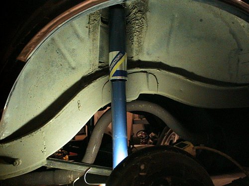

NOS Armstrong rear shocks. These don't seem as stiff as the Monroes that were in there, but they're too cool not to use for now. May go to adjustable (Spax) at some point down the line...

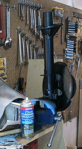

Left front suspension leg with a fresh coat of paint and ready for new Koni insert (OK, so why did I say Spax for the rear? Haven't found any Konis for the MkII...)
There was some surface rust inside the tube, so I ran a brake hone down there to clean it up, then sprayed the inside with rust preventer which will hopefully be good for a few years. Also put anti-sieze on the strut insert threads, probably causing a chemical reaction with the rust preventer that will cause the insert to sieze up permanently inside the tube /ubbthreads/images/graemlins/tongue.gif

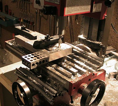

Work in progress: got some magnesium from lowcostmetals.com & am making a battery hold down. Why magnesium? Just for the /ubbthreads/images/graemlins/cool.giffactor. /ubbthreads/images/graemlins/smile.gif

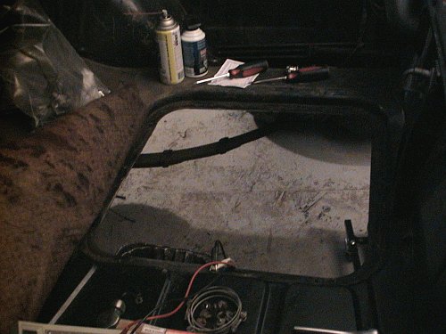

Drained & removed gas tank. Tank not shown, but it's kind of rusty inside - will need to be cleaned & sealed if it is to be reused.

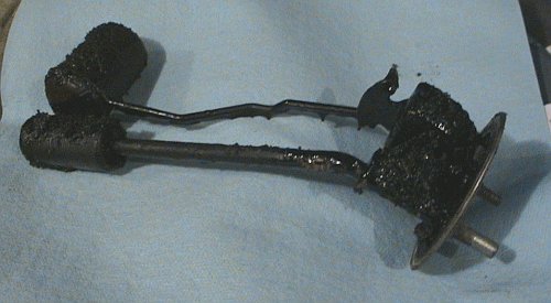

However, that opening is just about the perfect size for a 12 gallon fuel cell, and the sender is pretty gunked up. So gunked up, in fact, that the solvents I've tried on it won't degunk it.
Sender/fuel pickup:
