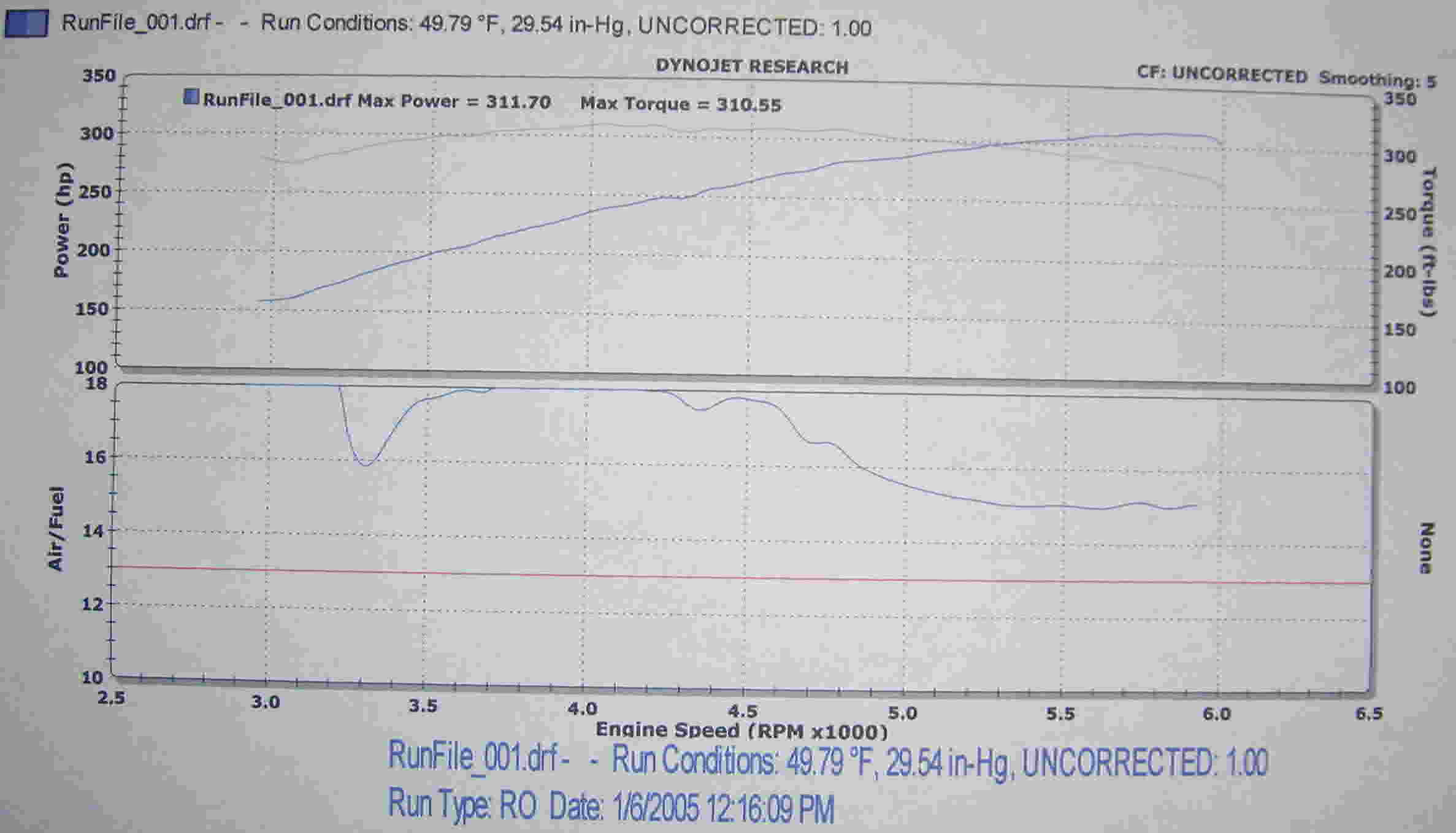

Run 1 – Car warm from drive over-too lean
HP-311.70 TQ-310.55

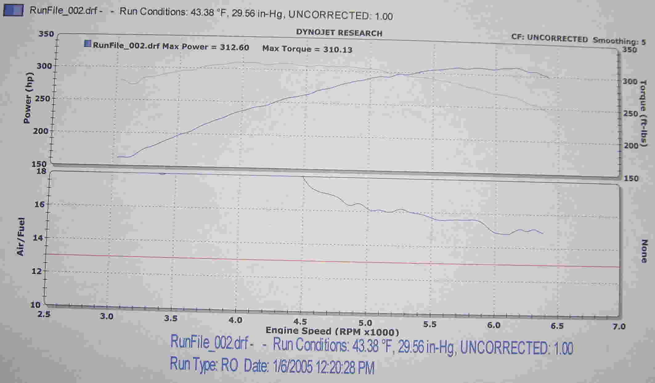

Run 2 – Car hot – Fresh fuel in secondary bowls-too lean
HP-312.60 TQ-310.13

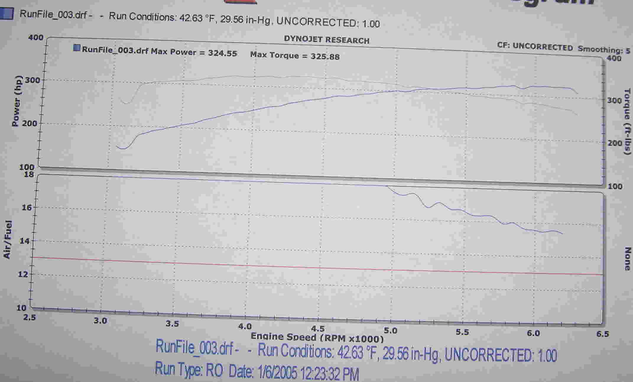

Run 3 – Car hot – Manually opened vacuum secondaries-Too lean
HP-324.55 TQ-325.88

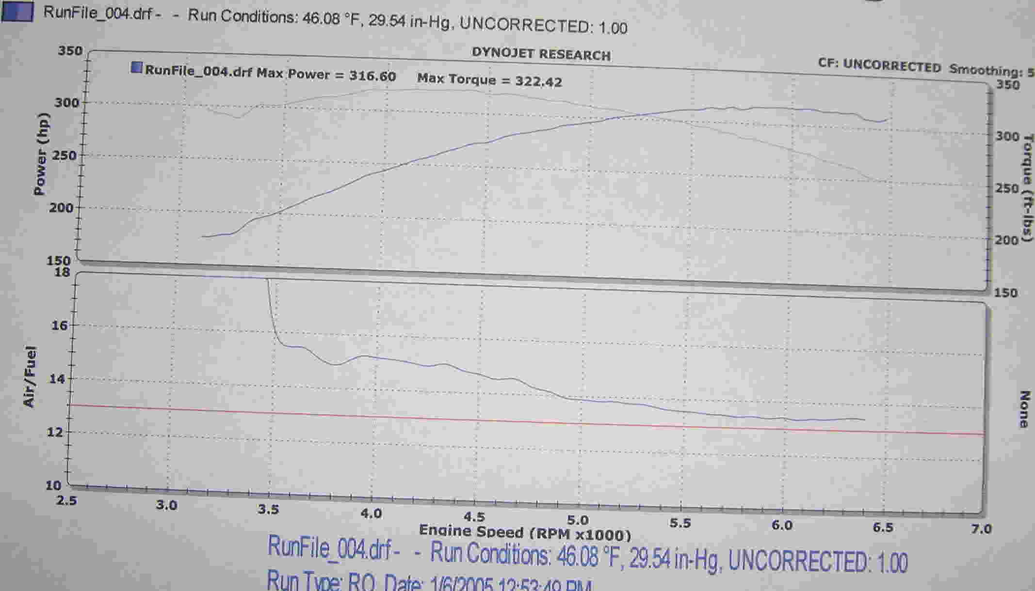

Run 4 – Re-jetted and air filter off – Car warm-richer
HP-316.60 TQ-322.42

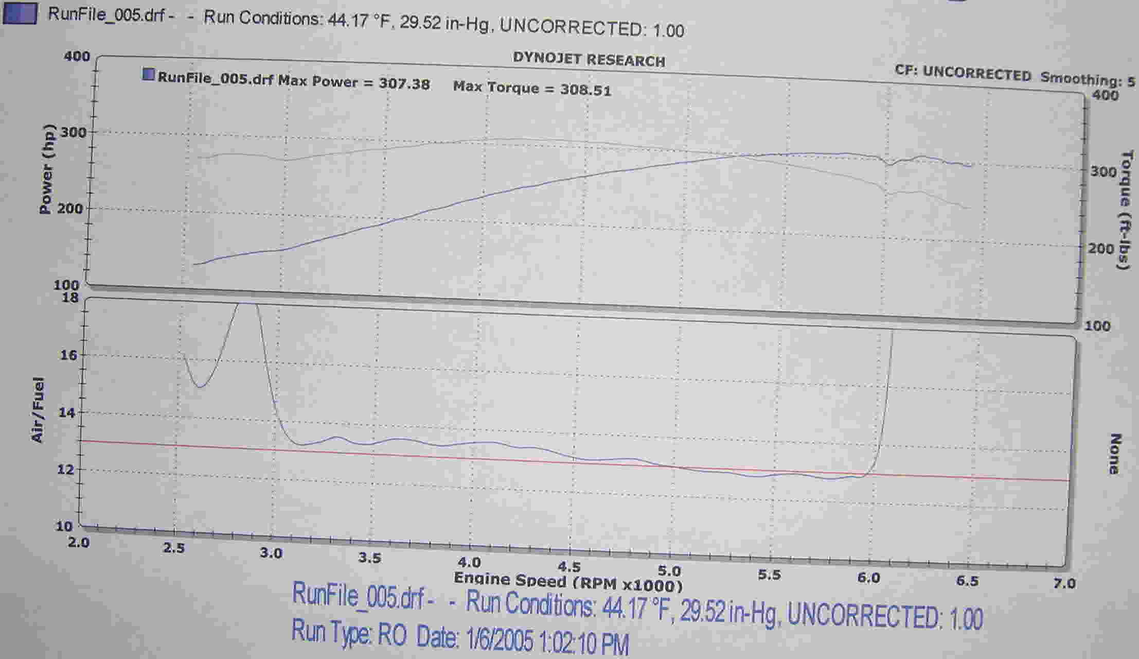

Run 5 – Re-jetted and air filter on (K&N with filter top – Car hot-Fuel just right
HP-307.38 TQ-308.51

Ok,
Here are the individual run sheets!
Run-5
Tom,
I noted with interest on the last run the significant drop off at the top end of the rev range where it looks as thought someone stepped off the gas. It is very similar to what mine did with the 8 bbl injection - Ref 347 dyno Results thread.
