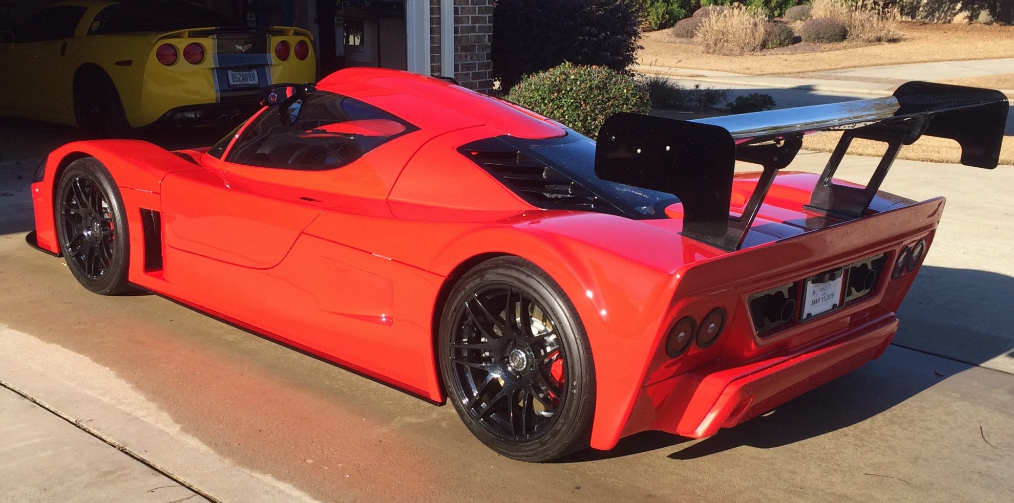

Sorry, but I simply have to share here.....RED is awesome. Check it out!

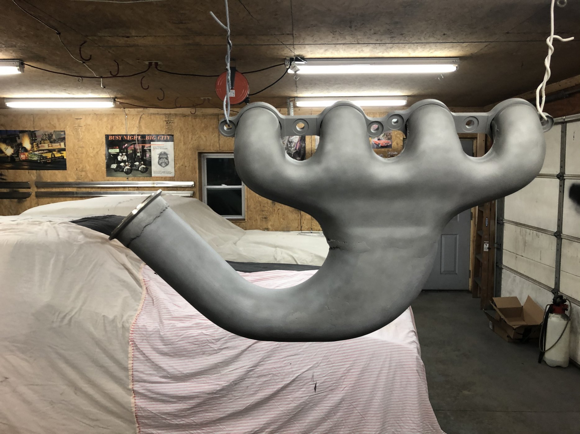

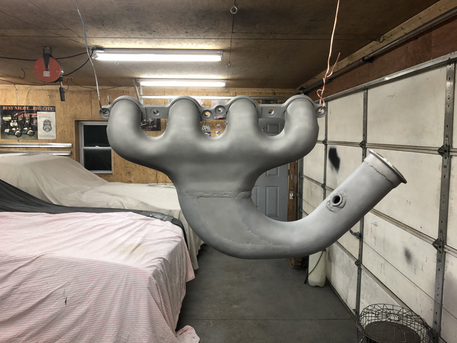

Headers are ready to be Cerakoted.

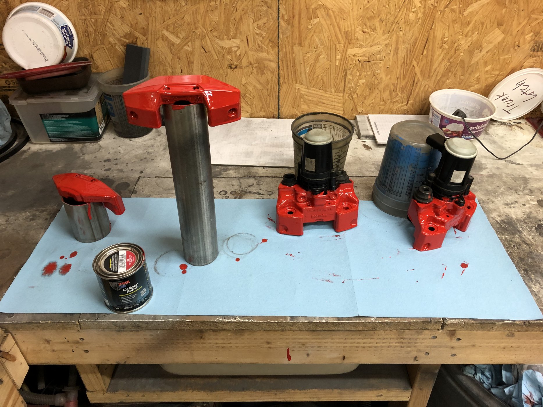

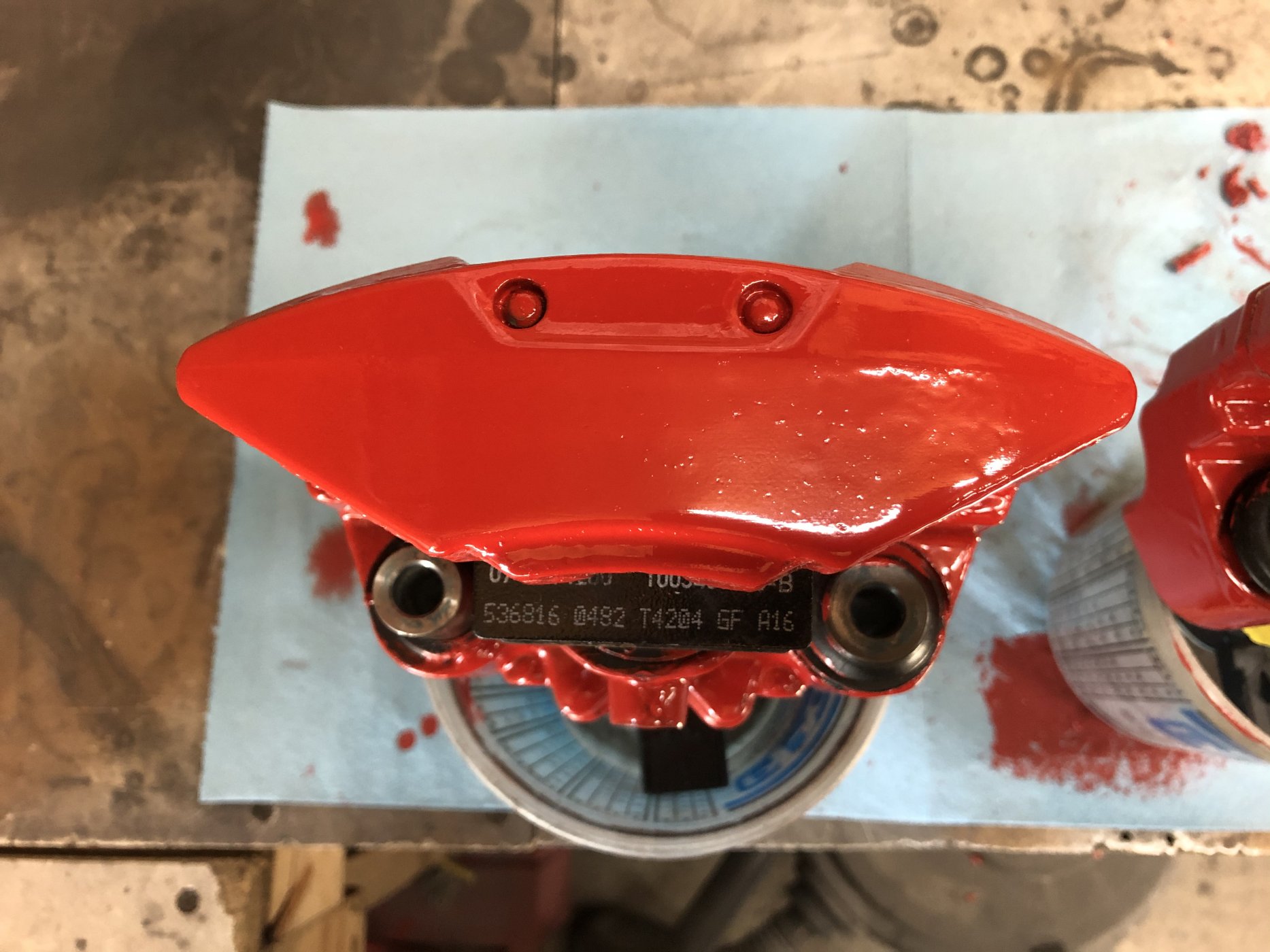

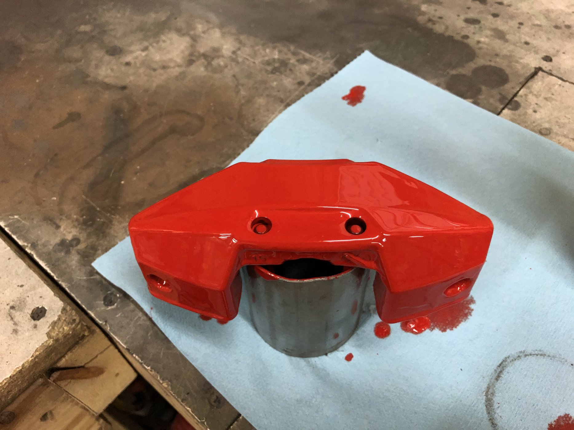

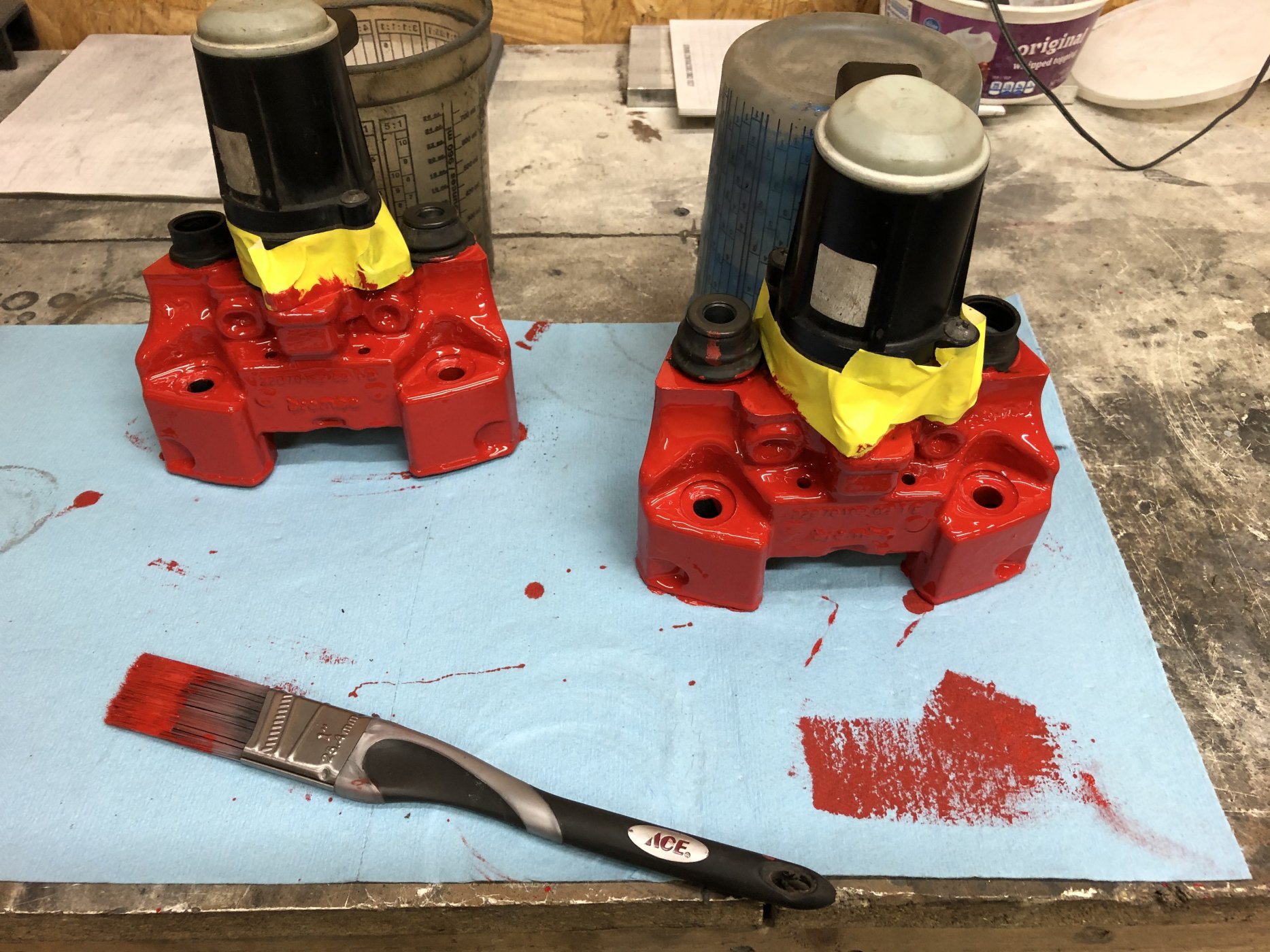

I painted my Tesla EPB calipers red using POR15 caliper paint. I have used this on other projects with good success. I plan to apply a Brembo logo to them this weekend followed by a coat of VHT caliper clear coat.

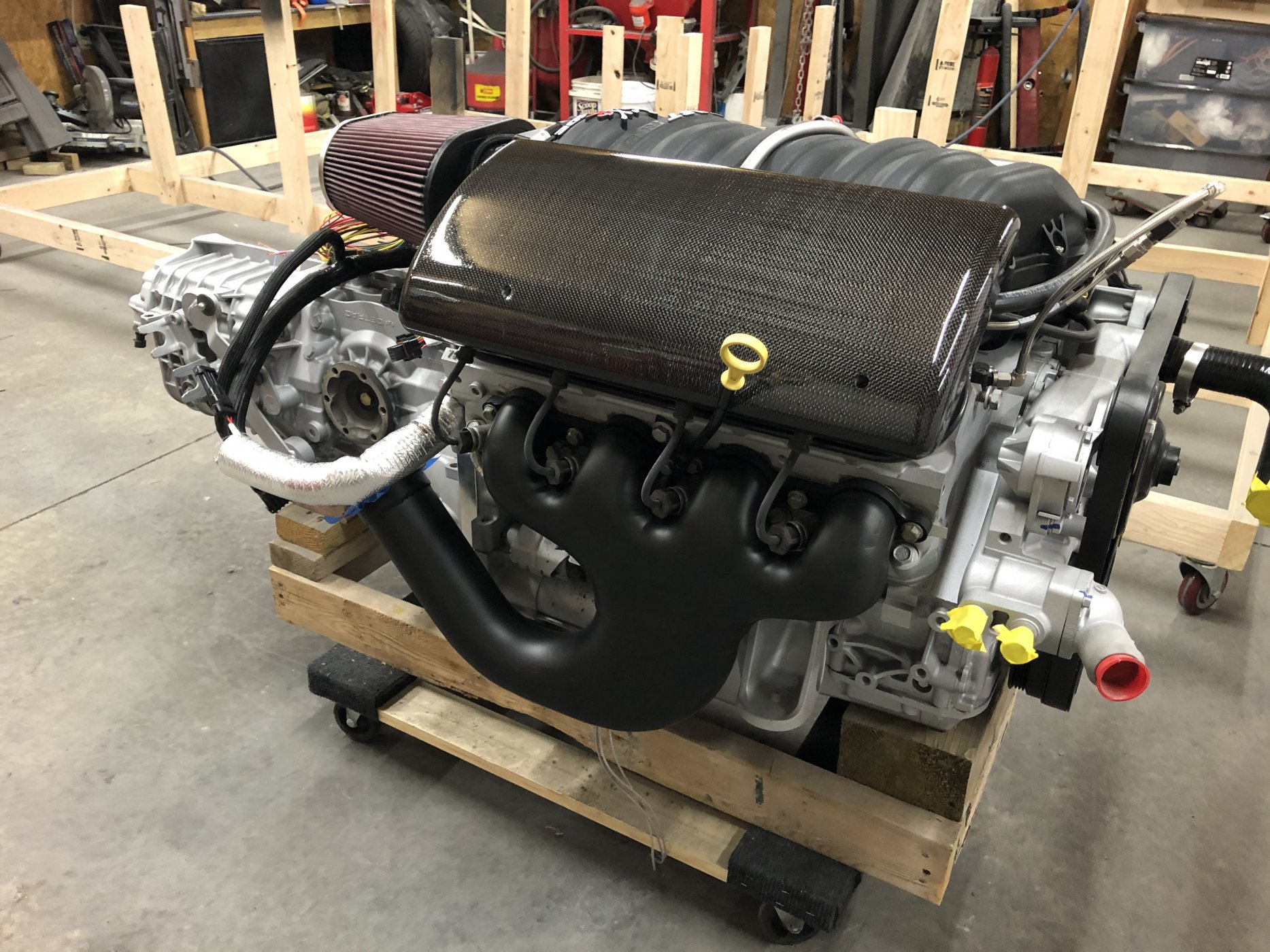

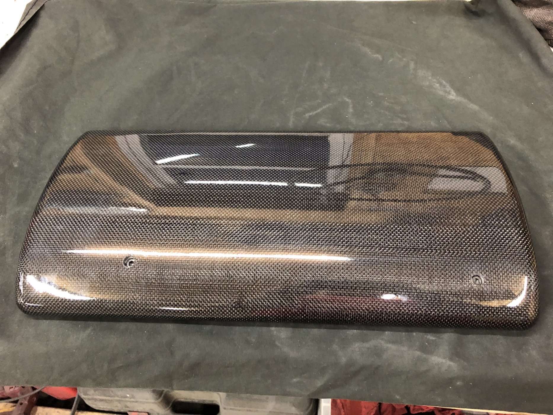

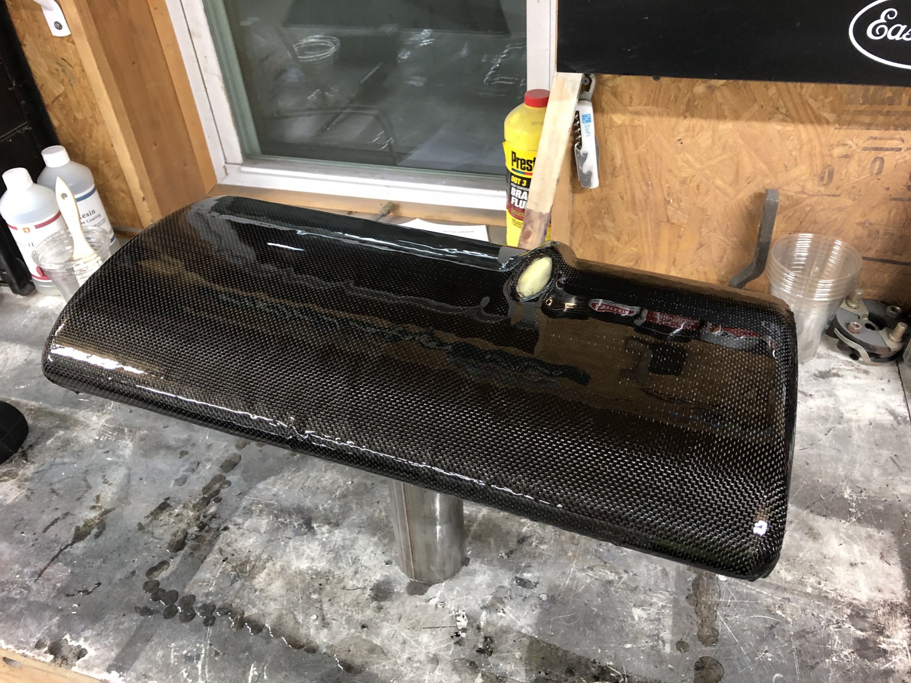

I have three coats of epoxy laid down on the carbon fiber cloth over the 3D printed coil covers. I will sand and clear coat them this weekend. I will follow that up by applying DEI Reflecta-Cool insulation to the bottom side to alleviate any question of the 3D printed ABS40plus material not holding up to the heat.
I now have a first hand appreciation for SoCal Cam's skills with carbon fiber skinning!

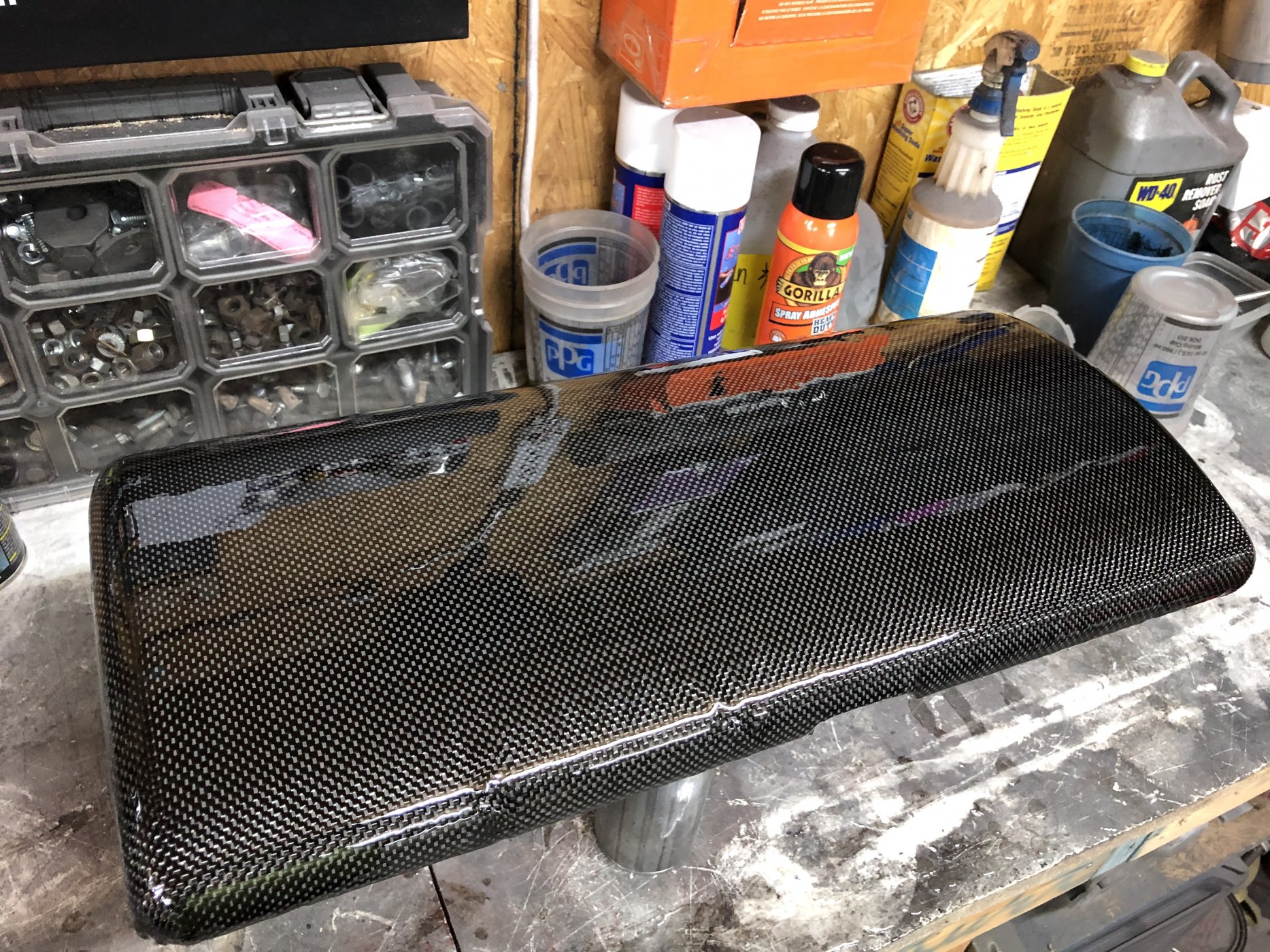

Skinned in carbon fiber, sanded, and clear coated.

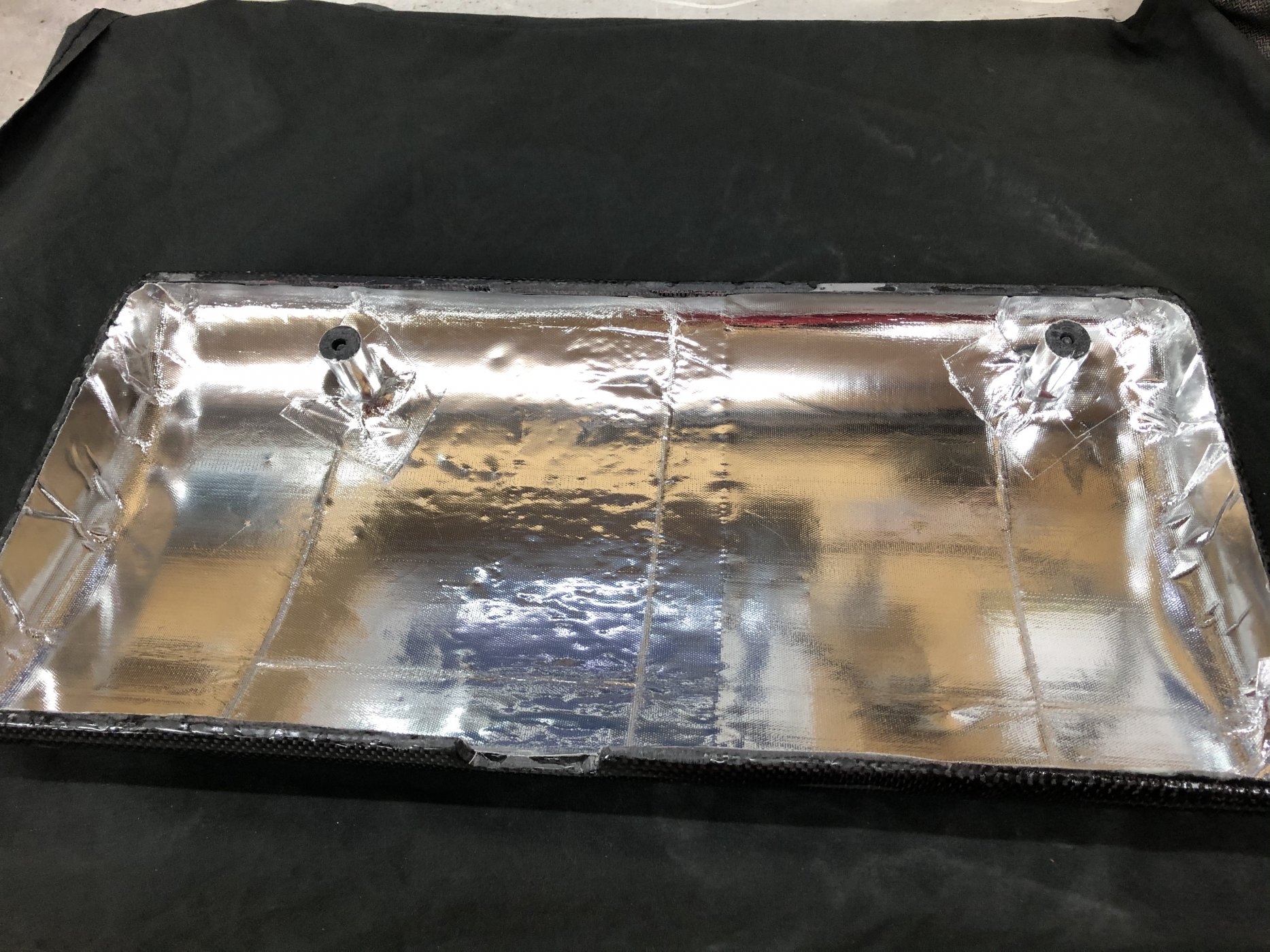

I covered the underside of the coil covers in DEI Reflecta Kool to keep the heat away from the 3D printed core and the epoxy on top of the carbon fiber fabric. They are clear coated with high temp engine paint clear coat.
This side turned out pretty good, the drivers side has some spots where the carbon fabric floated in the epoxy and gave me some issues. If it looks too noticeable once the engine is in the car I will make a second attempt at skinning that side.
You can also see the Cerakoted header in the above picture. Both sides turned out very nice. I love the look and now plan to Cerakote the entire exhaust system including my mufflers which will be visible thru the back side of the rear clam (street tail). My mufflers are single 3" inlet with dual 2 1/2" outlets. I had planned to run chrome tips but love the Cerakote and the chrome tips would be the only chrome on the entire car. I do not think I would like that look so the plans change again.

No more Tesla logo. Since this picture I have added Brembo logos and clear coated over them. (not sure why I did not take a pic of that and I am too tired to walk all the way out to my workshop now)

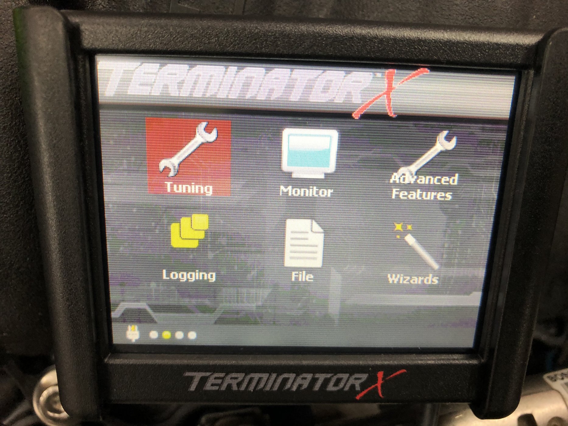

Wired up the Holley system and connected everything to a battery to test the Holley CPU, my wiring, and all the sensors. Everything checks out and the engine is ready to be fired up!! Just need to finish setting up my base tune in the software.
Test lights on the CPU do not show well in the pic but they are all the correct color!!

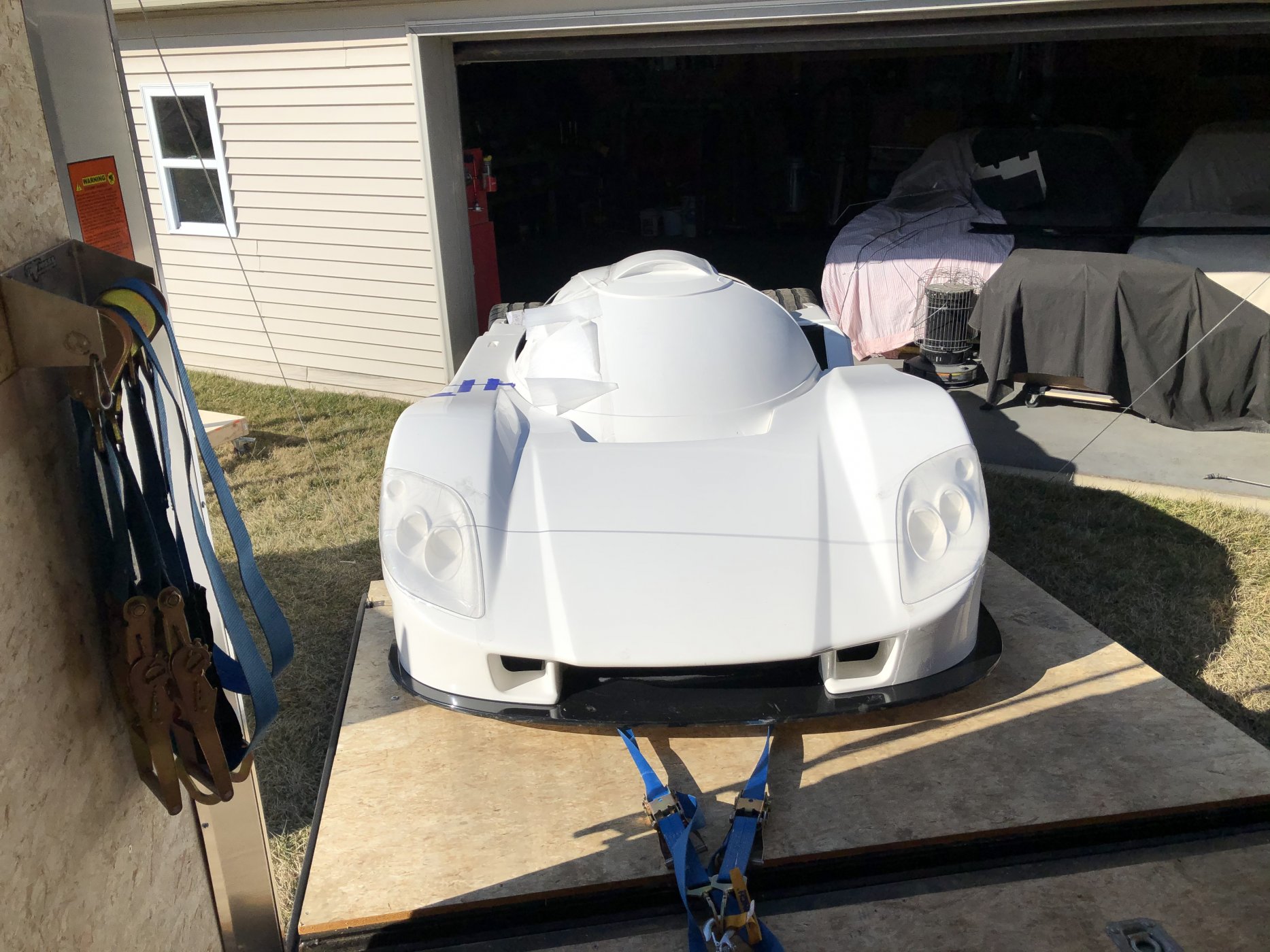

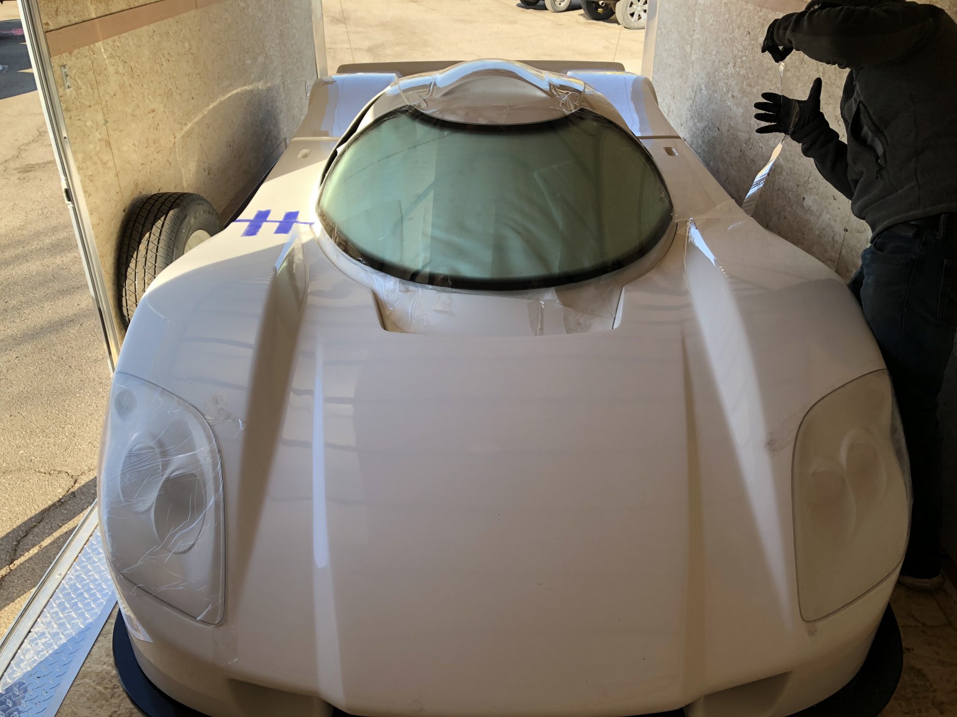

A big thank you to Fran, Bill, and all the guys at RCR today for their hospitality and assistance in loading up my SL-C today. There are a number of SL-C customer builds in process in the shop and Bill showed me a lot of good ideas for my build. Pictures as promised:
Hooked up and ready to go.
She was ready and waiting for me as I walked out into the shop.

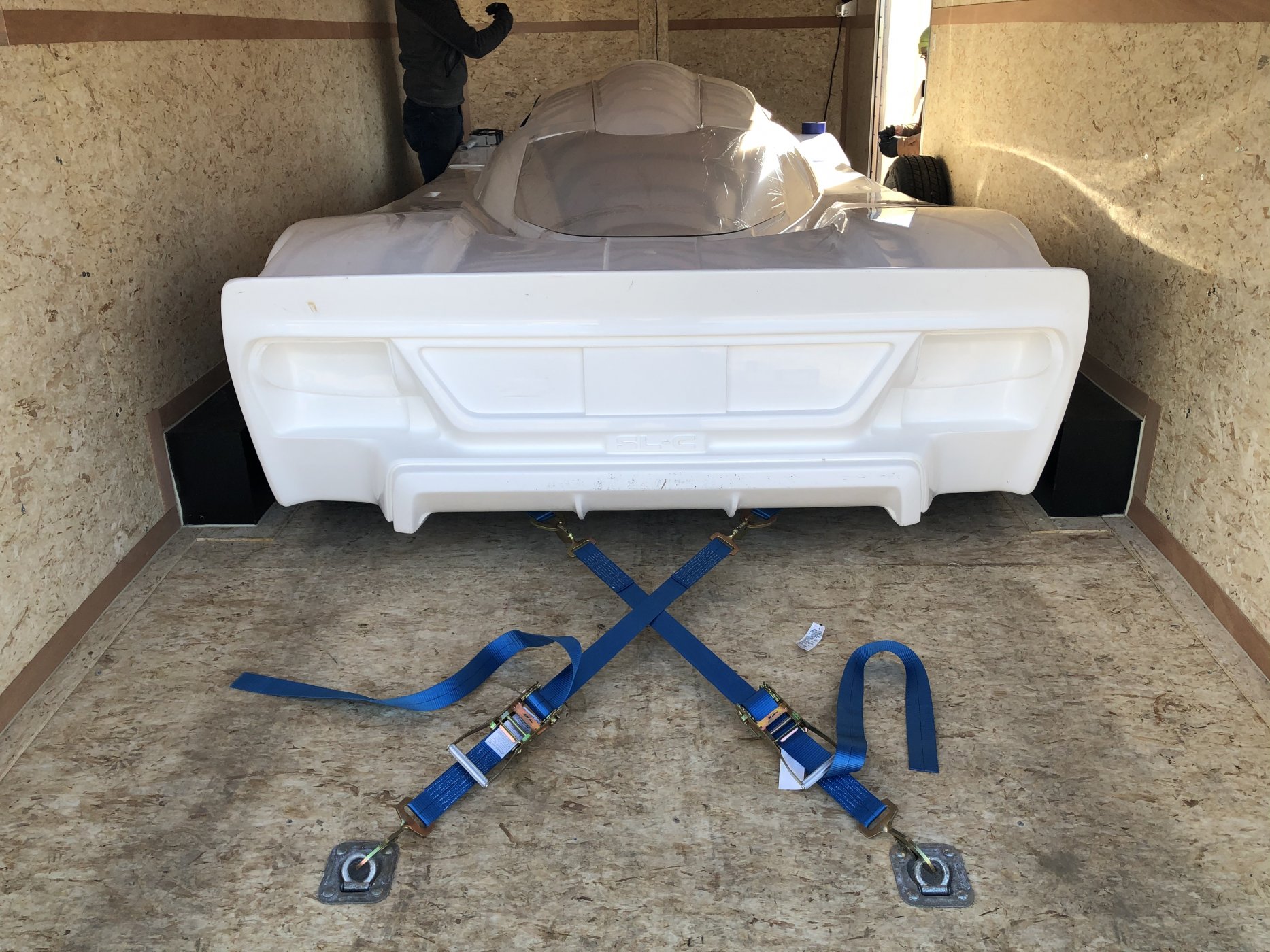

The guys in the shop wasted not time loading her up into my trailer.

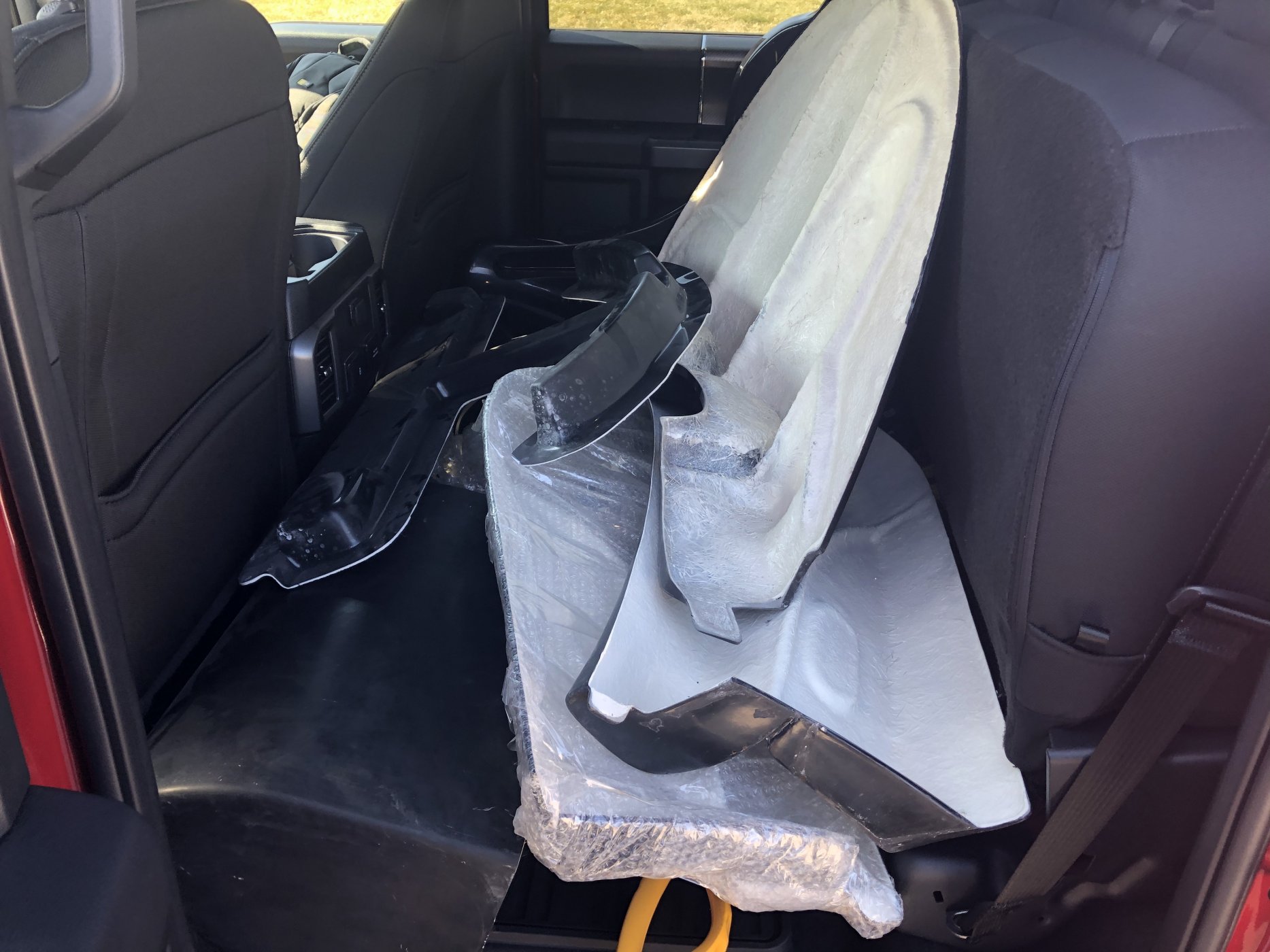

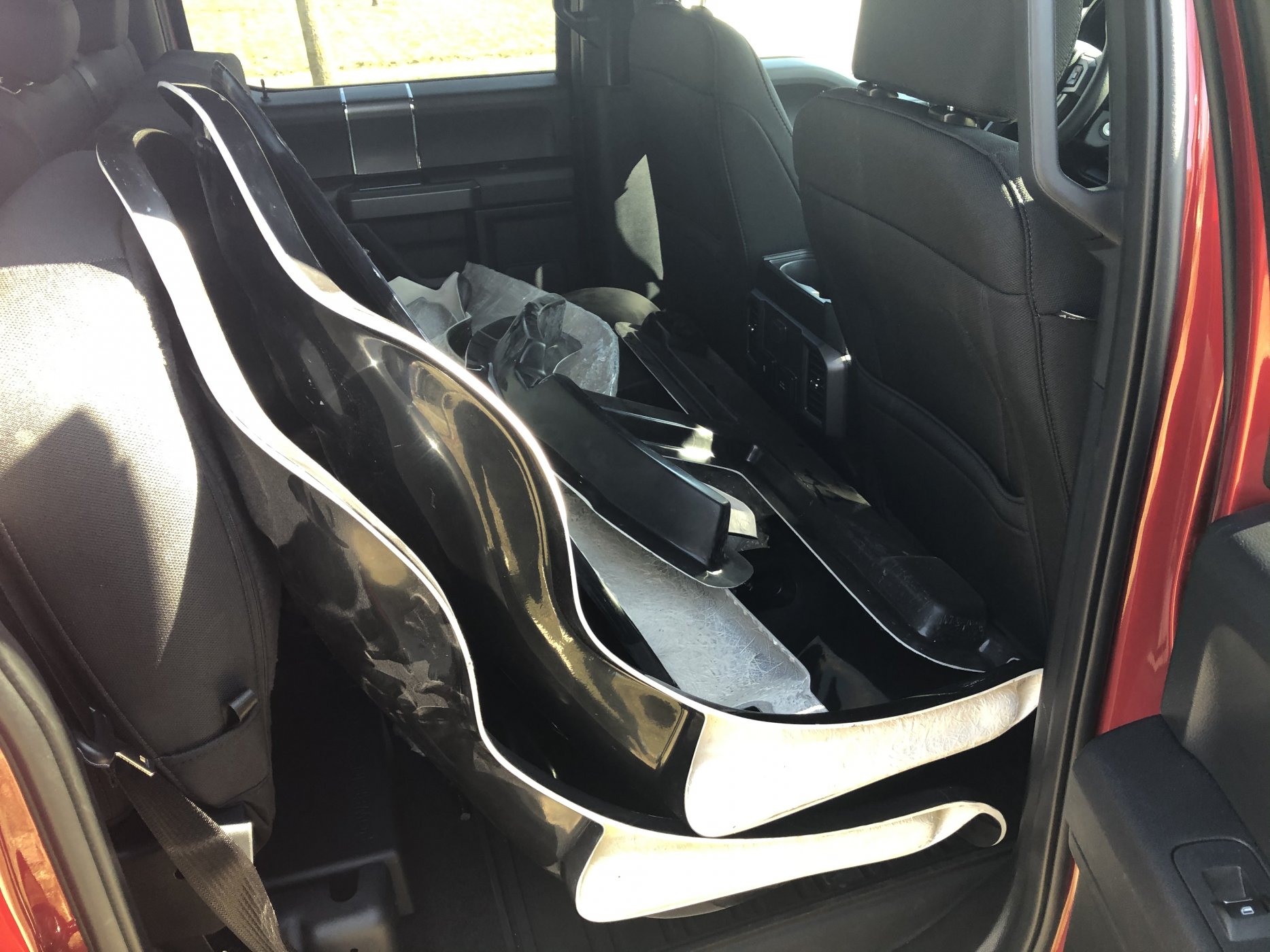

Then we packed my truck full of parts. The bed was filled with boxes.

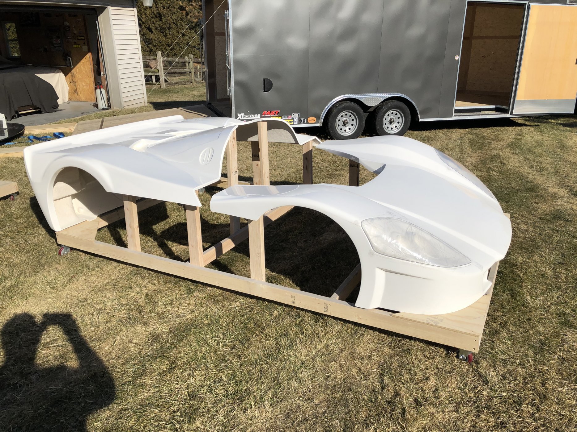

My pre-made bucks worked perfectly. The clams are in my trailer for storage along with most of the loose fiberglass parts since the GTO and Camaro are currently being stored for the winter in my shop.

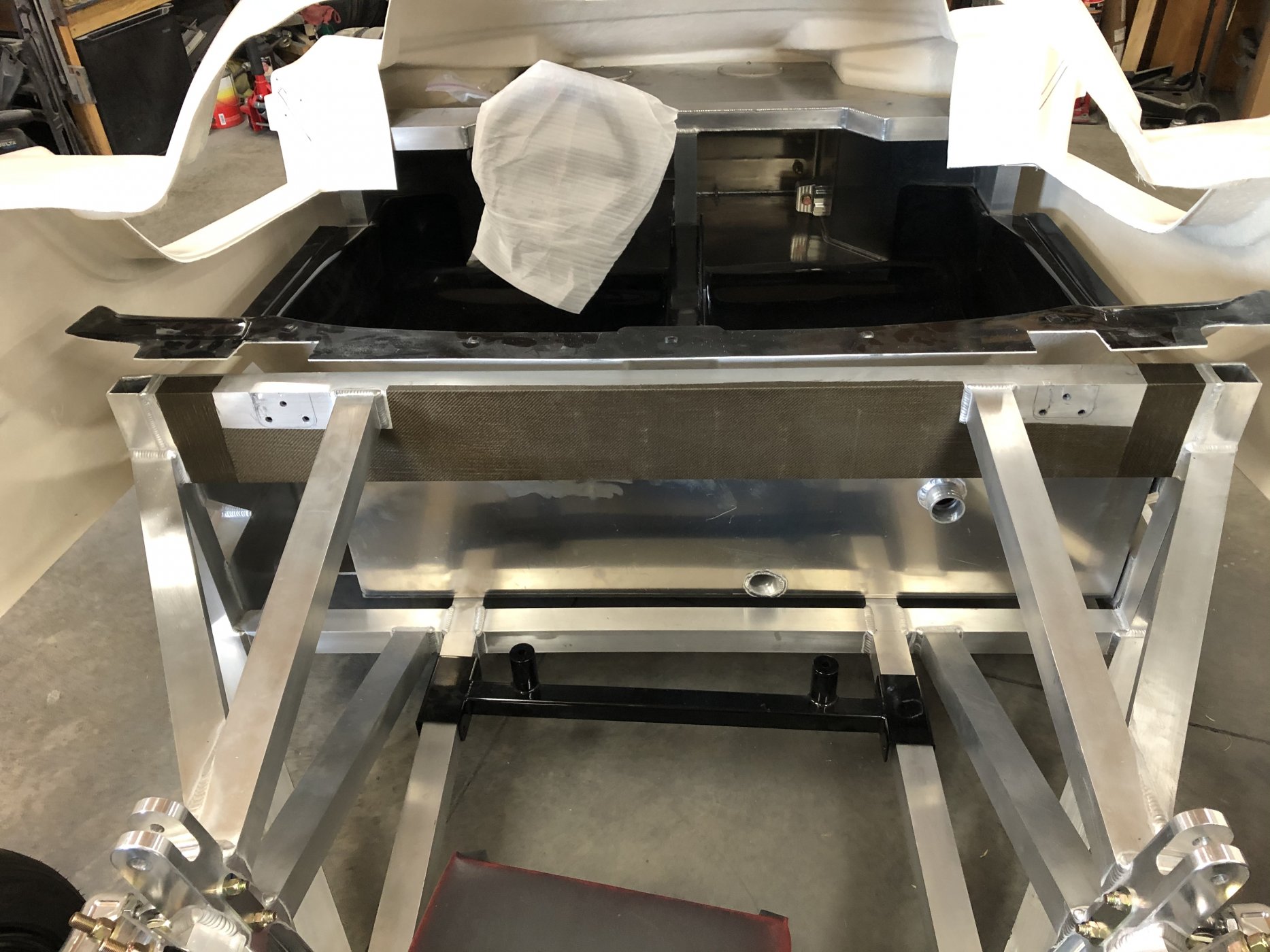

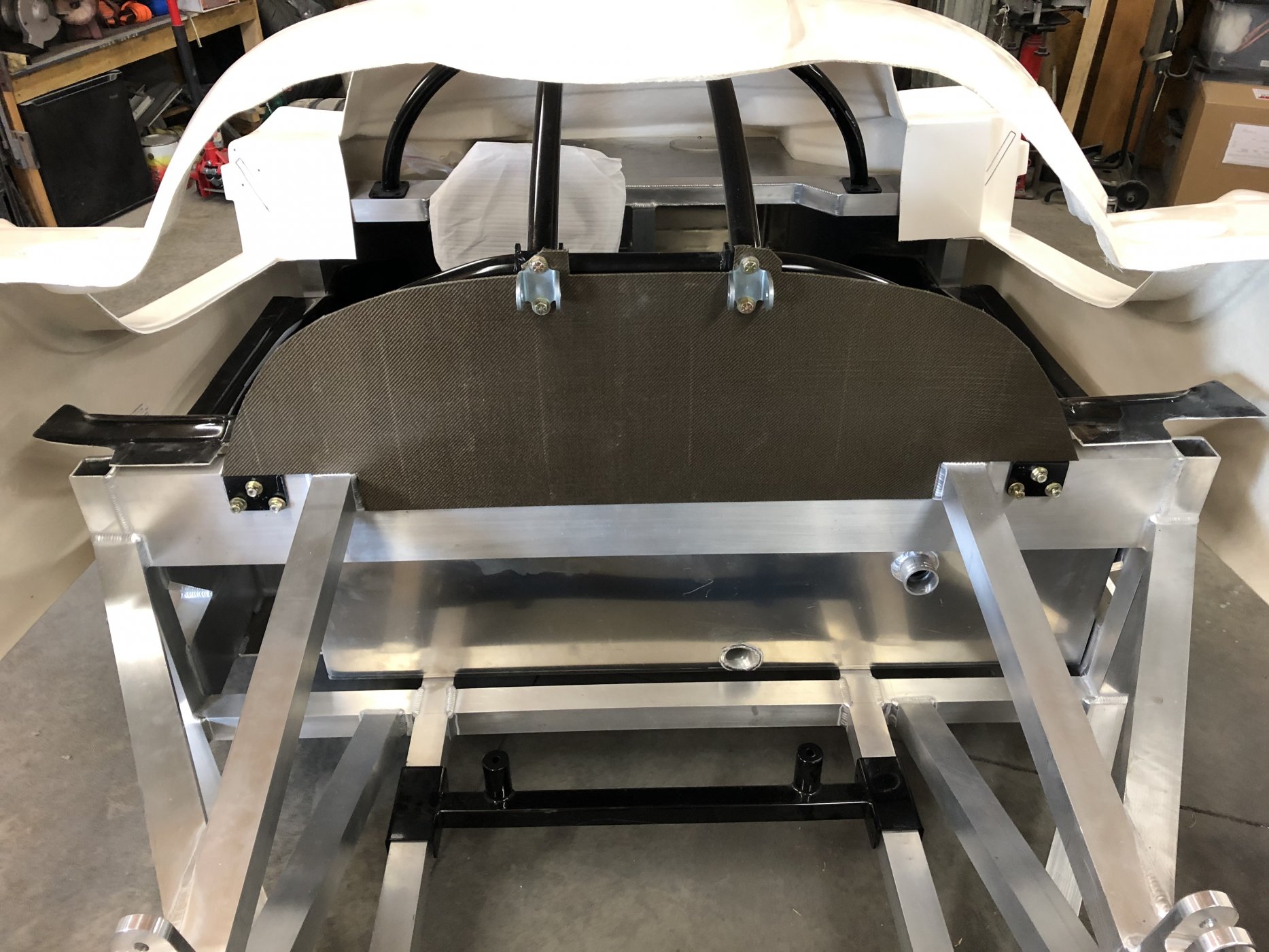

Applied DEI lava mat to the firewall and frame structure.

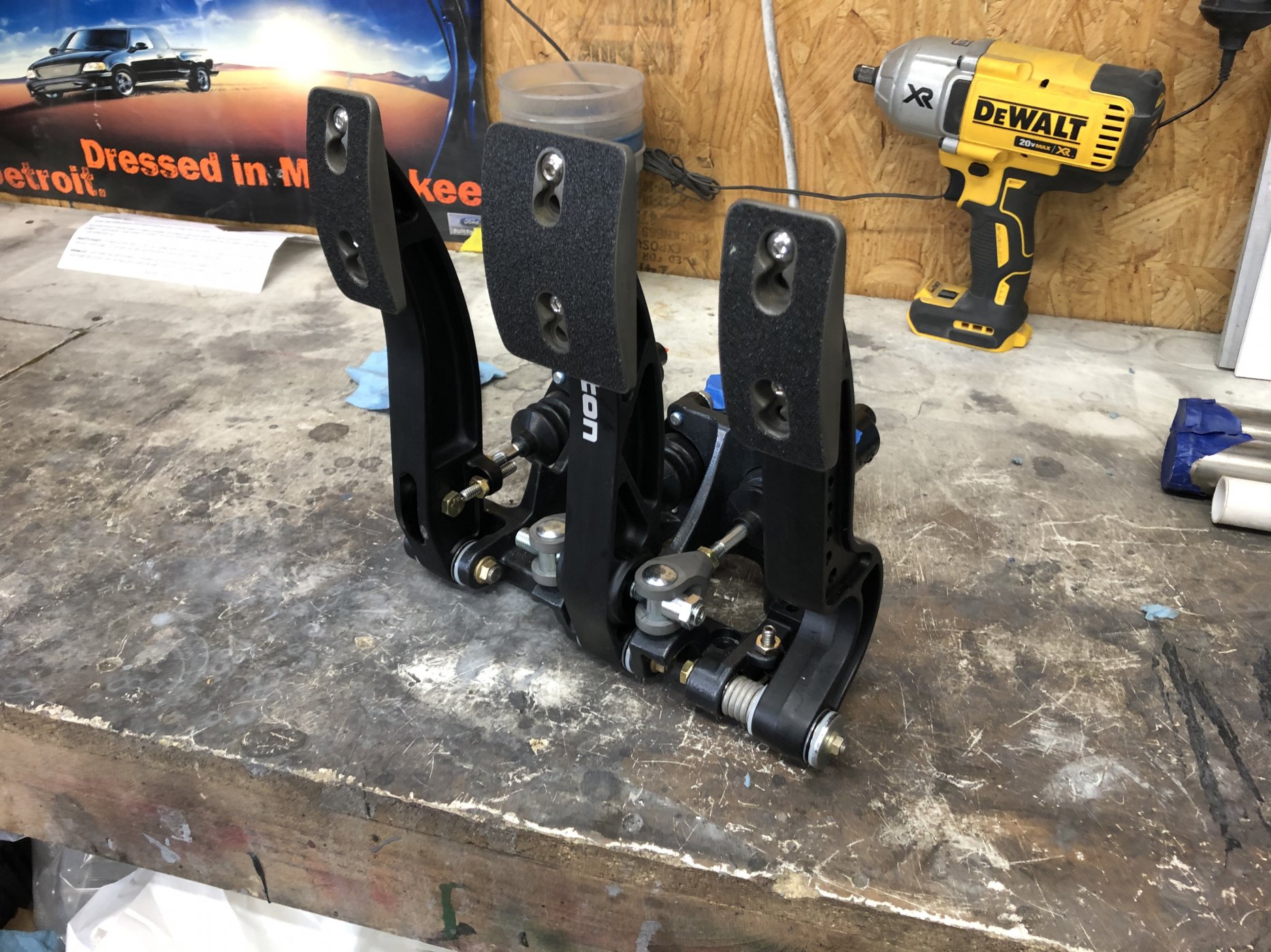

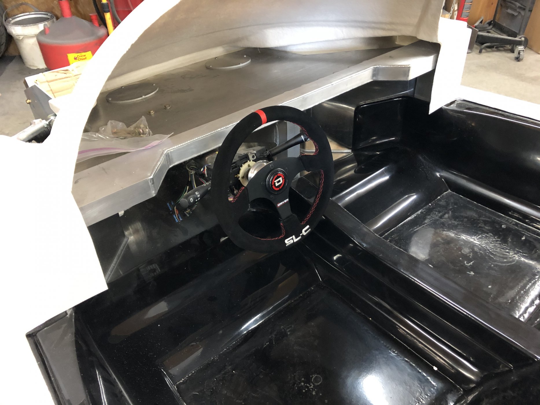

Assembled the pedals and steering wheel. It seems most change out the stock wheel for a custom one, I like the fact that the stock wheel says SL-C on it so I will use it for now at least.

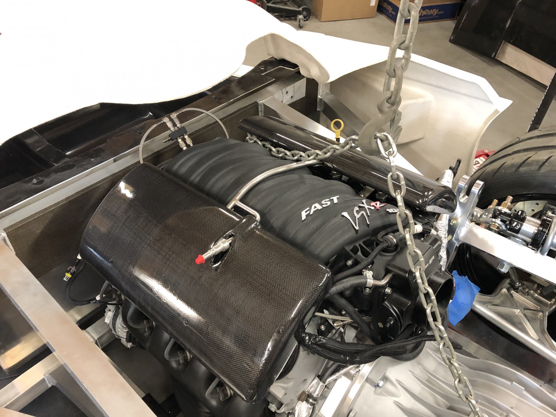

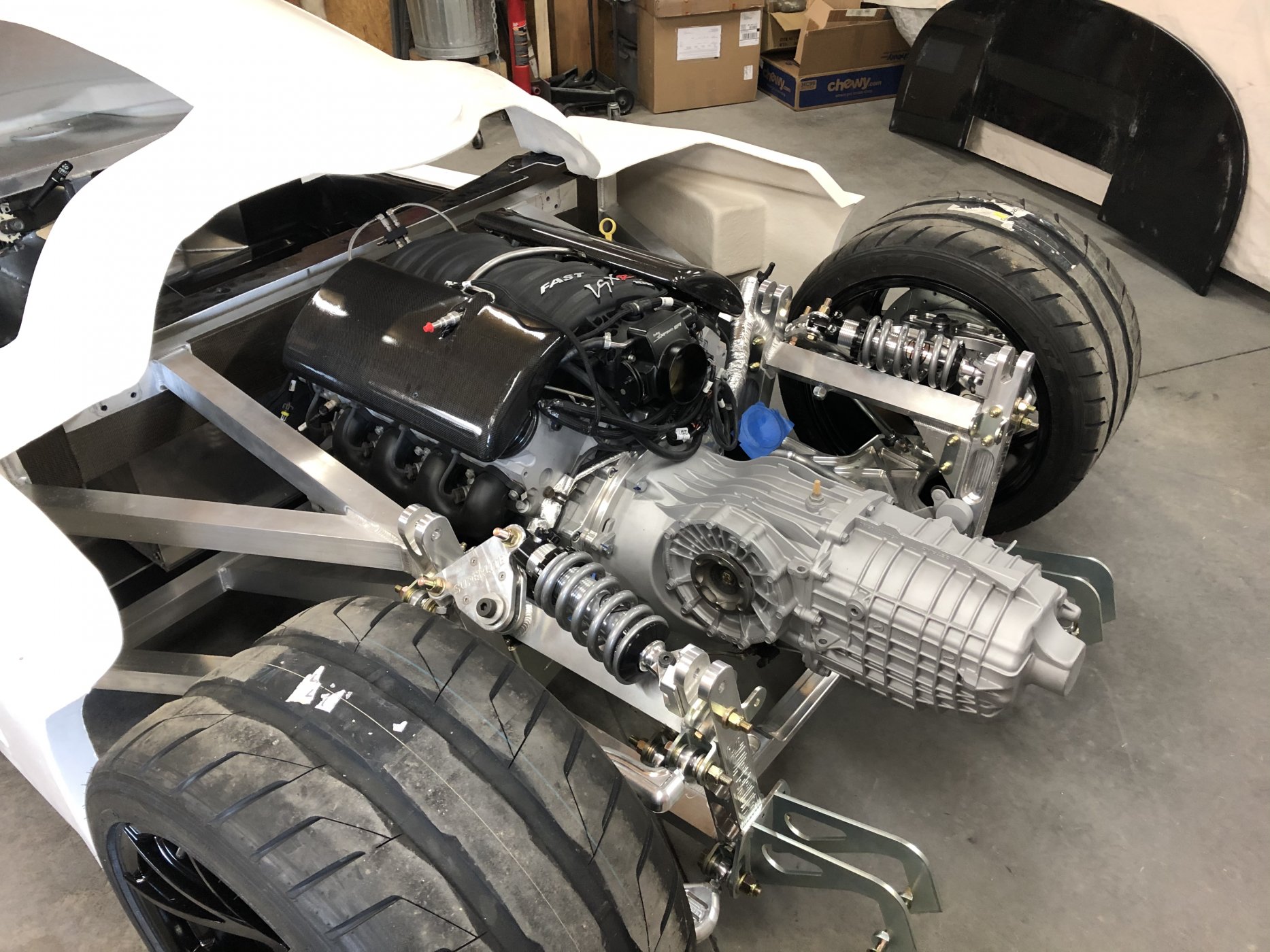

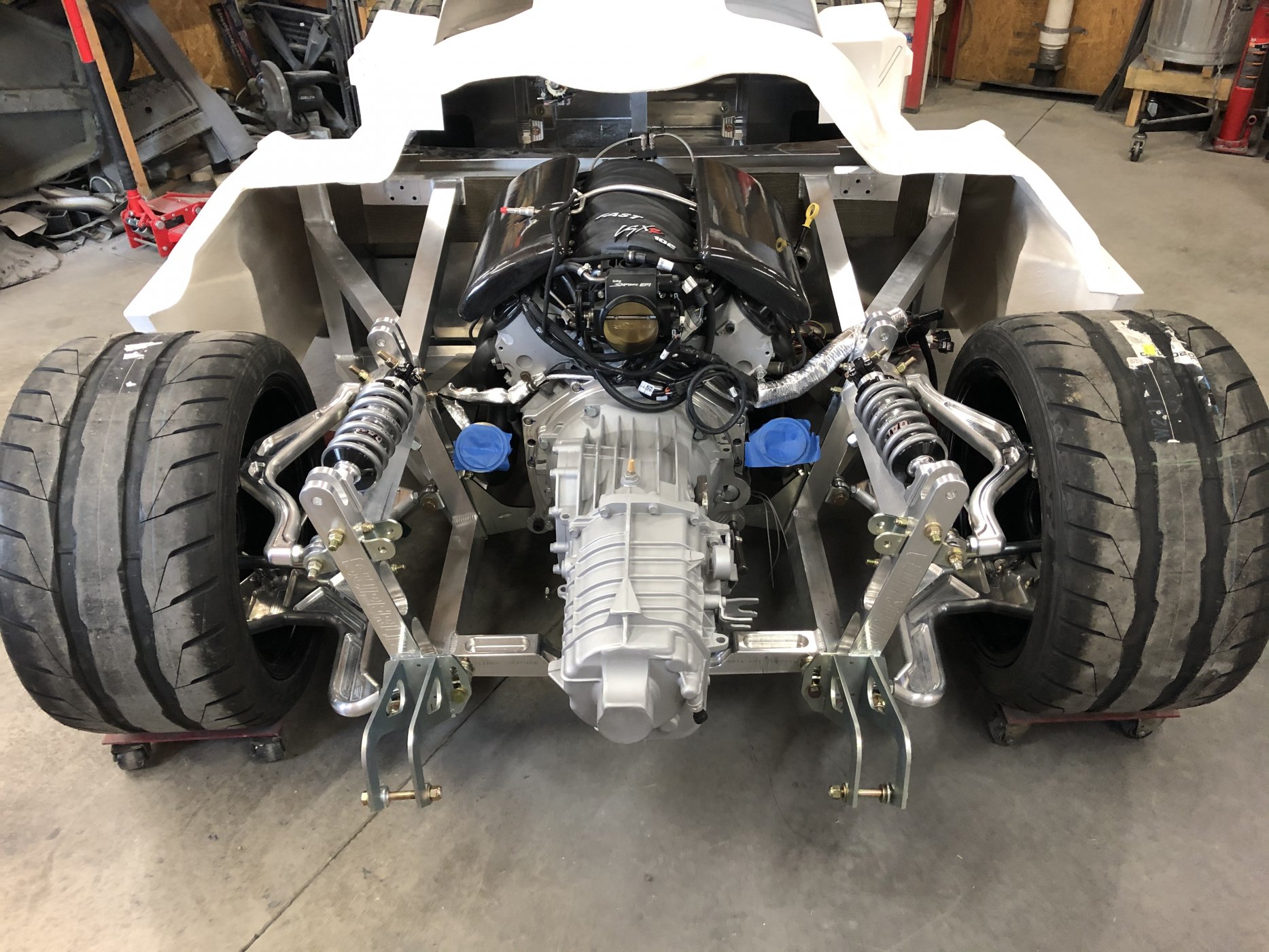

And for a major feeling of accomplishment this weekend I dropped in the motor!!
Today was the first trip of what I am certain will be many more to the hardware store for grade 8 fasteners to bolt the engine in. It is just resting on the mounts for now. It seems that the LS7 mounts sit a little higher on my LH6 block as the engine is not level in the chassis. It is sitting 2 degrees low in the front. This leaves me with less clearance at the top of the motor for my coolant tubes. A couple of 1/2" spacers on the front motor mount uprights will take care of that. Trigs out that 1/2" will bring it right to 0 degrees.
Everything fits easily in the engine bay. I was worried since I had built up my exhaust ahead of time without my chassis in hand to verify fitment. The tubes are about 1/8 from the rear motor mount bolts on both sides. That was close! That's a mile of clearance compared to how close the headers in my 69 Camaro are to the power steering gearbox. I can get a piece of poster board between them and that's about it!
