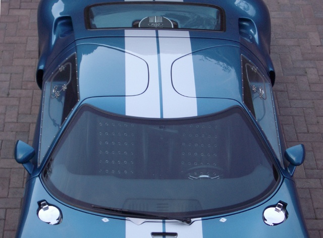

I considered most of the bullet style mirrors and then saw a picture of Wayne Presley’s old car. As it turns out, his car and many other US GT40s have used the 1984 Mazda RX7 power mirrors. Compared to the bullet style mirrors, they have a larger view surface and are raised up and out on a pedestal to “look over” the rear fenders. They are electric so they can be adjusted from inside the car. I do not have the wide Gulf rear fender flares so the mirrors may be different on Gulf cars.
I got the mirrors salvage for about $150 and had then repainted to match the body. I think I ordered them from Mazda Recyclers ( ?? ) over the phone. The RX7 mirrors attach to the side of the door. I took a little extra time to make the bottom mount of each mirror concave so that it would be a perfect contour fit to the body. Each mirror has 4 wires. The two black wires go to the coil of a relay inside the mirror. If the relay is de-energized then the + and - 12VDC on red and blue control the left/right motor. If the relay is energized then the + and - 12VDC on red and blue control the up/down motor.
