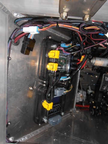

Fran, how are you bring the feeds from the back into the front, where are you going through the side of car( along cooling lines into footwell area?
I recommend that the power to the master cell in the drivers footwell run through the upper left corner as shown in the picture, isoltaed with a grommet
