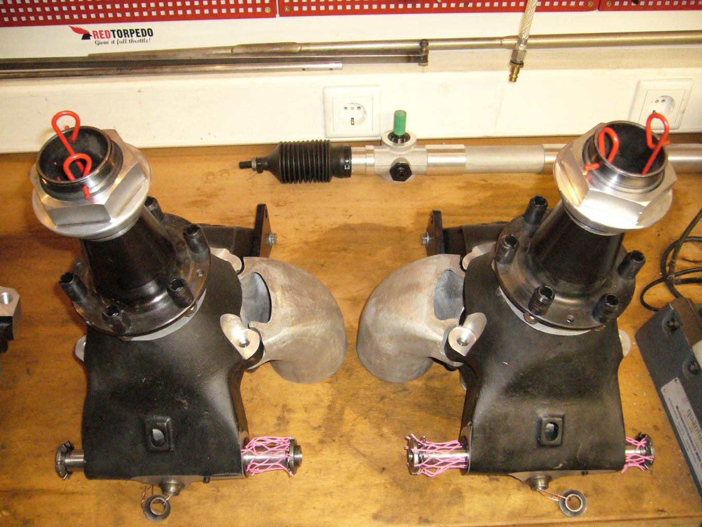

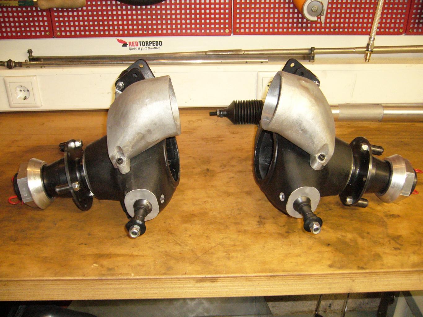

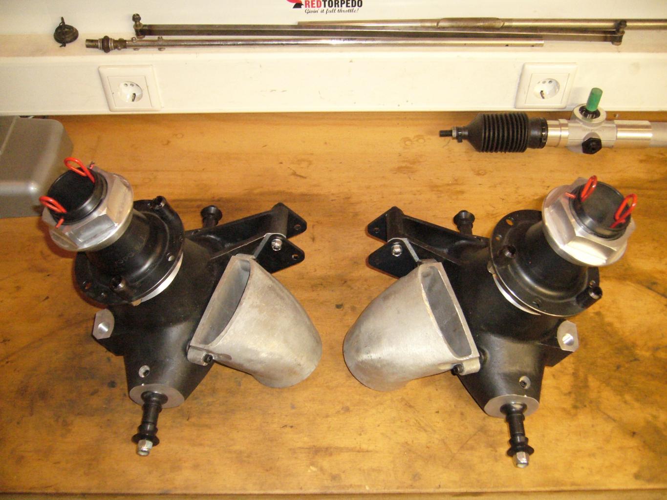

A set of fresh magnesium uprights miraculously ended up in my workshop:
Merci beaucoup, Michel.
The whole rest of the suspension (control arms, springs, dampers, anti-roll bars) will hopefully be arriving in the next 1-2 weeks...

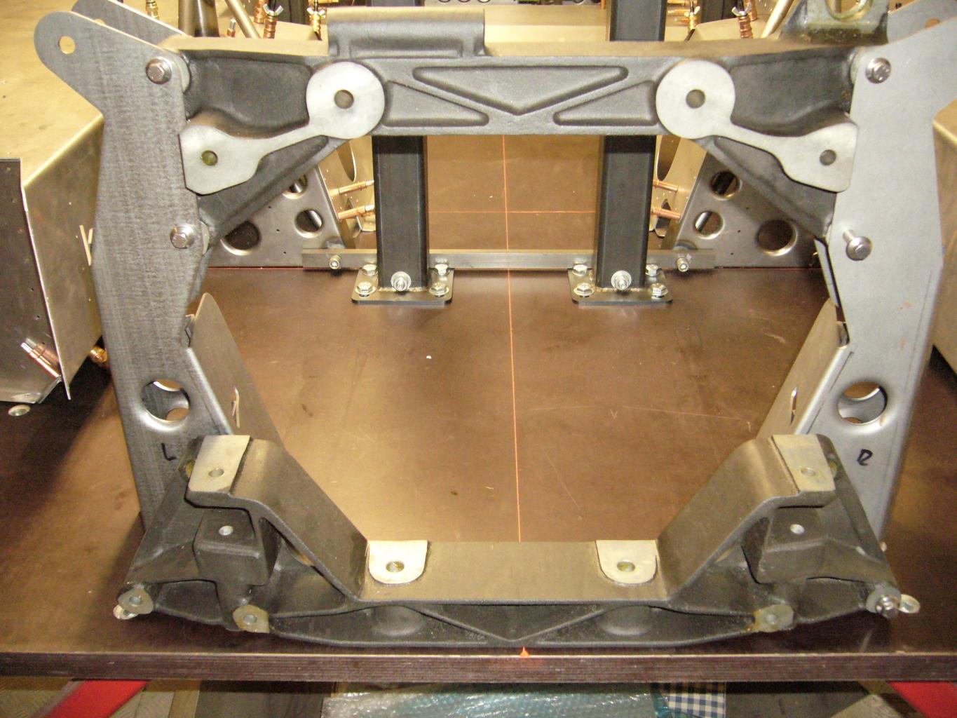

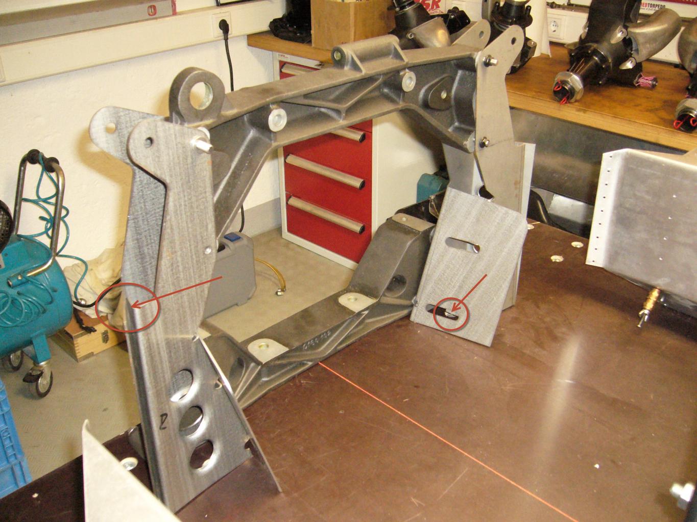

For the moment I prefer having some cups of Glühwein instead of resuming my chassis build as I´m currently stuck with the rear shock towers.
Meanwhile I´ve fabricated the 3rd pair and still can´t get them right,
see pics:
Hi Olivier,
if you look closely at the 2nd pic, you see the red markings where the bending doesn´t align well.
Best,
Marcus

Hello Marcus
Why did you have so many issues to get the right bend ??
Specially if it is your 3rd tempt ?
I was watching those red marks and can't really understand where is your problem ?
once one set is wrong you are not able to calculate how much you have to correct ?
Am I missing something ? am very interested to know what is happening ??

Ahoy Michel,
trouble is that you can´t bend these parts on a normal bending machine, because of the tight bend angle and the very limited space within that part you need a bending press which usually has no bend angle gauge. Also, I find it difficult to estimate the amount of over-bending for compensating the steel´s resilience.
Any idea is highly appreciated :idea:
Cheers,
Marcus
OK
but if you bend those just alittle more "open" than necessary and then tryfit and again bend just a fraction and tryfit etc etc ???
Eventually doing a small sort of wood bender with your bench ?
Parts seems not to be so tricky to be bent on small steps ?
it's hard to help with ideas being far from the work but doing somme angle templates it can be probably easier to catch the right angle
Edit ; watching more to your pics ... this is a work bending you must do very close to the bending machine so you can bend with many "steps" so you will understand how much you need and also in doing few by few you minimise the fact the material have some "resilience"
