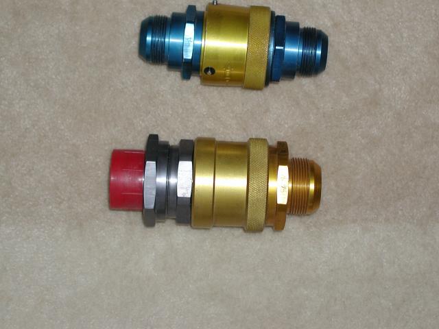

You are looking for one serious fuel line. The only things that big are water lines and then are rather large. Most are AN16 or 20. Don"t think they make an 18, though could be wrong. At any rate a 20 is what you are asking for. They also would be rather expensive by itself unless found on the used market. I have two (I believe it is a 20)but it isn't of the reusable type fittings. If you are interested in it, we could work something out. The two I have are aprox. 20 " long. I even have a weld bung for it. Here it is next to a AN8 bung.

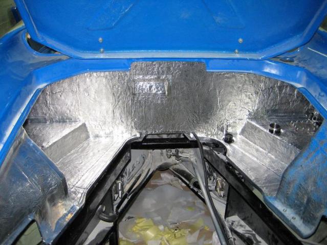

A balance line between sponsons or for his filler neck perhaps ?

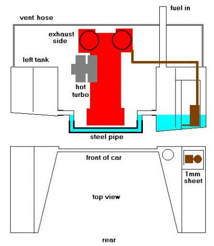

yep, bingo! balance pipe between to tanks one on the left and one on the right side of the car. I have to bypass my chassis so they don't need to hold any pressure that's why I am looking for the coolant(water) hose style but I want it to be fuel save. (maybe for te time beeing I can take the coolant hose and check it one's a year) but thanks for the reply any information is welcome

I am considering an 8AN line. I also want to incorporate a quick connect in the crossover line in case maintenance is required on say the sender.
BTW I have one of those in 20 and 24 as well!!!

Bill, I will do hardly any trackday's so a fast left or right corner will only happen on the autobahn yes yes the autobahn only 100miles away (1,5 hrs) if I am going to do a track day I must fill up properly
Jim, "rick your making life hard for yourself" yes I know I have build the chassis/suspention myself (lol) emailed samco and the told me today that ther hose is not up to this job (even the fuel resistance) verry nice people to tell the true to a customer, i like that for a change
Mike I live in holland aka the netherlands, if you think of flat multiply by two and thats where I live haha no hill's or mountens. but I have a simple swirl pot inside the tank

Now that I have my engine running, I have made a few discoveries that is food for thought for some of you. I am incorporating a crossover line from the drivers side to the passenger side. I have one set of pumps(lo and high) on the passenger side. My routing is:
Pass. side tank to filter, to low pump, to swirl pot, to Hi pump, to mico filter, to FI, to regulator, to return to swirl pot, and overflow to drivers side tank. From the drivers side I have an 8AN line from as low as I could get without drilling through the frame through a one way valve(low resistance) to the passenger tank.
What I have found out is that the crossover works, but it is too slow to get the fuel to the passenger side before it runs out of gas!! Wen I turn the engine off(when the fuel guage says empty) and let it sit for a couple of minutes, turn it back on and thefuel guage says full!! This situation leads to overfilling of the drivers side tank. It actually ran out the breather tube. The other issue I discovered is that you HAVE TO HAVE A VENT LINE IN THE REAR OF THE TANK. It doen't need to be big, but it has to be there. If the car is sitting in traffic(car attitude is nose down) or on a long declining road, the pressure will build up in the rear of the tank forcing the fuel up the filler or vent line!!
I have contemplated a solution to my delima and I think it will work. I will post the results when complete.
