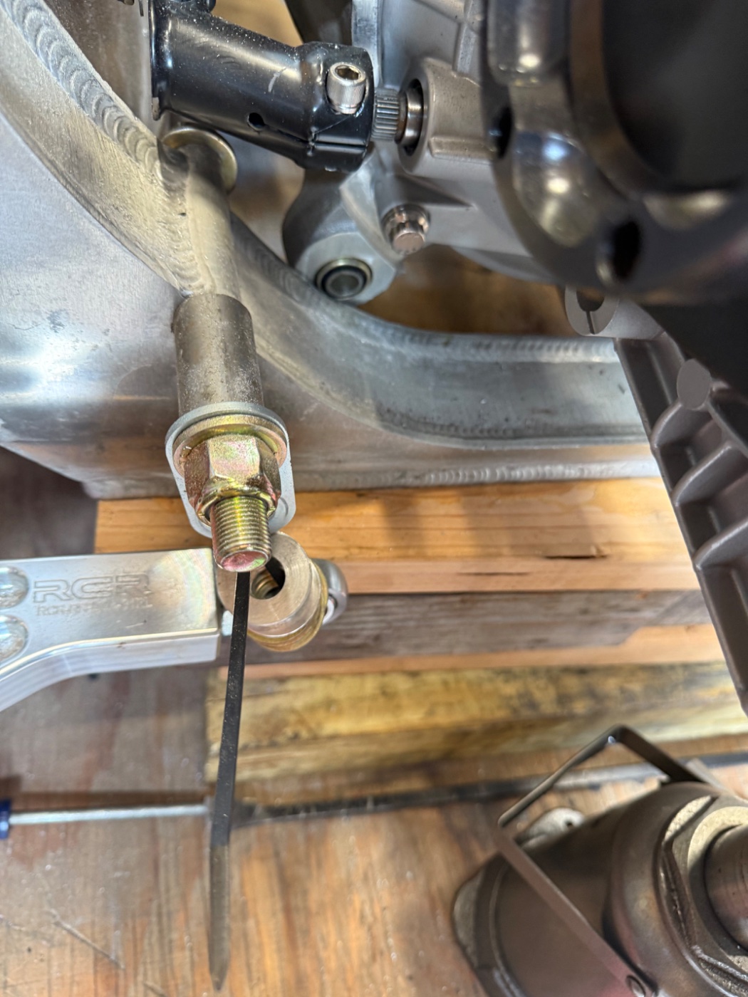

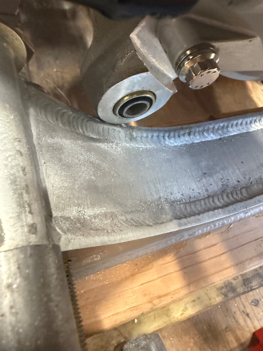

The two lower mounts are interfering just slightly with the lower crossmember on the trans/bellhousing. These mounts aren’t used (as far as I see). Do they get cut off or shaved down? Just the DS is slightly hitting and stopping me from lowering the trans the extra .5-1” that I need.

Yes it’s a Safir bell housing. I don’t think I even saw any where in the lower crossmember where they could bolt to??? I’ll have to look again this afternoon when I get home but I didn’t see anything on the RCR where it could bolt to.

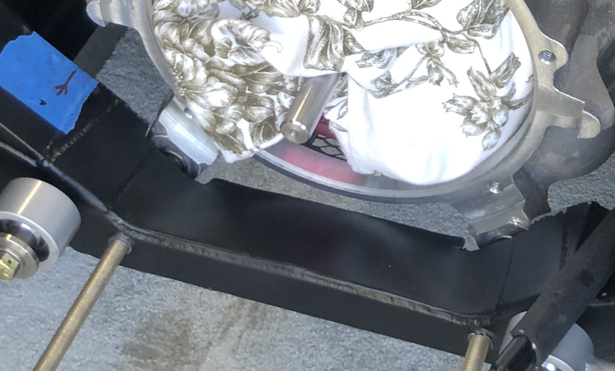

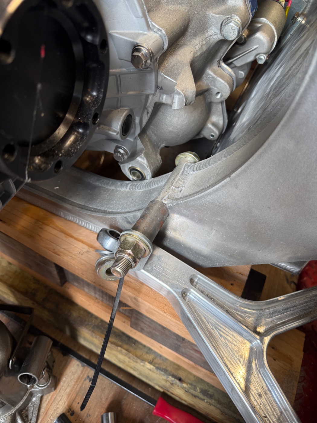

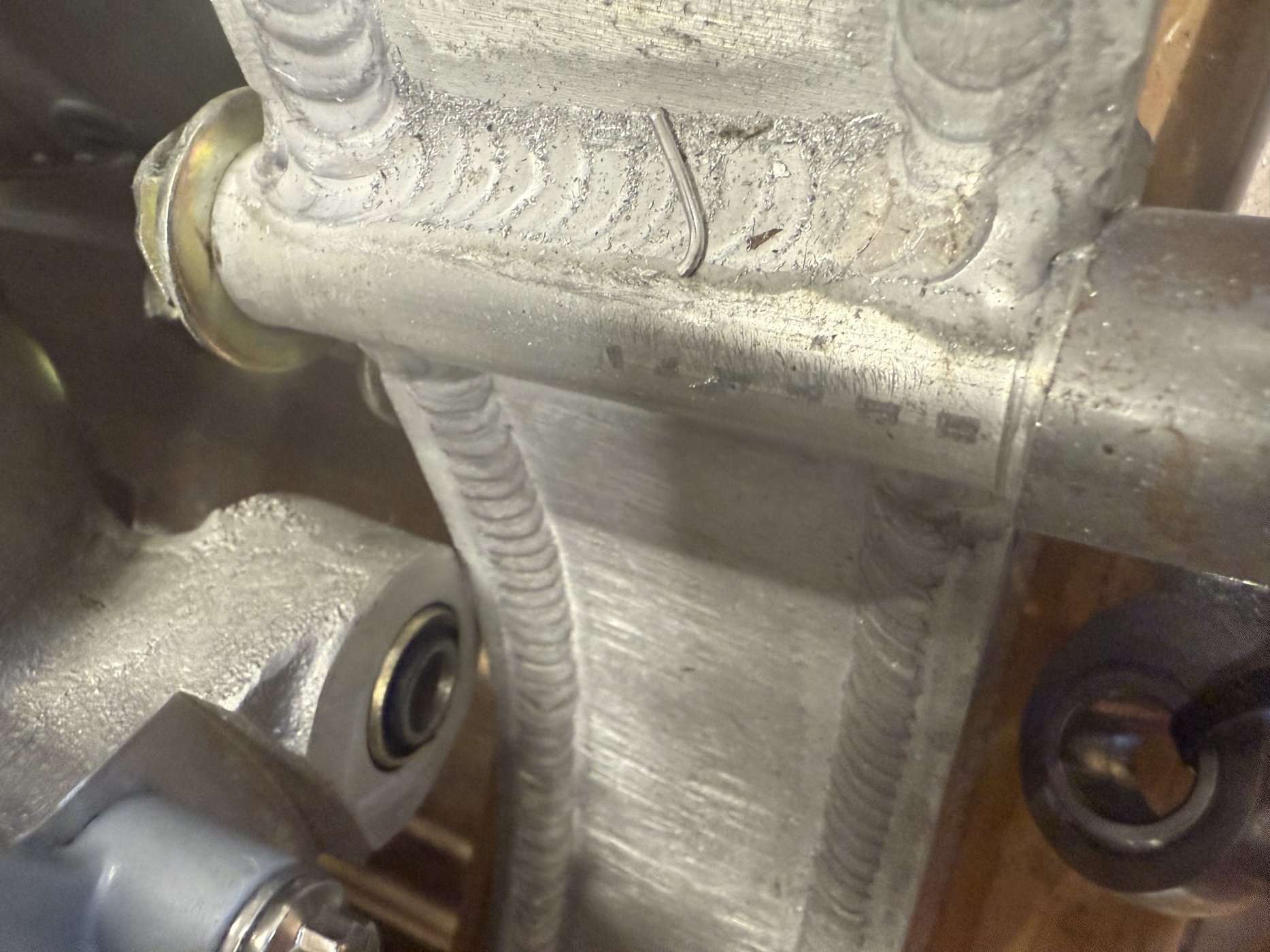

I was able to loosen the engine mount and the lower braces cleared. This is where the lower mounts line up when the top mounts are set for the upper bolts. Either something is way off with the upper crossmember or the RCR wasn’t designed to use the bottom mounts on a Safir bell housing. I called RCR for clarification and left a message. Hopefully I’ll hear back from someone. I could run bolts through those lower mounts in into an aluminum sleeve which i could weld onto the lower crossmember for more stability if needed.

Lee Patterson
That's too bad the tub is so low back there. I thought it was thicker allowing you to drill through it. Agreed you could weld a tube across the space and bolt to it.
