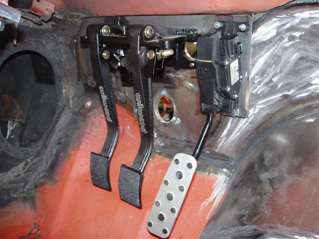

Why change to cable? The electronic pedals are easy to adapt to a conversion.

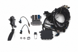

Adrian GM do a nice retro fit kit for many LS Motors. They power of the ECU is far greater than the aftermaket and the price is rite too.

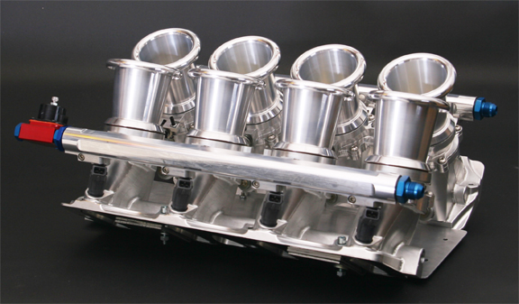

Otherwise, fit one of these, then you have to use the cable...

Would the TWM throttle body kit work with the LS3 engine, as it states in the spec LS1 LS2
