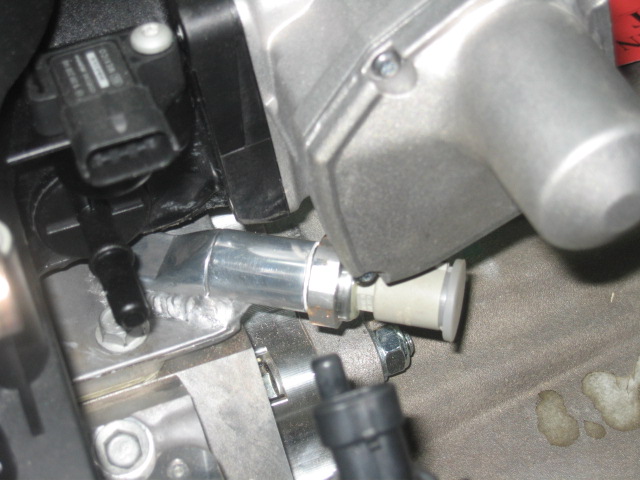

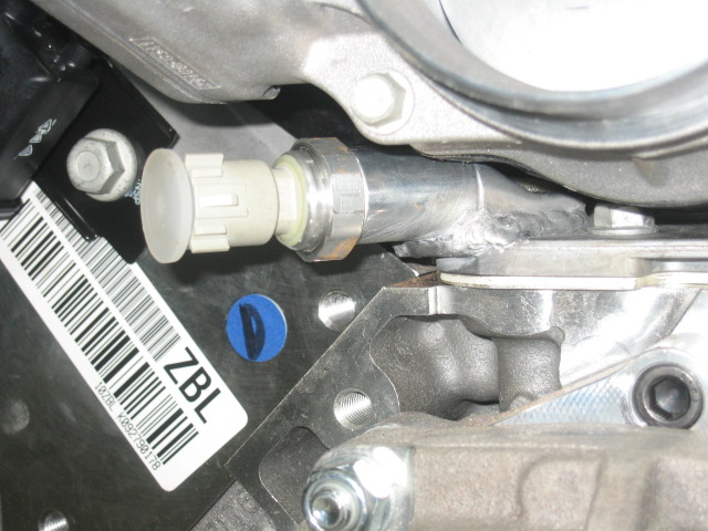

Troy,
This is what I did.

I cut mine down, welded it up, drilled and tapped it to a 1/8" NPT, then installed an AN fitting to use for a mechanical pressure gauge on the dash.
