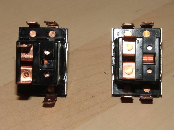

hi guys just recieved a couple of lucas switches and pulling my non existant hair out one is a off on on six pin i think switch for the wiper switch the other is a on off on for the indicators six pin not sure if these are the right way round has anyone got any wireing diagrams they could email over or could post to give me a heads up on the wire configuration i have posted a picture of the two switches

My 1990 GTD uses this switch (35927) Red/Green to 6, Green/Blue to 2, Brown/Green to 8.and Green to 4 with the 8/7 lugs on top. This is the wiper switch. The turn signal is mounted cross ways to represented left and right.
