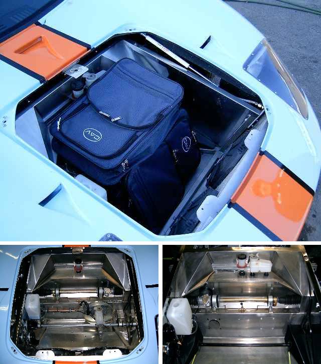

Hi Folks, Here's something that everyone can appreciate in our favorite car.
CAV Canada has an update which relocates the power brake booster into the pasengers' footwell. The CAV foot box is symetrical so the pedals can be mounted on either side. So there's nothing in the passenger side and a nice set of mounting tracks already welded to the floor.
This frees up room in the rad cradle for our 2pc Luggage Set. Luggage has wheels, pop-up handles and soft sides so you and your lady friend can take off for a weekend.
Now that it's all worked out, the modification is pretty strait forward, however we went through three generations of the systems' brackets, bellcrank, pushrods and fittings to get here. The single outlet nose fits perfectly over the bags.
