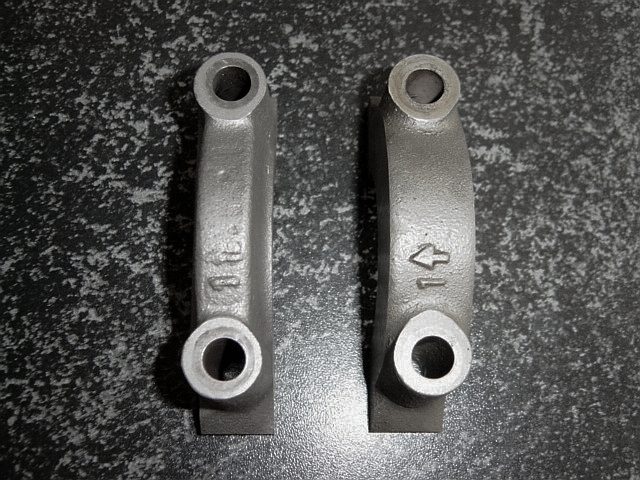

Standard 289 cap on the left. Original 289 HiPo cap on the right.
The Mexico version is similar.
