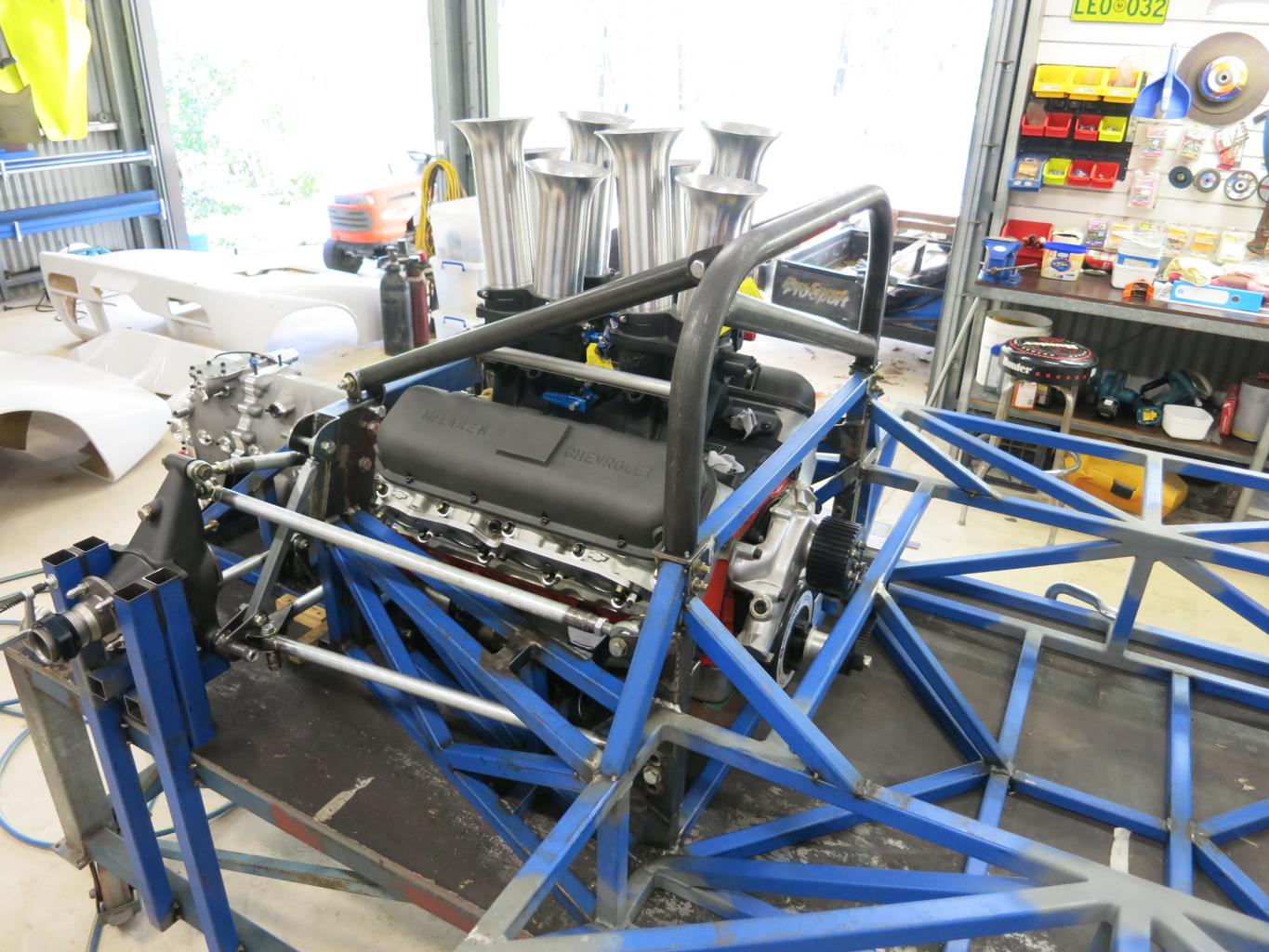

Hi Leon, The Starter is a Tilton 54-40005 Super Starter- Severe duty LGC Chevrolet, 104T. I did grind a small notch out of the return lip of the sump, aprox 25mm long and 3mm deep, 0nly to share not having to take more out of the mounting block, very minor. Hope this helps, by the way, if you are using a BB chev ( earlier Gen 4 type ) I have an brand new Aviad Dry sump and oil filter adapter I couldn't use because the 572 is a Gen 6. I'm not that familiar with Chevs and ordered the wrong one, and it was going to cost more to return it than it's worth.

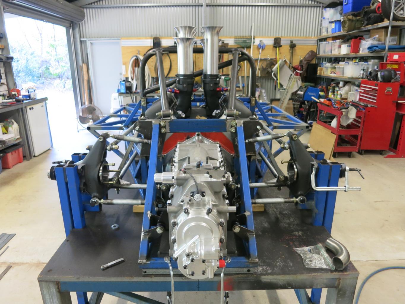

Hi Guys, Just thought I'd share what I've been up to. It's slow going, but I'll get there.
Regards, Udo.

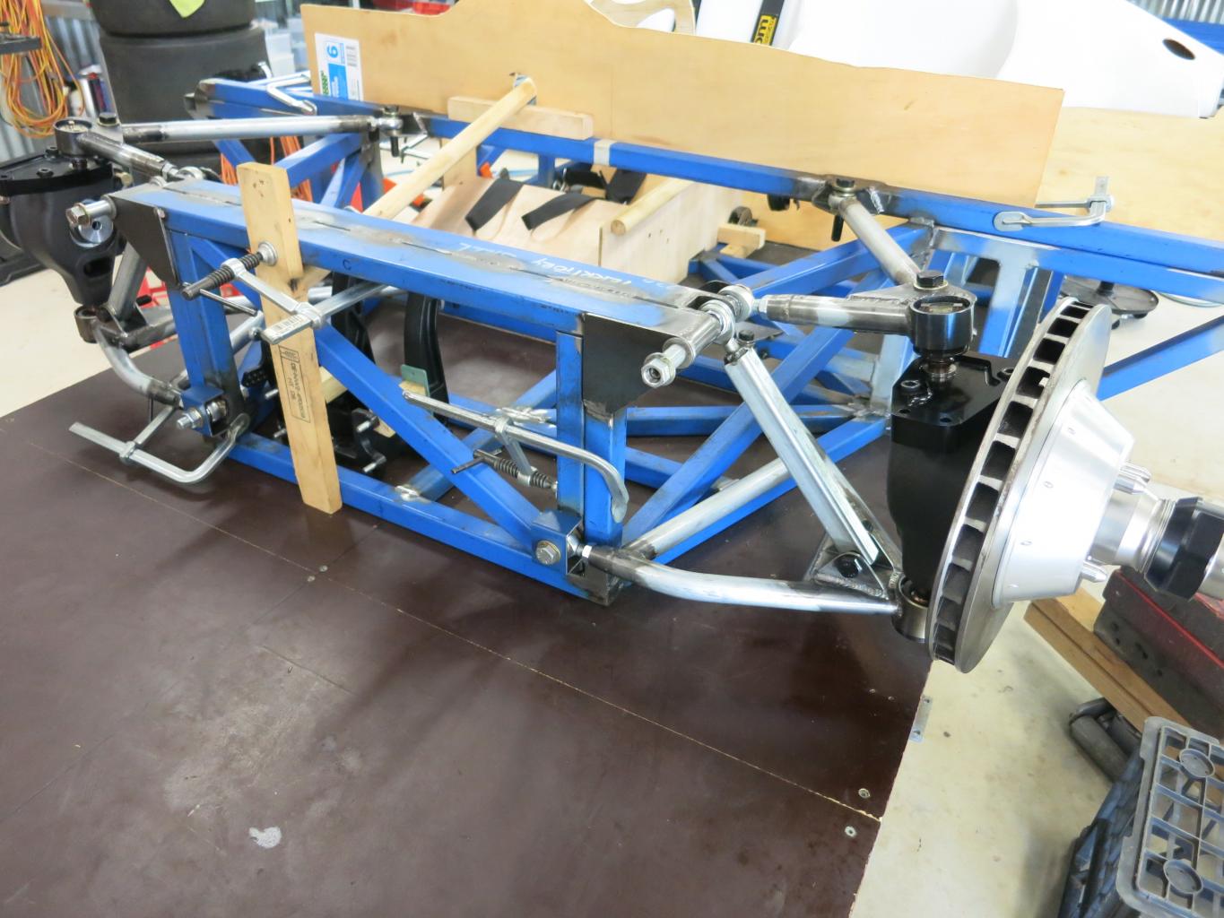

That all looks good to me, there is a lot to think about at this stage. What Front and rear uprights are you using?

Hi Russell,
The uprights are from Vintage Engineering who make Original replacement parts, they are M6GT thru to M8C style, the rears are magnesium but I cheapened out and got aluminium ones for the front. ( need all the weight on the front I can get :) )

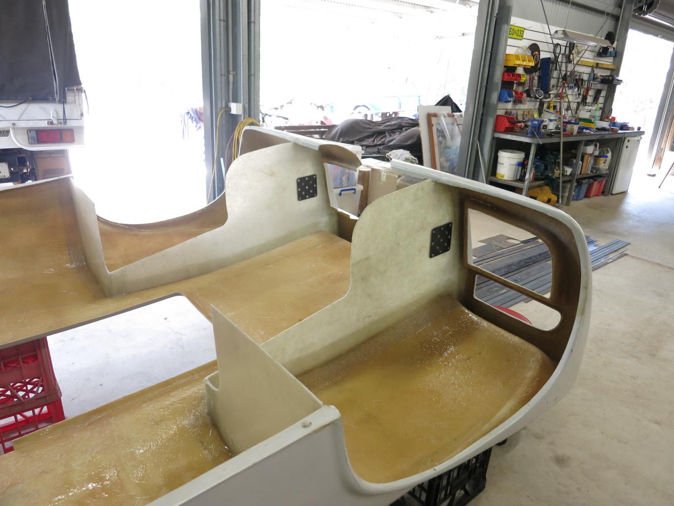

Yes, I have the bodywork, it's from Toluca Lake Classic Motor Sports. After building a couple of GT40s and playing around with Bolwell Nagari's I've had enough of fibre glass work and am happy to do as little as possible.

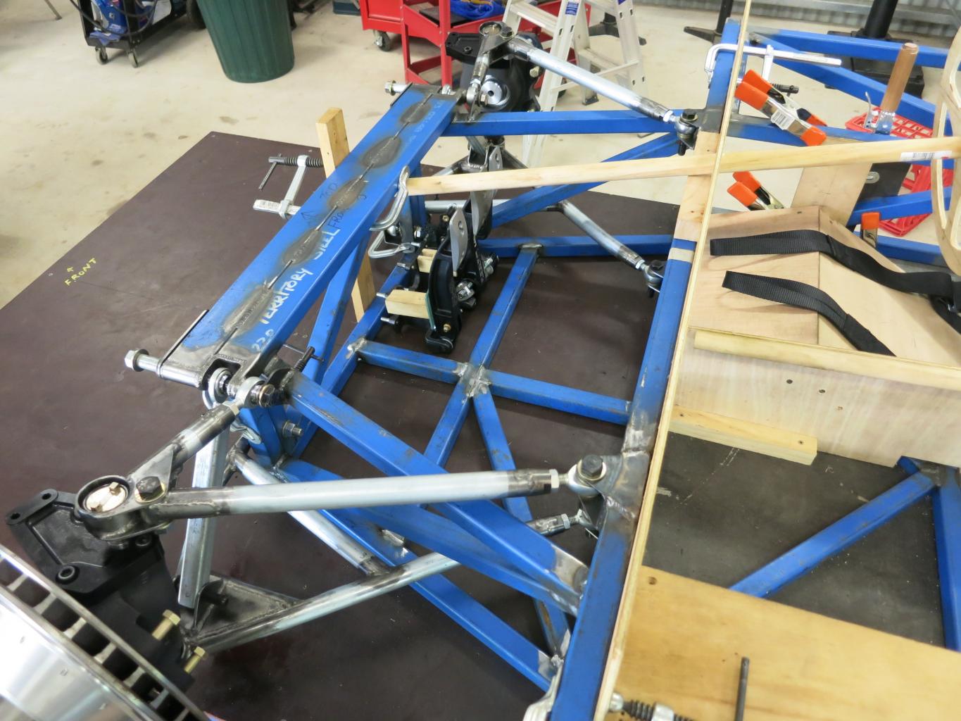

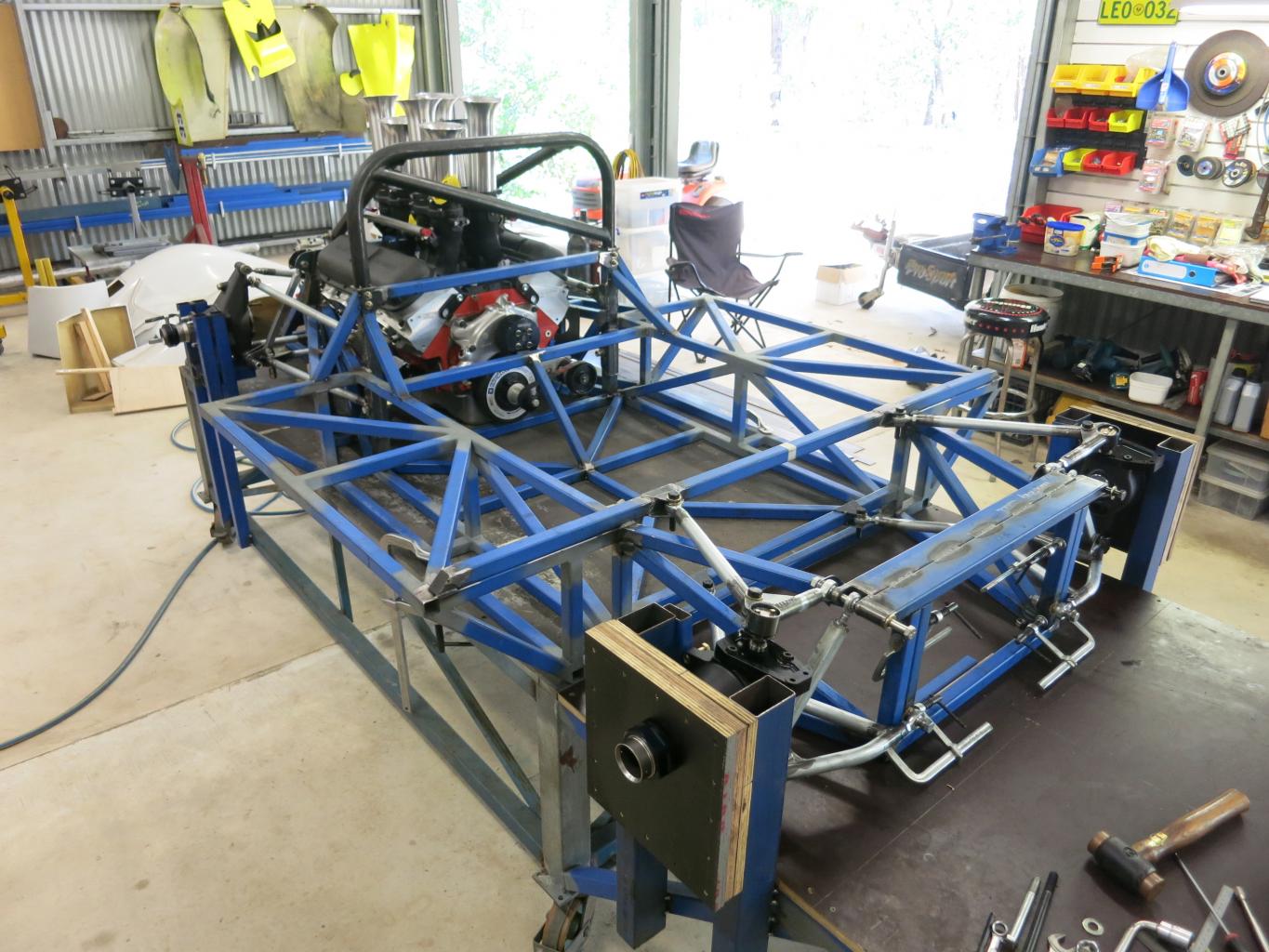

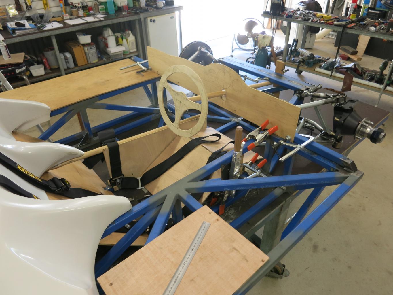

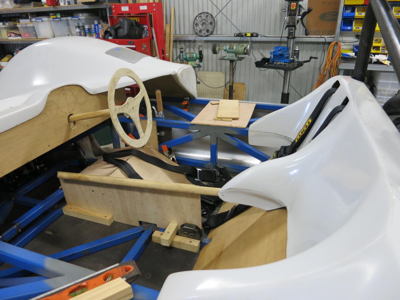

Hi Guys, just a bit more progress, I've added more bracing to the front end and incorporated heel support for the pedals at the same time. I've fitted the race harness points and added some for a passenger, for those fun days at the track. Now I'm playing around with mocking up my seating, steering and gearshift locations. Can't do any more on the front end until I get my steering rack which is taking forever, so I'll move to the rear and start the bracket that holds up the Body, exhaust and oil coolers.

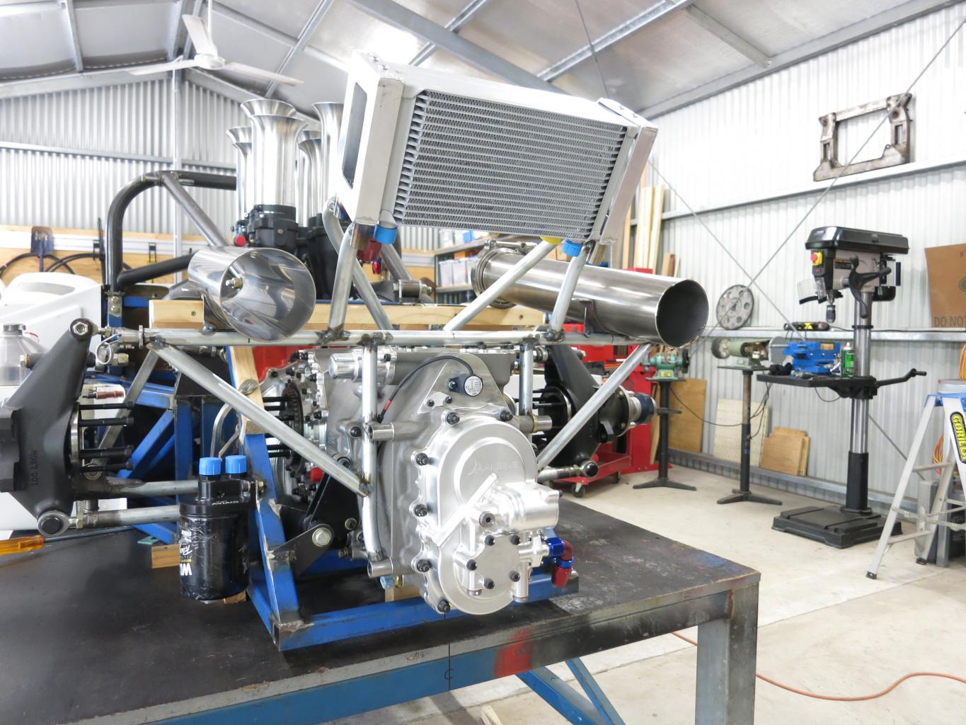

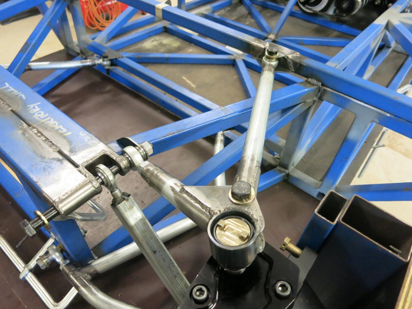

Hi Troy, Yes it is. I didn't really want to use it at first, but the transaxle has a cable operated reverse lock out, and it was the easiest option as they have that trigger on the gear stick.

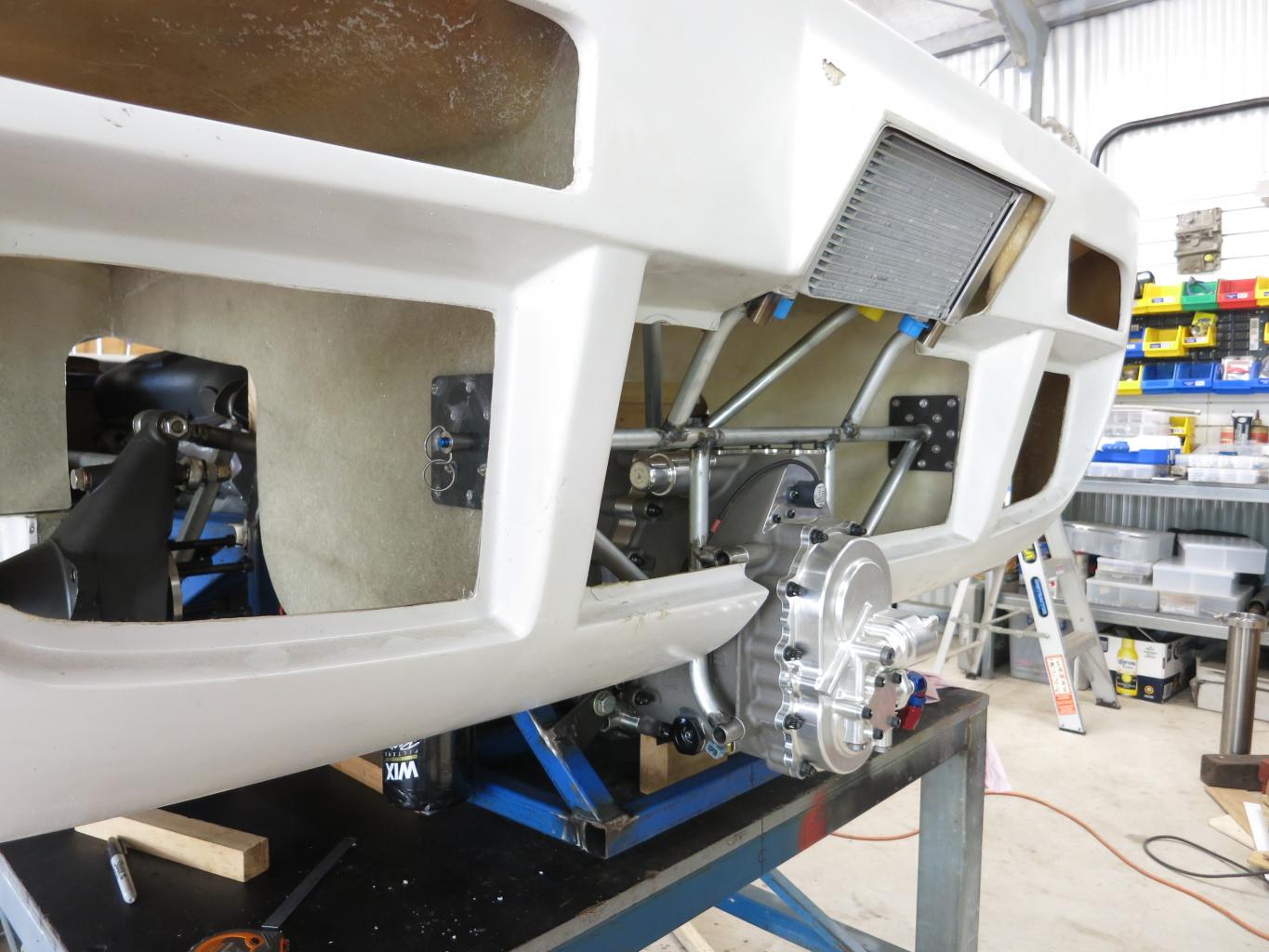

Inner guards made up and in place, rear bracket to support rear clip, oil coolers and exhaust tacked up and ready to TIG.

Thanks for the compliments Mic and Mark, and No Mic, the transaxle did not protrude that far out on the real deal, but I am not trying to build an exact replica, just a nice looking M6B replica with a few modern touches. ( and goes fast enough to scare me. ):thumbsup:
