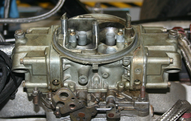

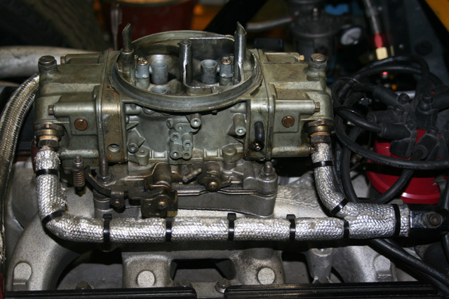

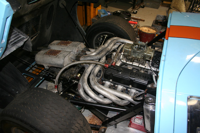

Here are the pictures of the carb post machining. It is running well so overall a worthwhile job. Thanks to Anthony for help with some rebuild books. And also to the others who have sent PMs with other web places to visit for more ideas and tips. My prime aim now is to get the car ready and reliable for Spa at the end of the month which even though is a decent time away is not much time due to a busy schedule, including crewing for Glenn at Le Mans for the Friday parades in his Southern GT. Never been to Le Mans before so first visit includes being IN the parade is pretty cool for me. Those exhausts really do need coating again!

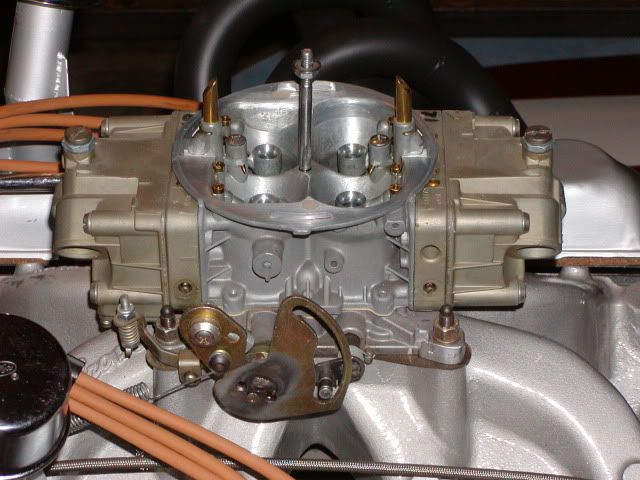

Hi Rick,
My 650 could never look like that with the choke tower removed as it does not have the meat in it to radius the corners like that. Clearly that is a better result than what I have acheived but it looks like it was cast differently from day one. When my air filter is on actually the flow of air is not too broken up by the top of the holley post machining, so I think I have acheived about 90% of the air flow improvements possible. You definately look to have about 100% of the air flow improvememt achievable. And with the other mods, that is a proper carb. What do you mean by fat at idle? Lumpy? Rich? That is a new term to me.
Yes, Rich.
Malcom it is the exact same casting. Look at it closely. The cutter in the mill was taken all the way down the the flat surface outside the choke horn. I left 4 small sections of the air filter housing rgister at 90 degree intervals to locate the air cleaner. Then radius the edges evenly.
