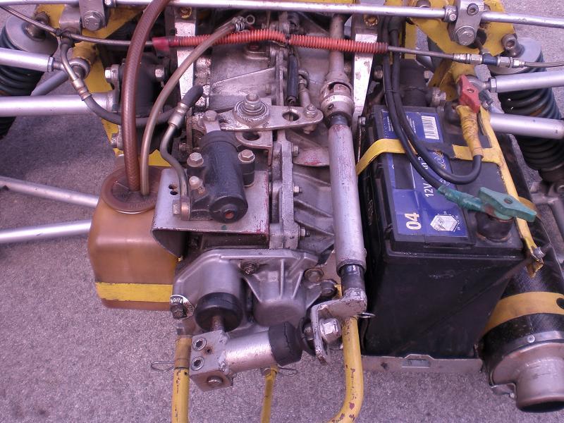

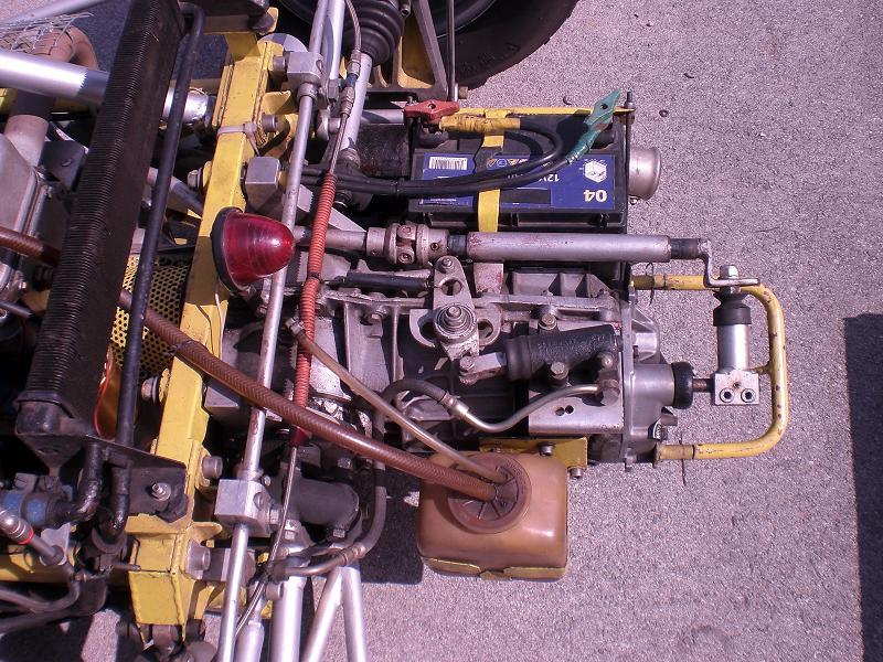

Hello If you want eventually to go to rod system shifter ;
these are some samples on old french single seaters using renault gearboxes:

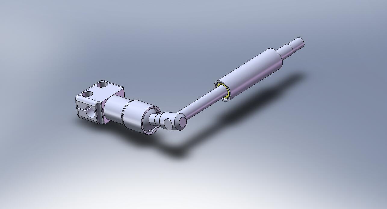

If you need I did recently all 3D drawings of specific parts to built on arod shifter
You can have some PDF files free if you need just ak
This is aview of What I did
