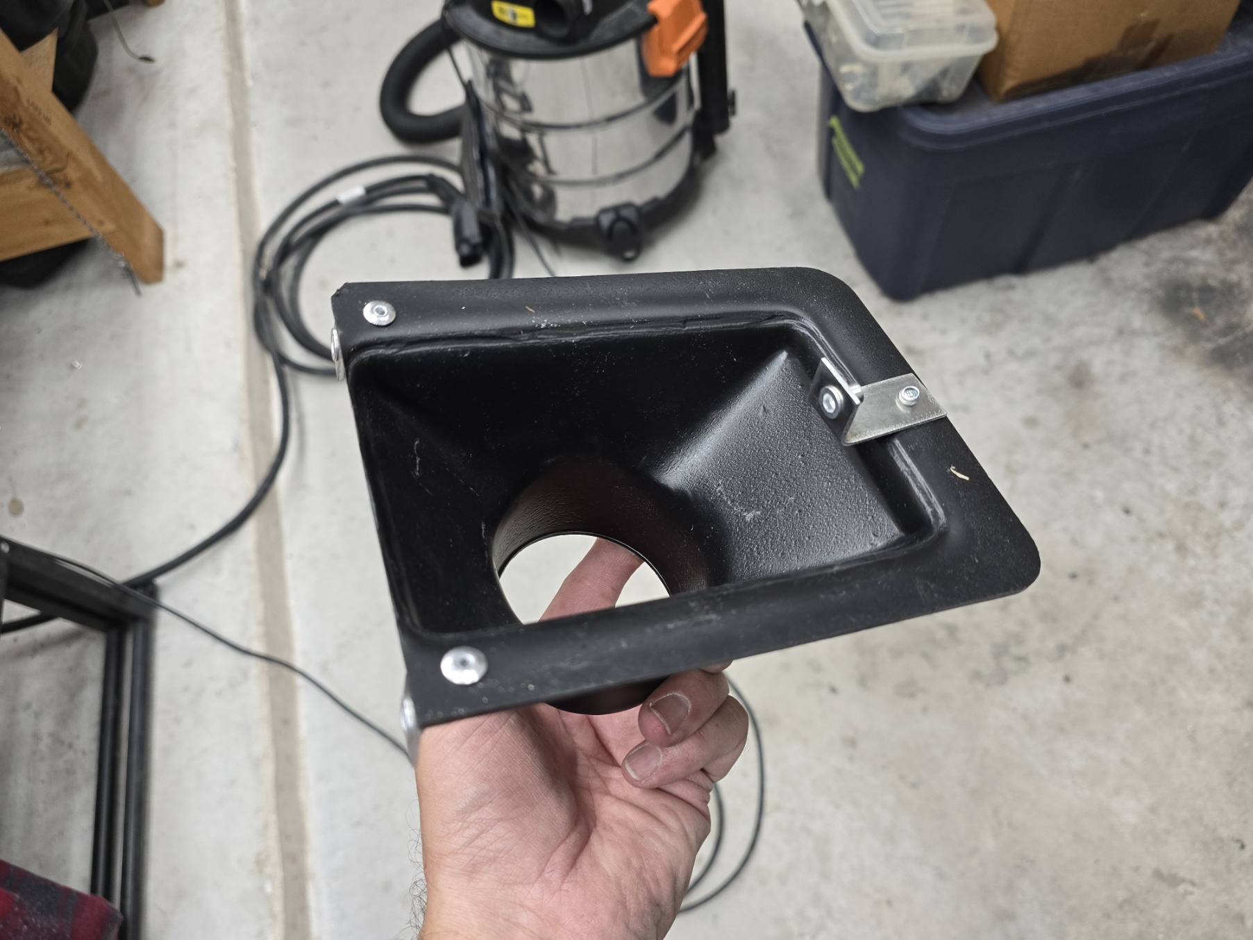

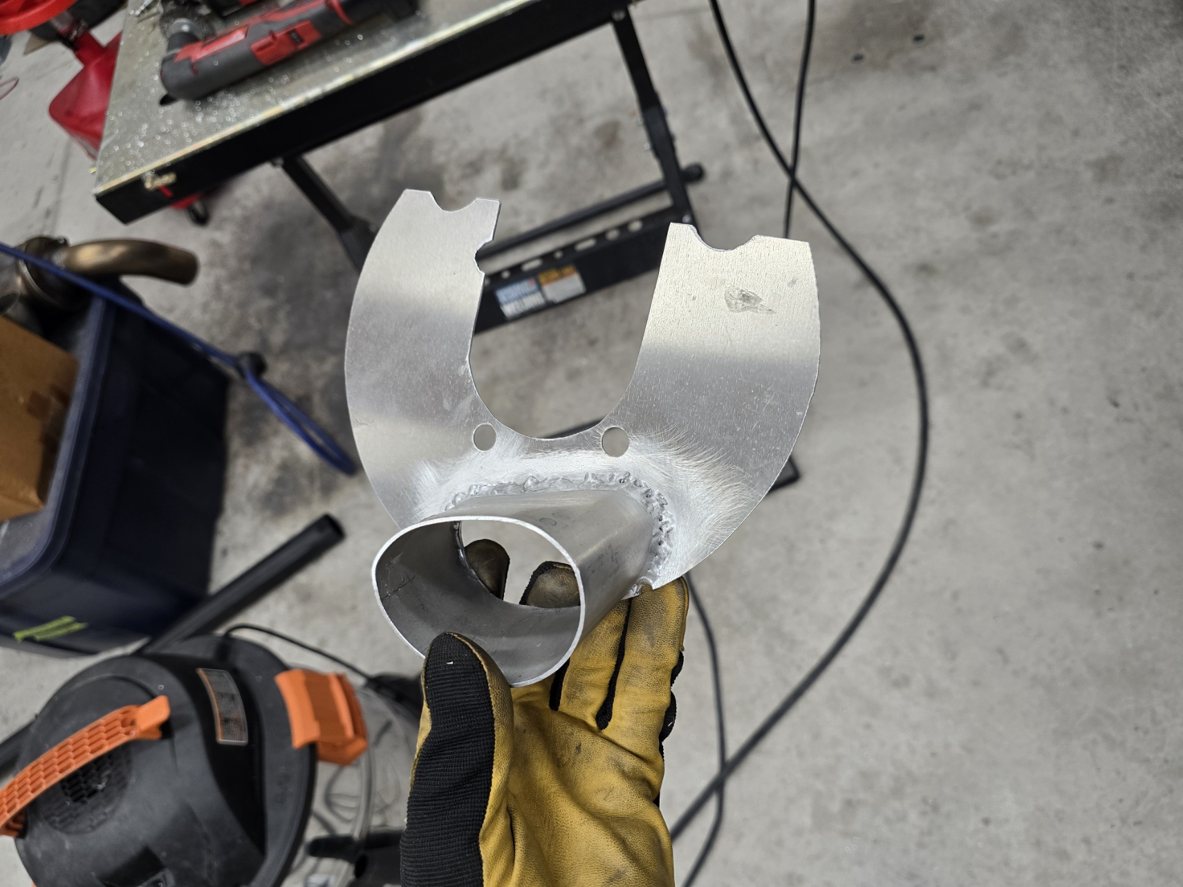

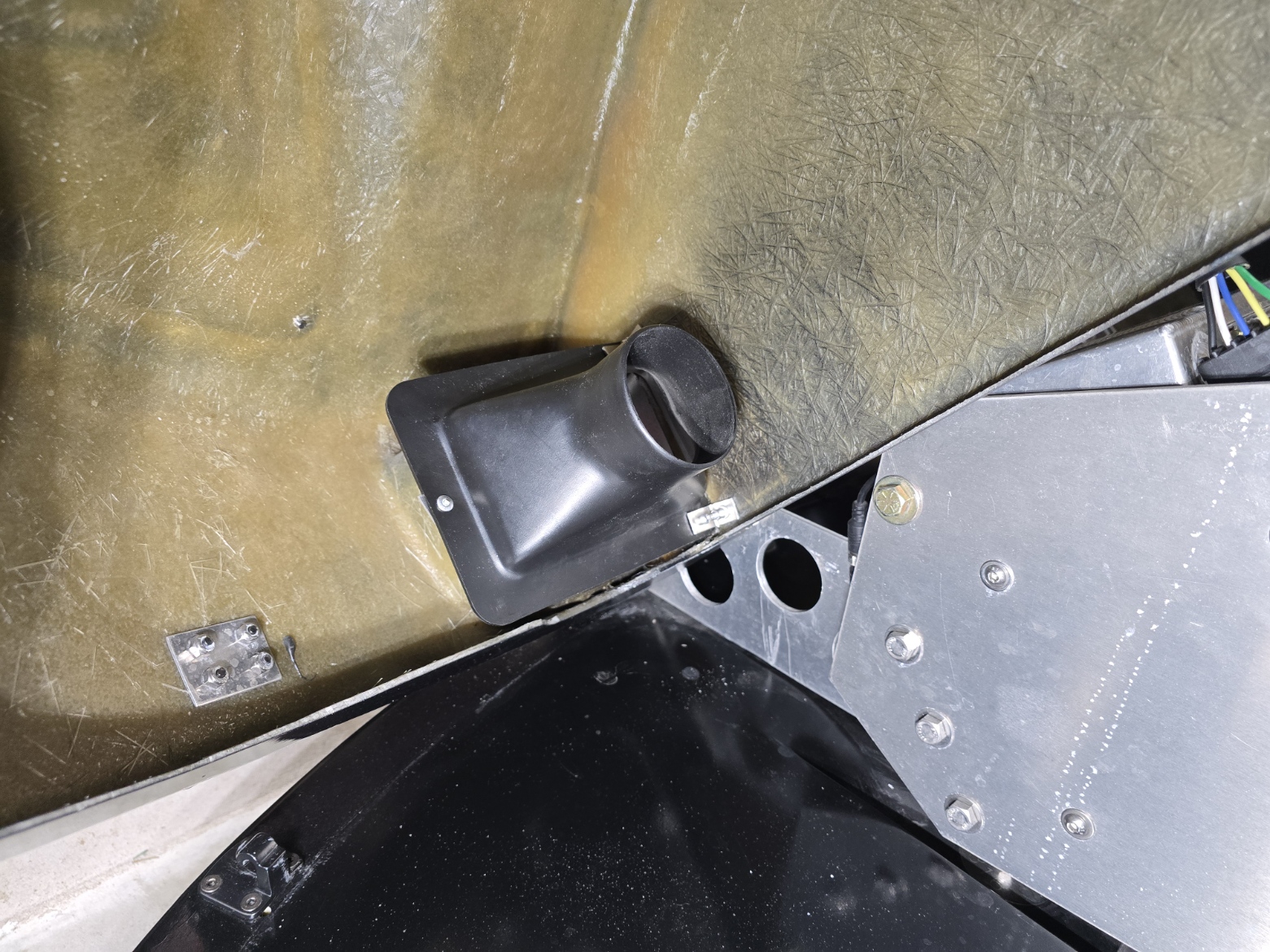

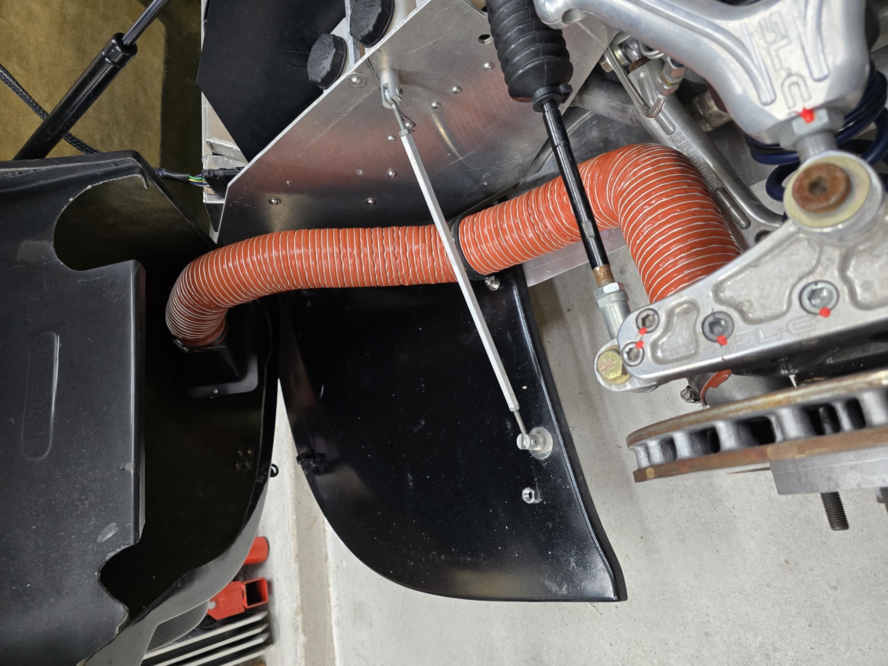

In addition to the normal stuff like alignment and swapping out brake pads I wanted to add front brake ducts so here are a few pics. I know I'm going to need to swap out the stock C4 wheel bearings, so will revise the mounting when I do that.
For the inlets, I used off-the-shelf 4x6 3" ducts and made 3 small L-brackets on each side, riveted to the ducts and #10 screws through the body. It's not a perfect match for the body duct, but close enough to cover the whole thing.

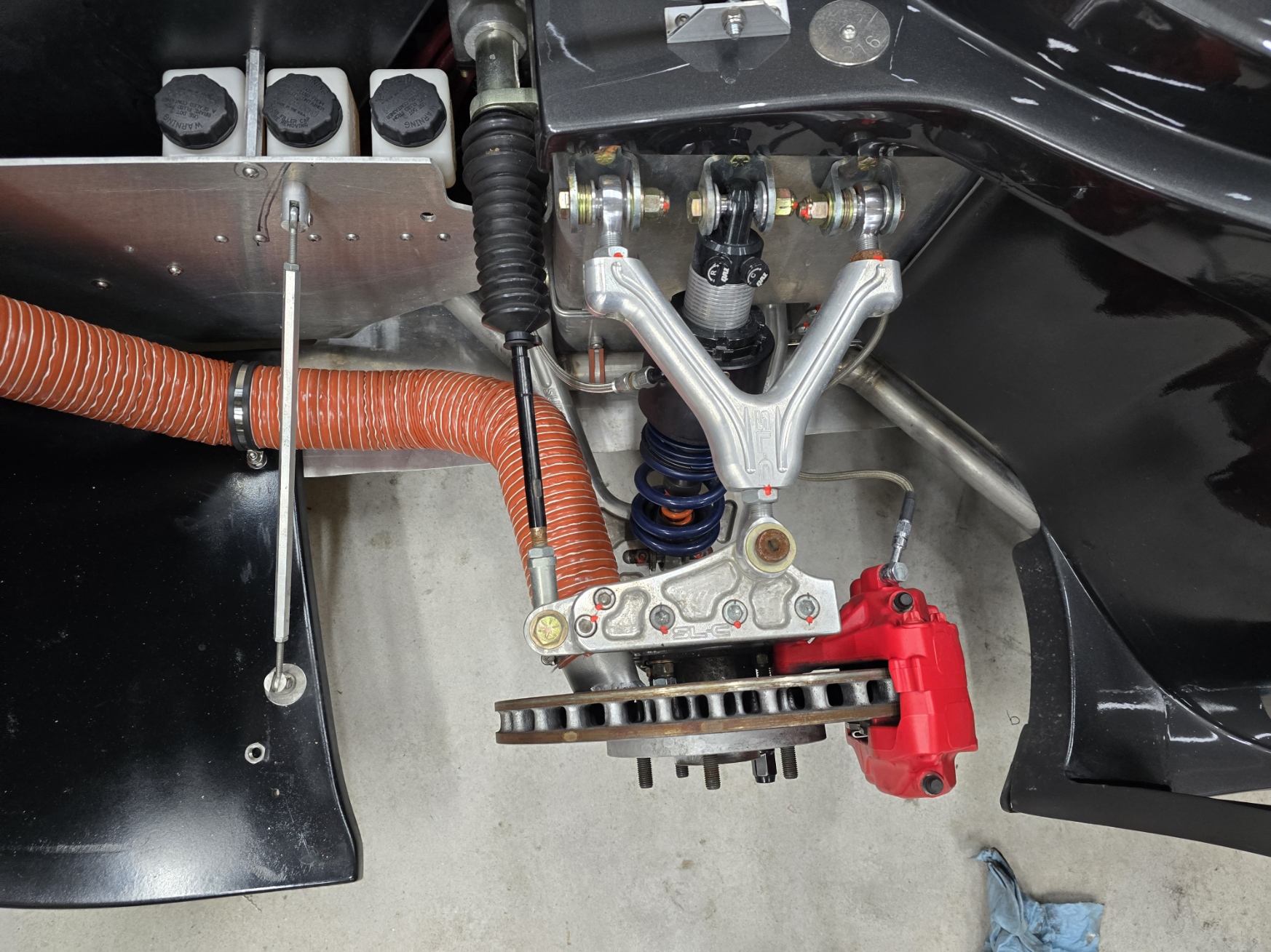

I made a template out of thin cardboard and cut the rotor-side duct plates out of aluminum. Then shaped a 3" aluminum tube to fit the plate and welded it on.

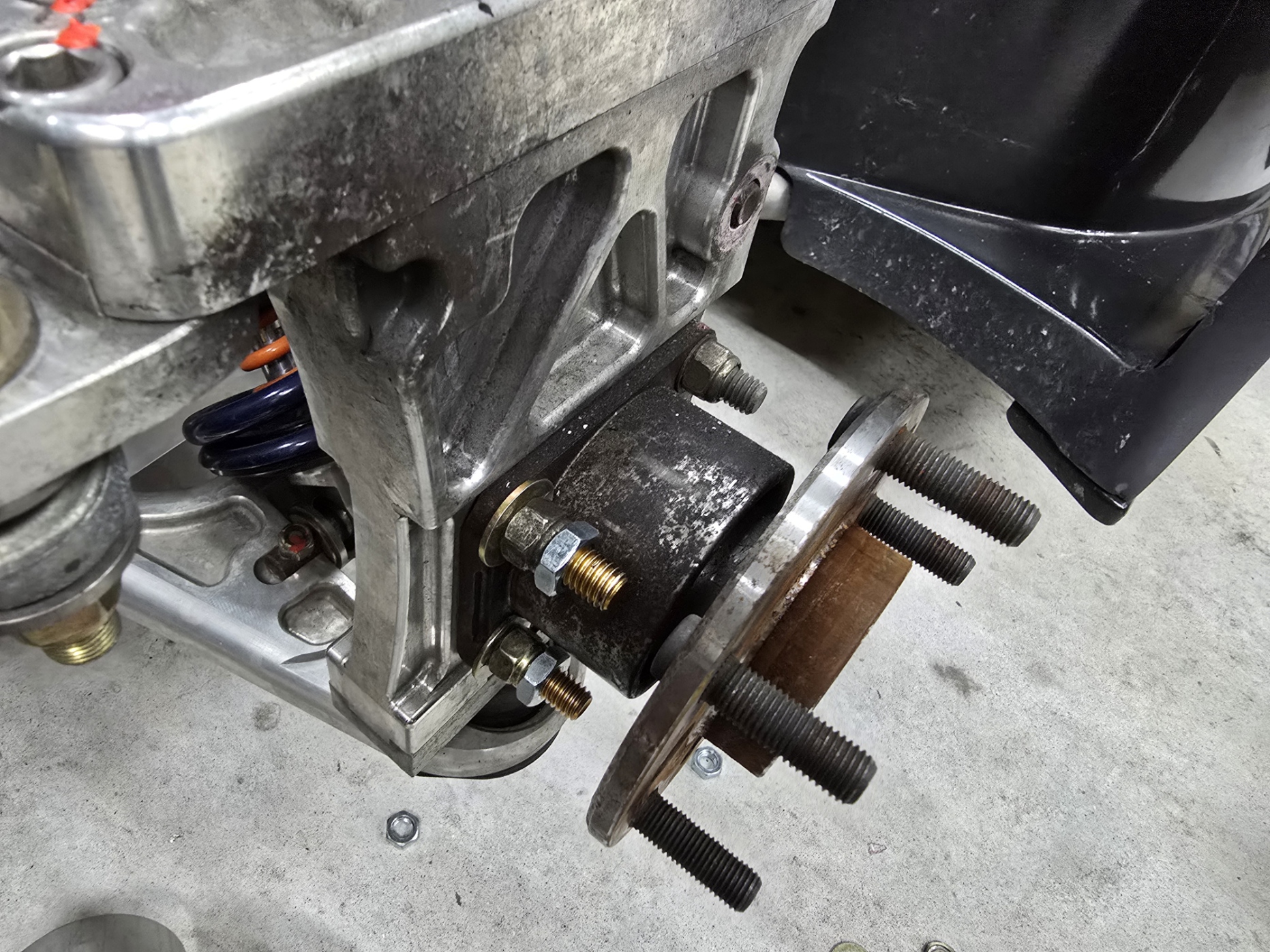

I used 2, longer hub bolts to mount the plates.
Since I have wheel well liners, I cut out enough to clear the hoses and used a P-clamp to keep the hose in place when I open the hood. There's enough flex in the hose to allow the hood to open and close without binding the hose. I just need to zip-tie the ducts to the A-arms to keep them from flopping around, but checked lock-to-lock clearance and there's plenty in both directions.
Why the double nut on the hub mount?

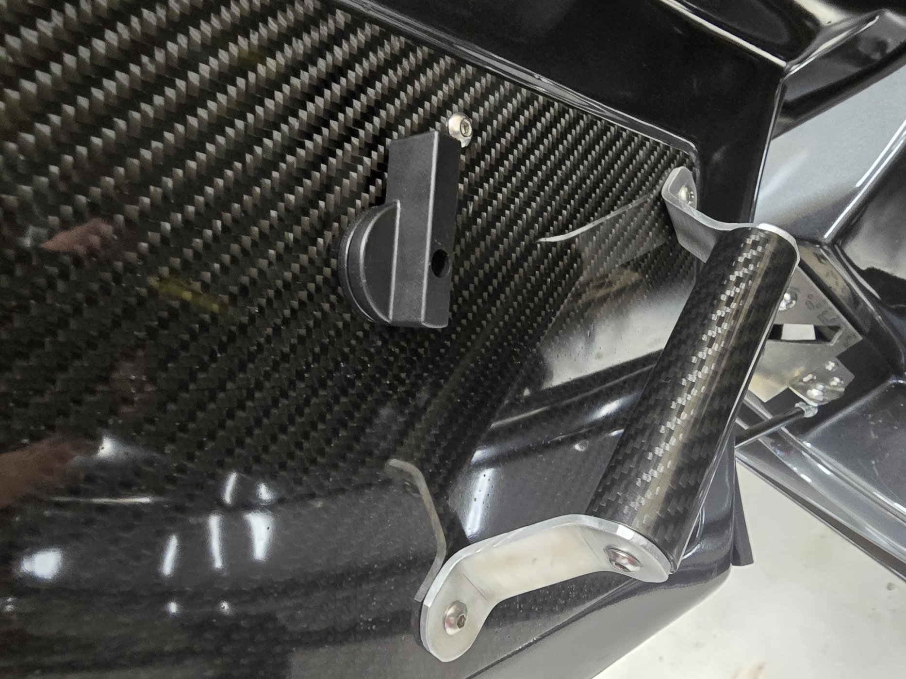

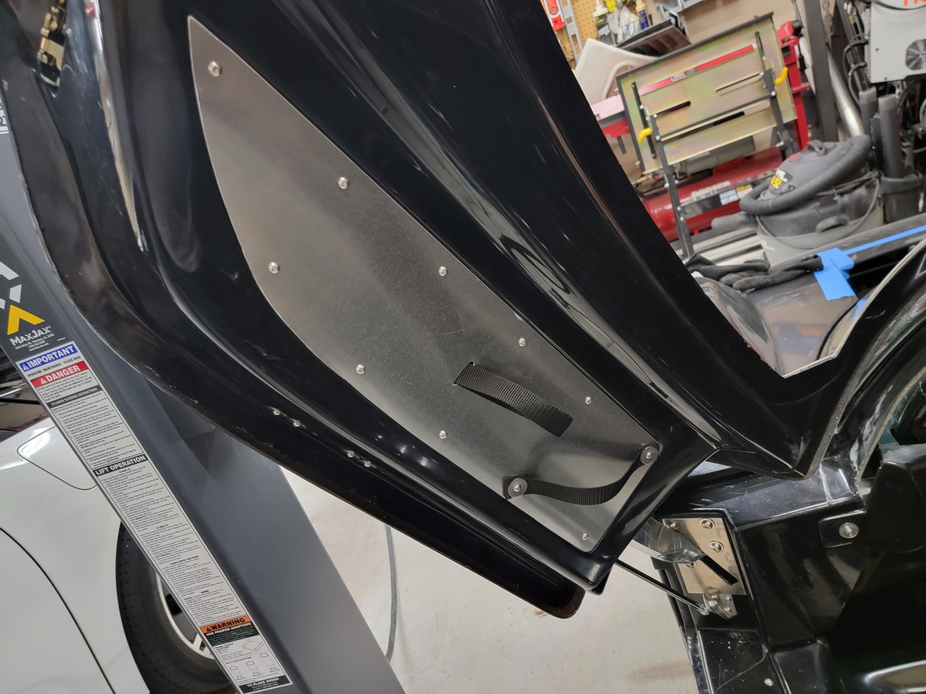

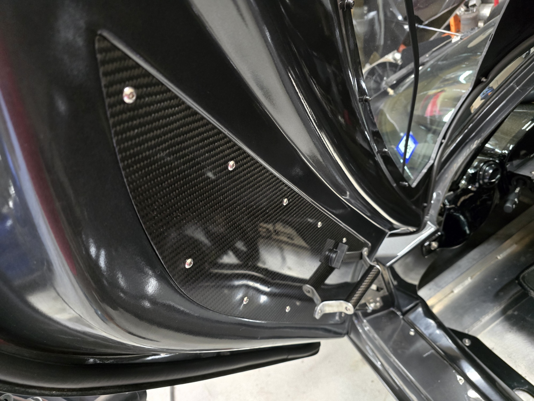

I've been wanting to replace my 'temporary' door panels/pulls/releases for a while now so I finally tried laying up some carbon fiber panels. For my first time I think they turned out alright. 3 layers of 2k carbon wet-laid and cleared with rattle-can 2k gloss clear. I used 3/4" carbon tube for the door pulls with 1/8" aluminum brackets that I bent up. The releases are drawer latches I got off Amazon, but they work perfectly, and I think they look good/simple.
The old setup:
And the new setup:
Mark B.

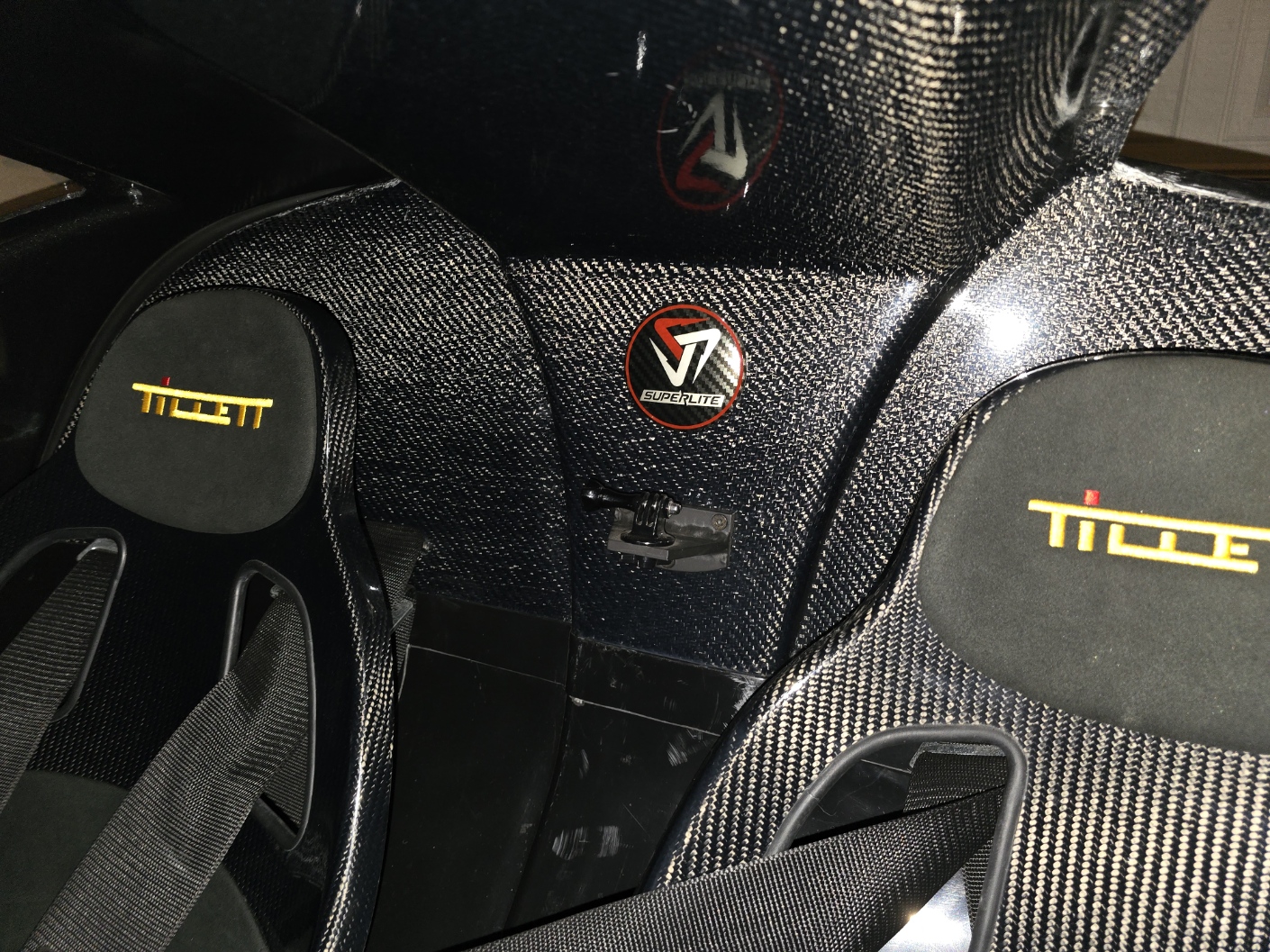

I decided to put my SLC badge (thanks Fran!) inside the car rather than on the hood. Have to make people work a little to figure out what the car is :)
