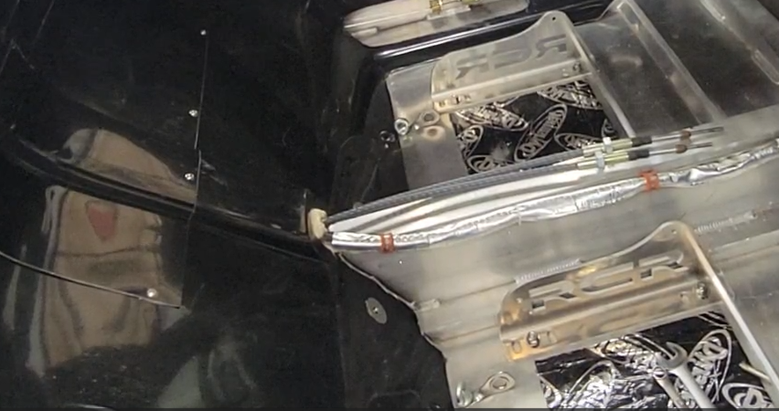

Mark B.

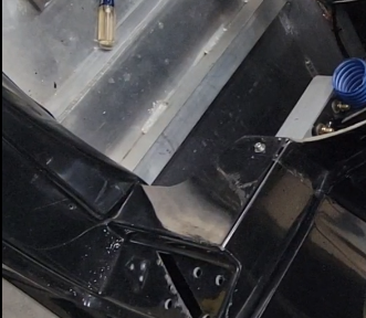

Hey Joel,
Here are a couple screen grabs from a video I took before I dropped the car off. Not great angles, but you can get the idea. I completely removed the center console as well as the area in front of the seats. I kept those pieces in case I ever decide to put them back in, but after driving it for over a year I prefer it this way. You can also see the access panel behind the driver's seat for fuel tank fitting access.

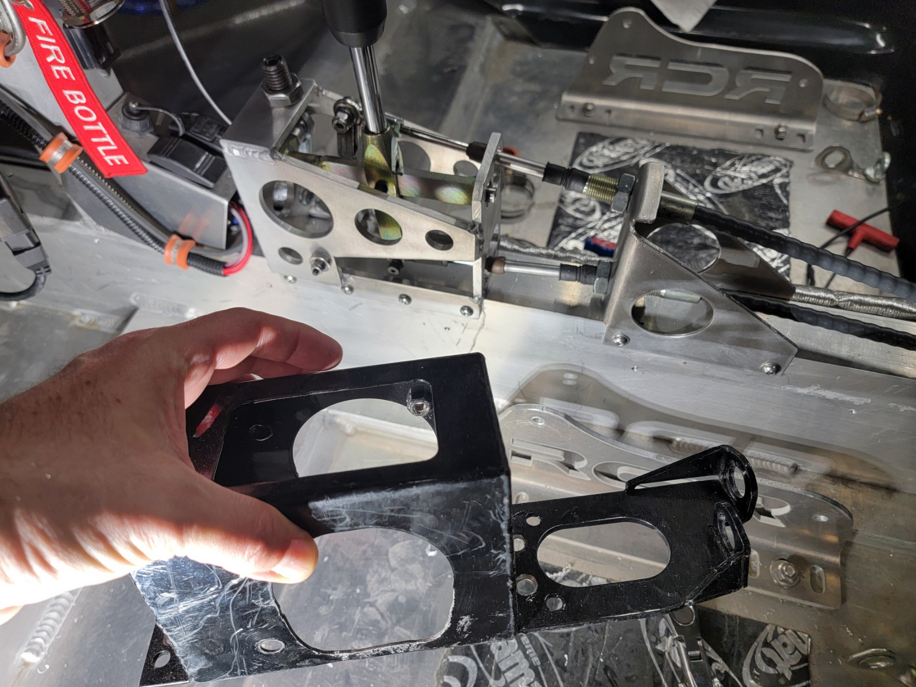

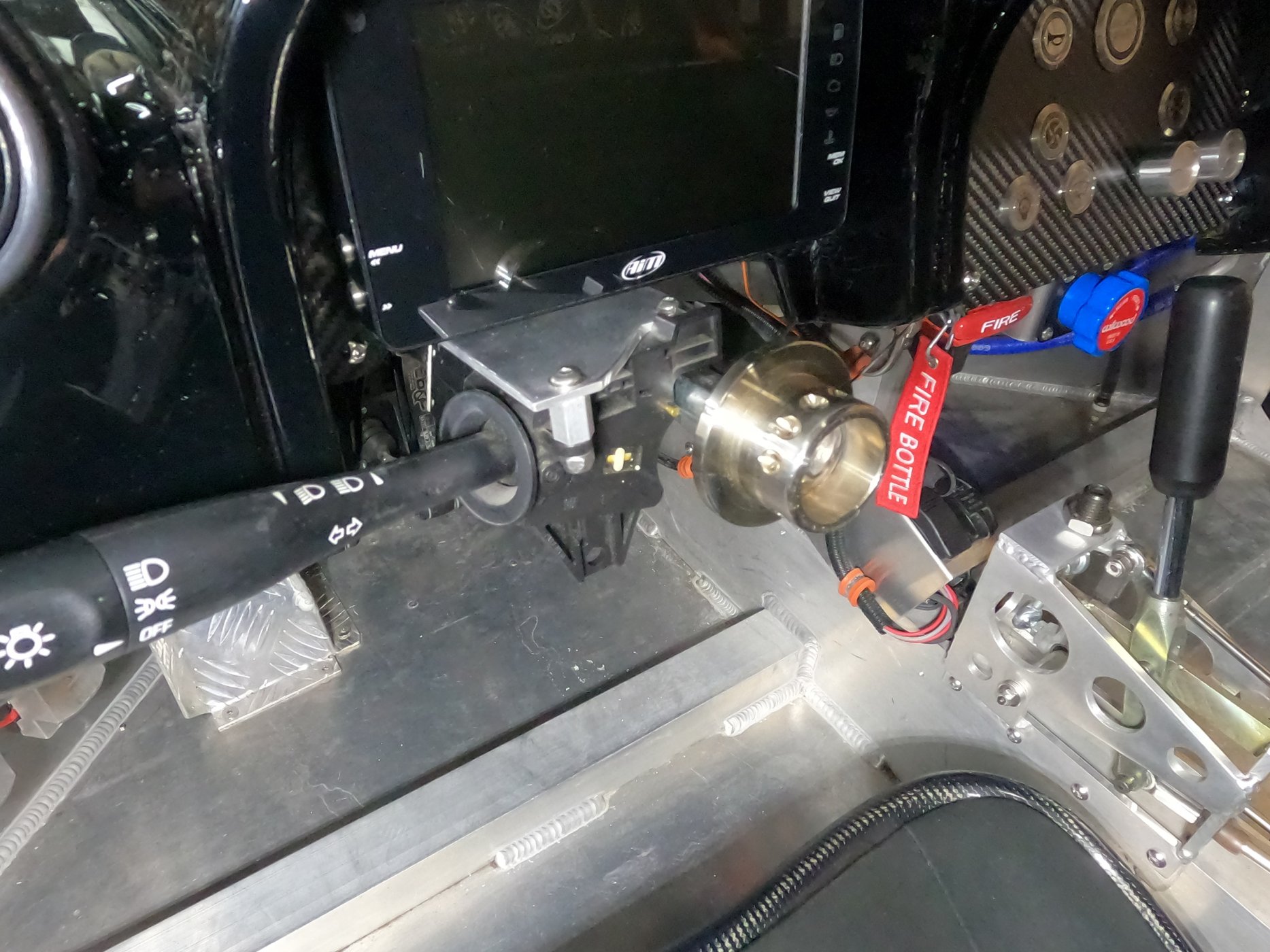

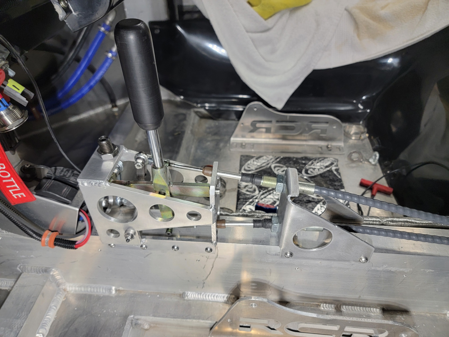

Well one of my many side projects on the car was rebuilding the factory shifter. I have the basic one for the Graz that came with the kit back in 2014 (not the nice gated shifter). It worked, but shifts were very sloppy/loose, and it lacked a reverse lockout which made for some occasional embarrassing moments when shifting down from 3 to 2 and accidentally hitting the reverse gate.
The other reason is that since I decided to go with a minimalist interior, I removed the center console and a portion of the tub forward of the seats so the shifter is exposed. The stock shifter is pretty ugly, so I wanted to change it up.
Rather than throw money at it, I wanted to try to reuse much of the original mechanism but simplify it a little by removing extra pivot points and also added bearings wherever possible along with tighter tolerances on moving parts.
Overall I'm really happy with how it turned out given my ugly welds and doing all the fabrication with basic tools (miter saw, drill press, TiG welder). Definitely not nearly as pretty as the RCR CNC piece though. The feel is MUCH better/tighter and the push-through reverse spring works well.
Video linked below of the process along with the finished product and comparing it to the original case.

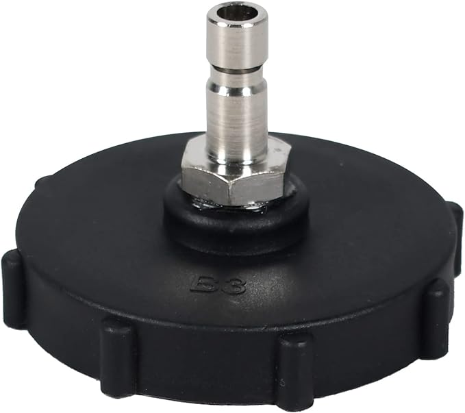

Get one of these and make/modify your own master cylinder caps with screw-in AN-3 fittings and use a length of brake line type hose to connect it all up. Something like below but with a male AN fitting screwed into the cap. You will use this forever and smile every time you do. I bleed and replace all my brake fluid each winter and it takes me about 2 hours and a couple of beers, Easy Peizy

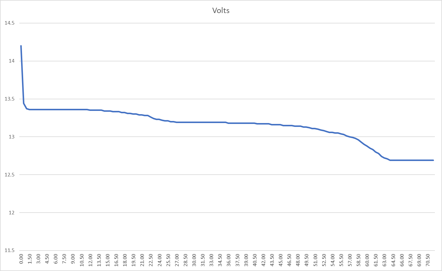

I decided to do a test to see how long it would take to run the battery down with the battery switch on (car ignition not on, but infinity box active). I started with it fully charged at 14.2 volts. Within about an hour it dropped to its nominal voltage of 13.5. It lasted 70.5 hours before it disconnected itself. I pressed the "restart" button and the car fired right up. Graph below shows the voltage over time (yes I literally went out and manually measured the voltage every 30 minutes except while I was sleeping so I interpolated those ranges :) ). I found it interesting that the curve dipped a fair amount each evening -- presumably because my garage isn't heated, but it only got down to something like 40 degrees F those nights.

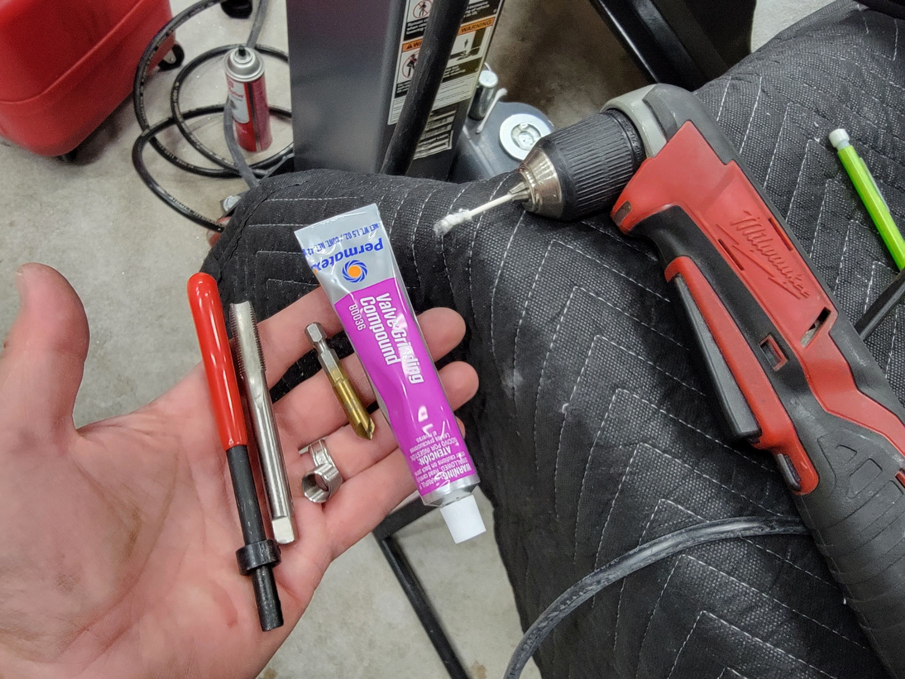

Brake bleeder is fixed! Wow that was a pain in the butt. Helicoil, 90-degree countersink bit to re-grind the seat along with some valve grinding compound and a Q-tip on the drill for final polishing. Yes I was literally raised on a farm and my dad worked in a scrap yard, so you make it work with what you got.

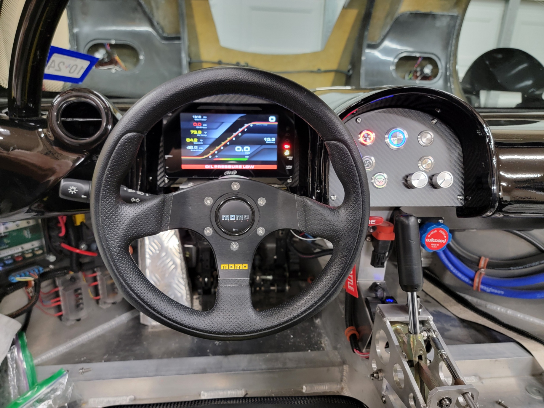

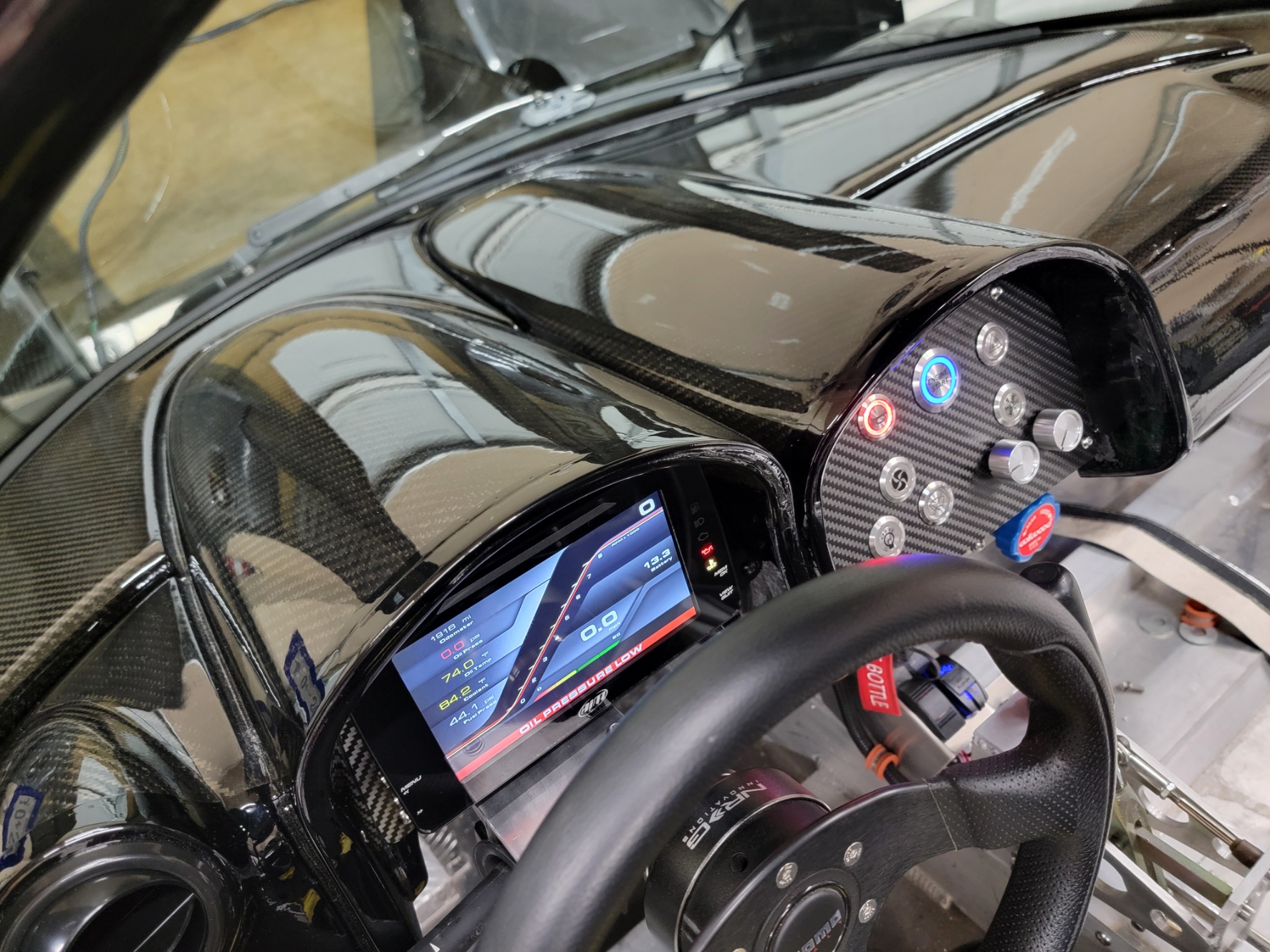

I also decided to replace the fiberglass dash with a carbon fiber one after I didn't really like the prices/options of covering it (and I don't have the skill to do a satisfactory job myself). It's still the gloss epoxy from RCR's supplier -- I may do a matte clear-coat on it if the glare is annoying. For the curious, the stock dash is 11.8 lbs and the carbon one is 8.6 lbs. I replaced the painted aluminum insert panels I had made with thin carbon fiber sheets. The finish doesn't match the dash but for now it's fine. I also got a carbon roof/bulkhead panel but still need to do a lot of trimming on that.
I also replaced the original Olds steering column with a simple steering shaft since the tilt was unusable anyway. I removed the lights/turn signal stalk and just made a simple bracket. Relocated the horn and wipers to dash buttons. I thought about a wireless setup to replace all of those, but that's not in my budget -- maybe down the road. Replacing the steering column freed up a lot of room under the dash and also saved 10 lbs.

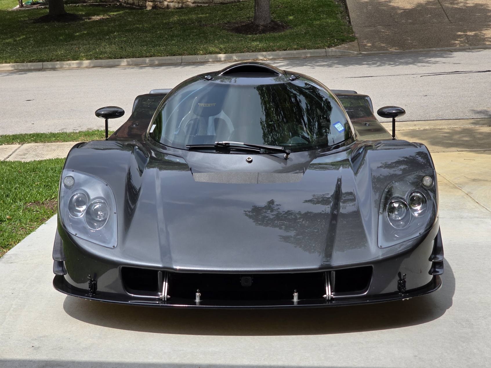

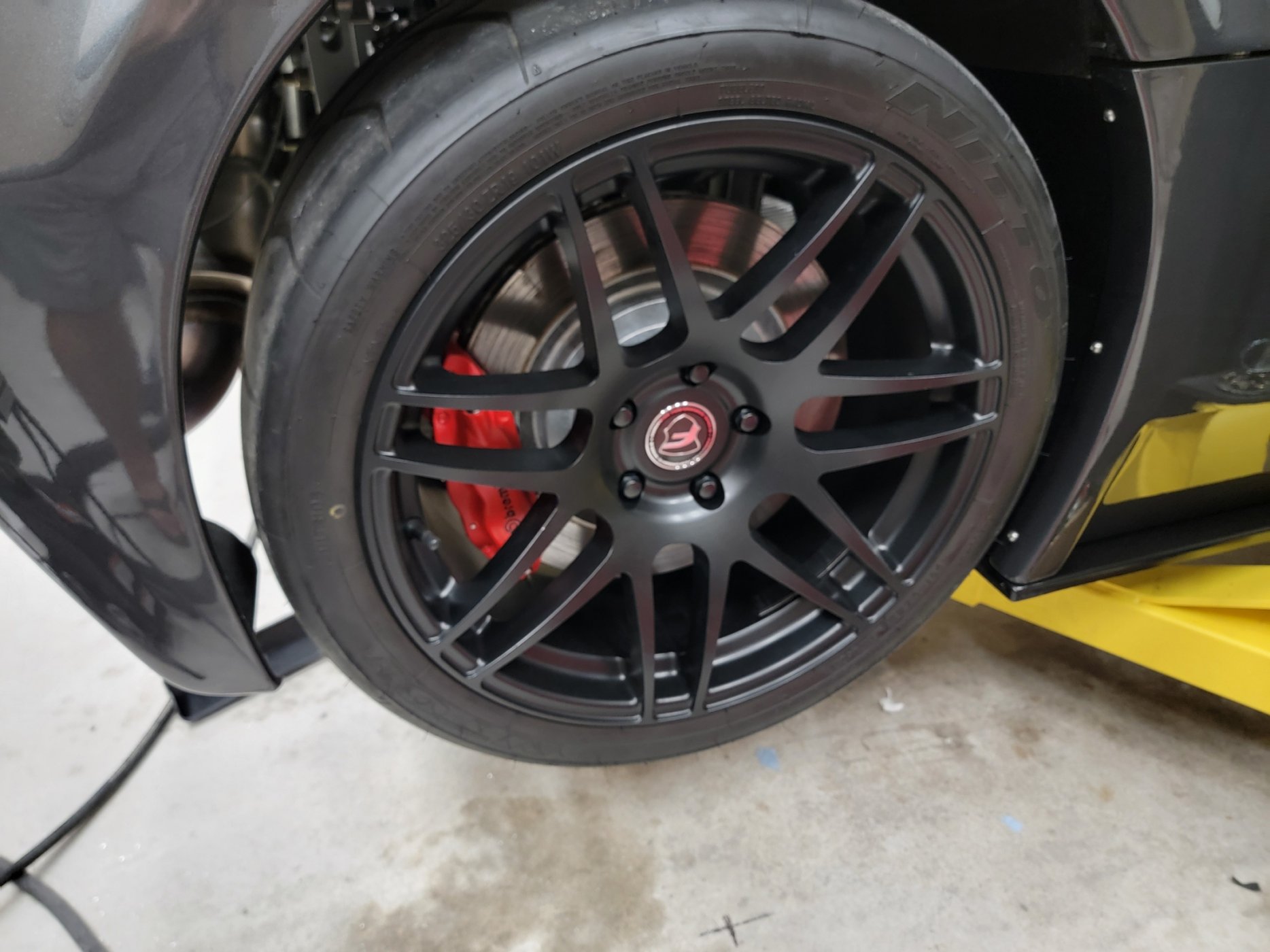

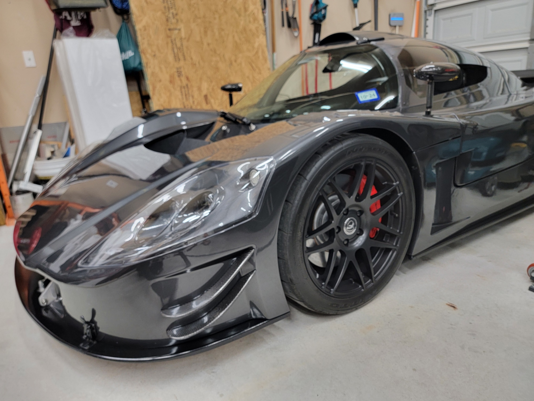

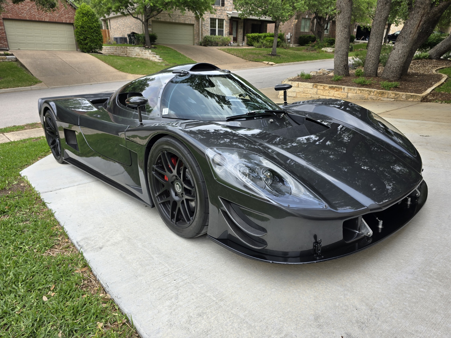

Finally have the car back together with paint! I'm cobbling together a video, but in the mean-time here are a few pics. Overall I'm very happy with how it turned out, particularly since I went with a 'track car' quality paint job (i.e. cheap -- under $5K). I went with paint rather than dip or wrap because I wanted the door jambs, inner doors, etc covered. They did pretty basic panel smoothing, removing seams, etc.
The color is a Corvette color (Watkins Glen Grey, code G7Q). I wanted something that was a little more subdued to offset the fact that these cars are attention magnets ;). It also helps hide some of the areas / body gap lines that aren't perfect. I also got the calipers Cerakoted red with black painted "Brembo" lettering.
