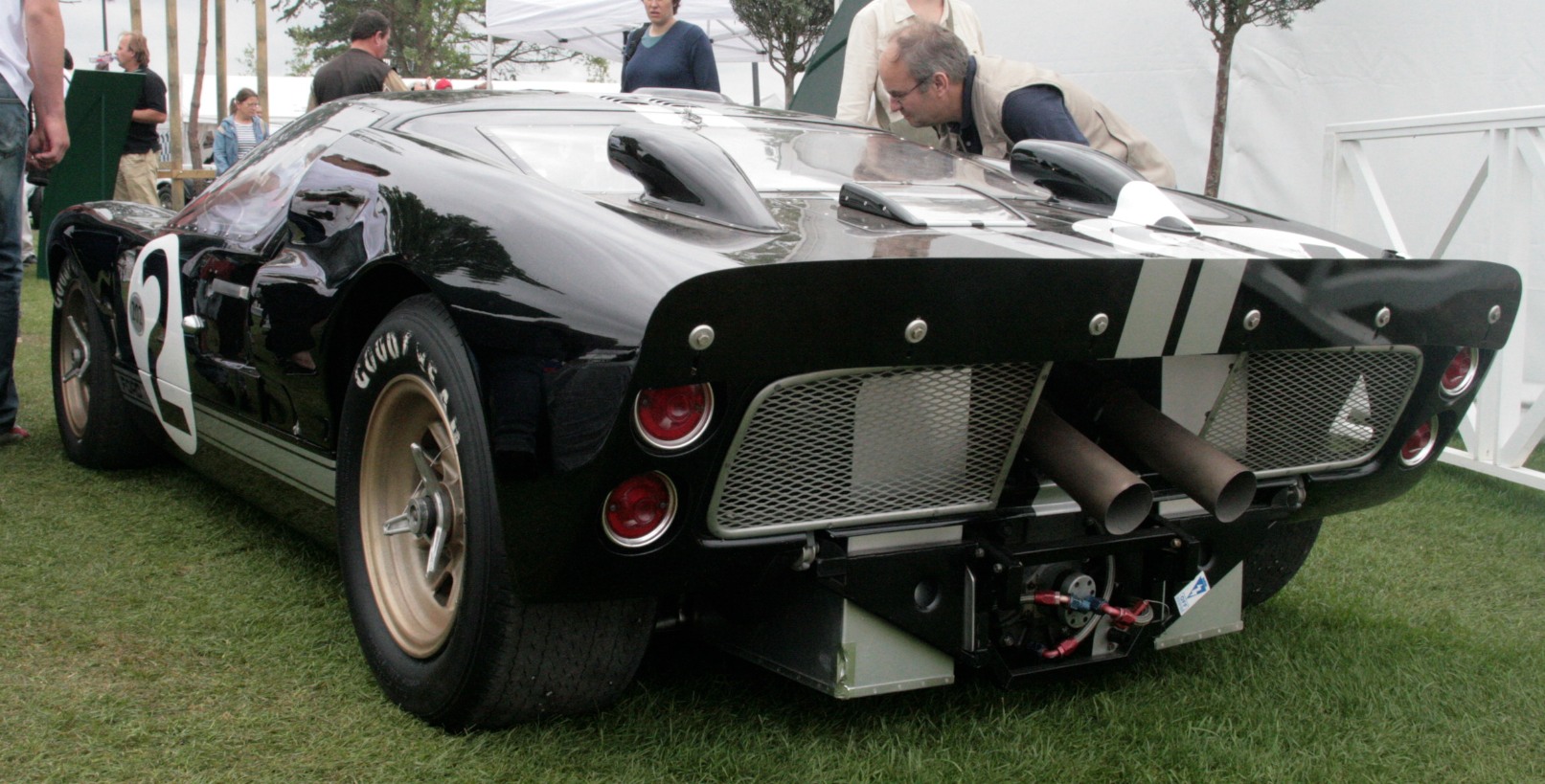

Brian Stewart
Thanks Dave. Original one here looks taller, but that may be just a trick of the light.

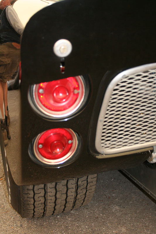

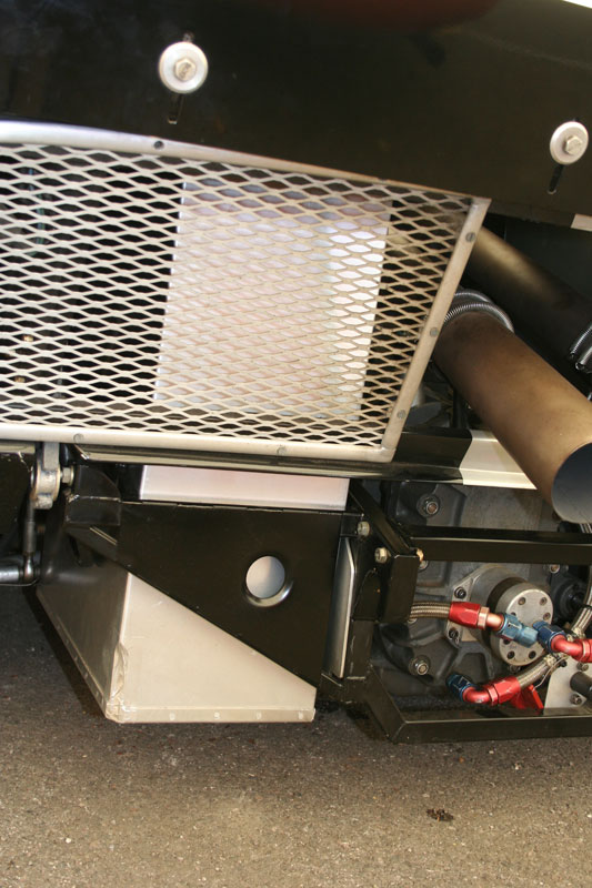

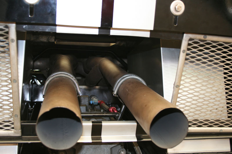

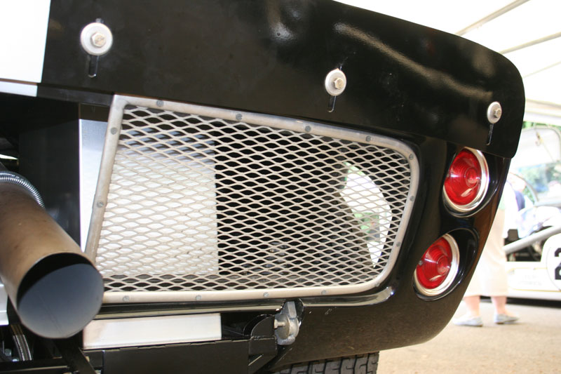

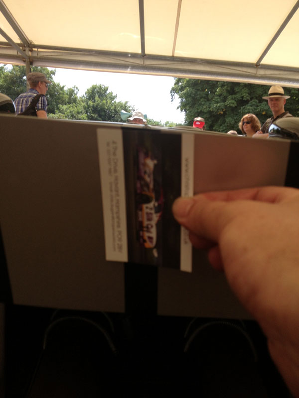

Measurements taken off of 1046 give a spoiler height of 5" at the centre (between the silver stripes). Fixing slots are equidistant with outside ones on the centreline of the rear lights.
The card in the attached image I used to measure is 95mm in length if you want to try and scale. Also a few close up pictures I took if they are of interest.
Regards
Dave
