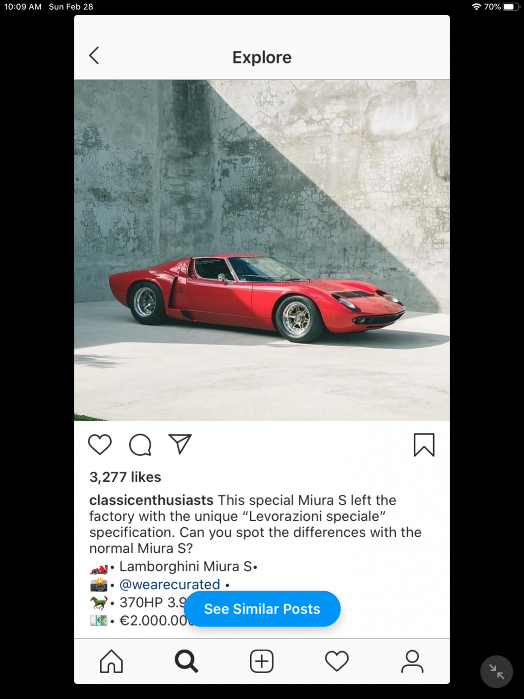

saw another post on gram today, this one is cool looking.I never noticed this car till you posted this thread now I always see pics of them lol.
