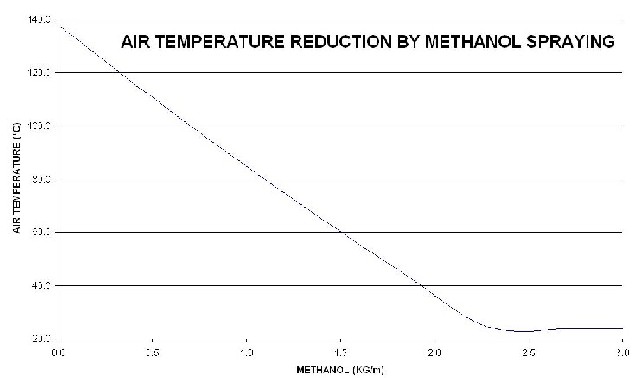

Ron, I was studying the effects of methanol injection on charge air temps awhile back, and I asked a process engineer buddy of mine to model it in a program called HYSIS, which is a high end process simulator program that we use in the petrochem industry.
The conditions I gave him were 25kg/min of charge air flow, at a pressure of 1.0 barg (about 15 psi of boost), and an entry temperature of 140 degrees C. Ambient air temperature was 25 degrees C. (This airflow figure represents the WOT requirements of a 4.0 litre Lexus motor.)
The graph below shows the reduction in air temperature available vs the amount of methanol injected. I didn't ask him to run the same simulation with a 50/50 solution of methanol & water, but I think I will, just for curiosity.
The graph didn't translate from Excel to JPG very well, but FYI, 1.5 kg/min of methanol injection comes out to an 80 degree C drop in charge air temperature. I know that 1.5 kg/min of methanol sounds like a lot, but keep in mind, this air flow rate is at 6500 RPM for a solid minute, and that's a pretty long time to stay in boost....
I would think you could inject either pre or post supercharger with pretty good results. Post supercharger is obviously safer, but harder to get to. Presupercharger would probably work OK for straight methanol, or methanol with just a bit of water in it. Obviously you don't want the stuff puddling in the supercharger.
As I'm sure you're already aware, the methanol will also provide additional fueling, but its AFR for a Lambda of 1.0 is completely different than gasoline, so it may confuse your O2 sensor and ECU. Too, it does some nasty stuff to aluminum, seals, and o-rings when it's left in the system, so many folks use an upper cylinder lubricant with their M/W "cocktails" to reduce its corrosive and drying effects.

Nice plots with the MeOH injection. It seems to work well on the Lightning/Cobras, as long as one either increases boost or timing to take advantage of the cooling. If you leave everything the same and just inject the MeOH you don't see much gain at all, if any, according to the dyno test that a few have posted on the Lightning forums. You'd expect that too, since the point of MeOH injection is to allow a more aggressive state of tune for the motor.
I've only seen pre-injection with the Ford mod motors with Eaton chargers. What I had worked up for my Lotus would be after the turbo with a check valve so the turbo wouldn't pressurize my pump/reservoir!
