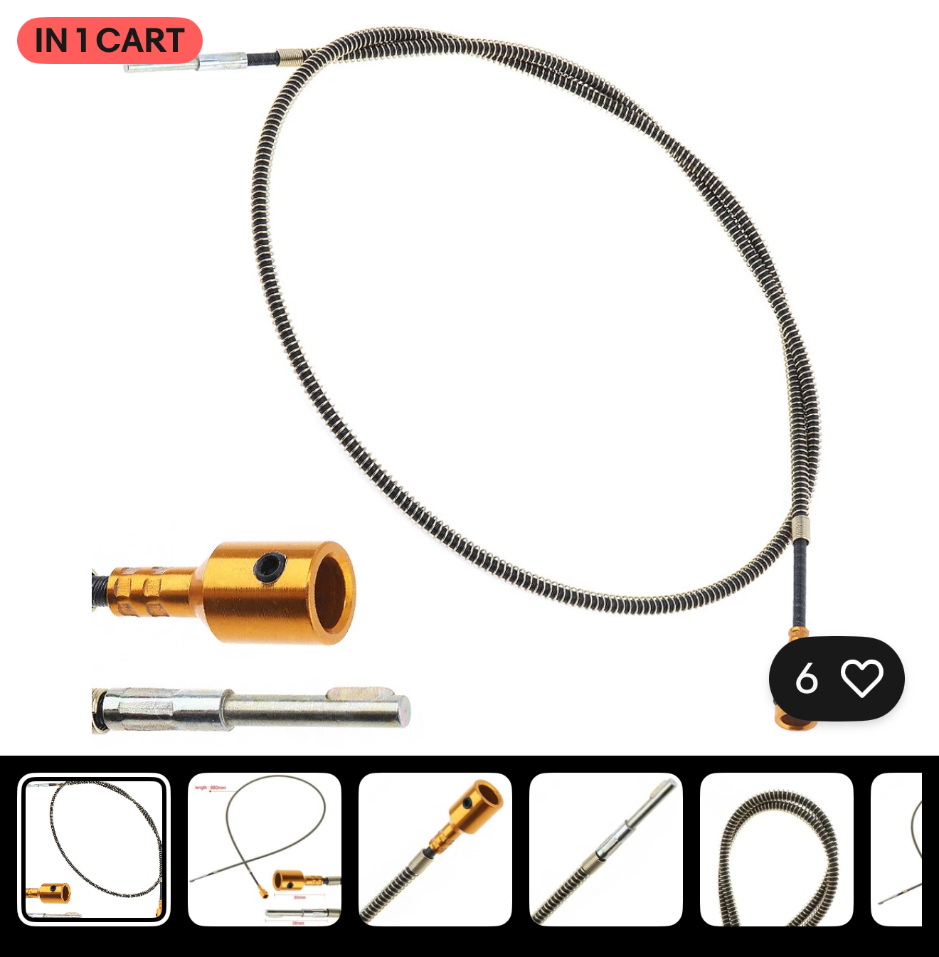

Paul, my plan is to use a flex shaft like found on rotary tools to extend the knob rather than trying to relocate the temperature control unit. I will fix the temp knob under the dash and run the cable through to the door pocket. Just need to find one the right length and then solder on the appropriate adapters. Might also ask cable suppliers to make one for me. Cheers, Randy

Maybe this will work.
