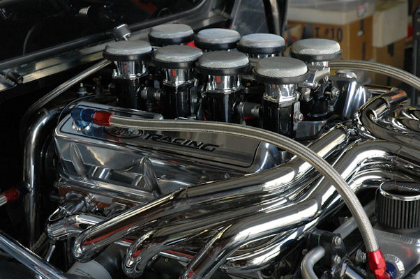

Hello All, I'm looking to buy air filters for my vel-stacks. I found one place in AU that can help, but I would like to buy in the US if possible. I contacted Morrison but got no reply.
Also, I'm looking for ideas on how to synchronize these throttle bodies. I was thinking of using feeler gauges or welding tip cleaners to set the plates working off the # 1 TB as it is the idle return stop. That would give me a base setting.
My feeling is they should be adjusted while running. I purchased a UNI-SYN tool that is held over the stacks and adjust the plates till the float on the tool is the same for each cyl. Problem is, I don't see any clear way to move the shafts while running. One thing I could do is cut a small slot in the tops of the shafts to use a small screwdriver. Kinda cobbie and def a last resort.
There is a good amount of the shaft sticking out the bottom of the TB's but the valve covers must come off to access. A mess in the making! and some burnt fingers to boot!
Lastly, I need to sync the two banks. My thought is to use two dial indicators somewhere on the linkages and adjust till both banks move at the same time.

Here's a pic

Patrick, This guy will custom make screens for any size air horn, and for a reasonable price. He's run them on a dyno and the hp loss is under 10 hp compared to the Weber screens that rob about 40 hp. His name is Bill, Bills B Racing, email is
[email protected] I've done a lot of business with him, he does nice work and ships when he promises. You need to give him the air horn diameter, height of the lip, space between horns, how far the drivers side horn is from the bulkhead and email that picture as well. Sweet looking setup! Hope this helps, Al

I didn't look at the picture previously. Not exactly easy to precisely adjust and almost impossible while running unless as you say you cut a slot in each shaft.
Personally I'd be tempted to remove the linkage "bars" and join each activating 'arm' with some kind of adjuster. At its simplest a few bits of threaded square and some threaded bar. Would need to have both LH and RH threads though which makes it rather a pain.
X2 on the threaded shafts and rose/heim joints..

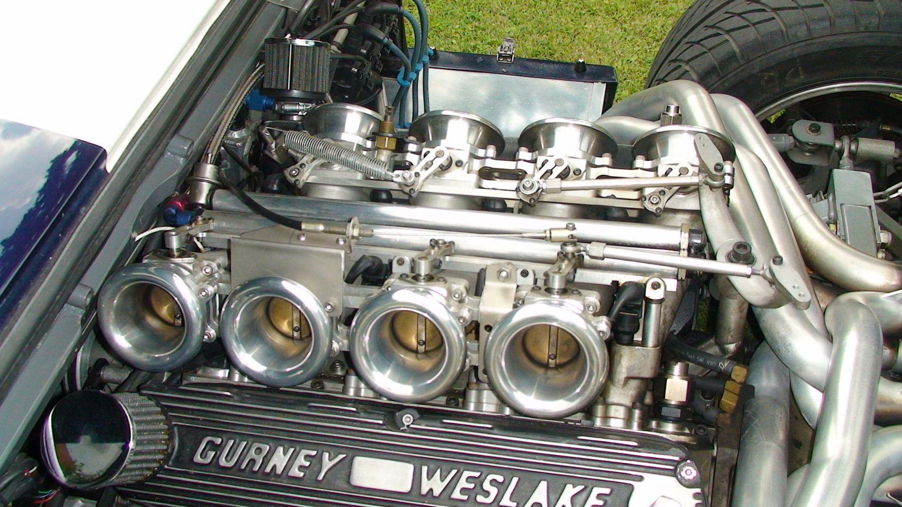

I have a manifold very similar if not the same and mine is adjustable at the arm clamped to the throttle shaft. So each butterfly can be adjusted individualy. I use a feeler blade so I can get the right feel but you can use a needle as David has sugested
and then balance them while running with a vacuum gauge. If you run them on a dyno you can use a thermocouple in each individual header pipe this gets the tunung spot on, but it means drilling a hole in each pipe. not always ideal I know.

Hi Patrick,
Adjustment is simple, run the engine at idle insert a vacuum gauage in each trumpet one at a time, loosen the clamp on the butterfly to adjust, tighten and move to the next, balance one side and then the other. I have the Morrison ITB on my cobra.
I wish I knew how to insert image, will figure that out and post.
