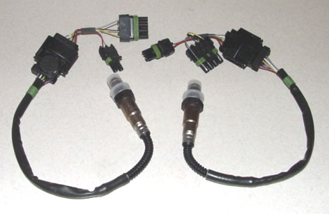

The Lambdas are Bosch LSU. I don't see any numbers on them. They have five wires on each one.
Here are a couple photos of my setup. These plugs were specially wired for the RF system.

If you are worried about wearing those out hersh, dont be, they are cheap, you can probably find them for about $50 usd. Unless it is the time the motec has allowed you to have that is programmed in the ecu that you are worried about wasting, i think that is expensive.
