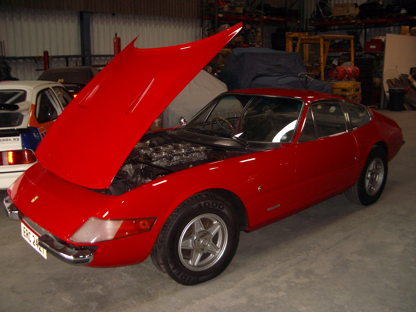

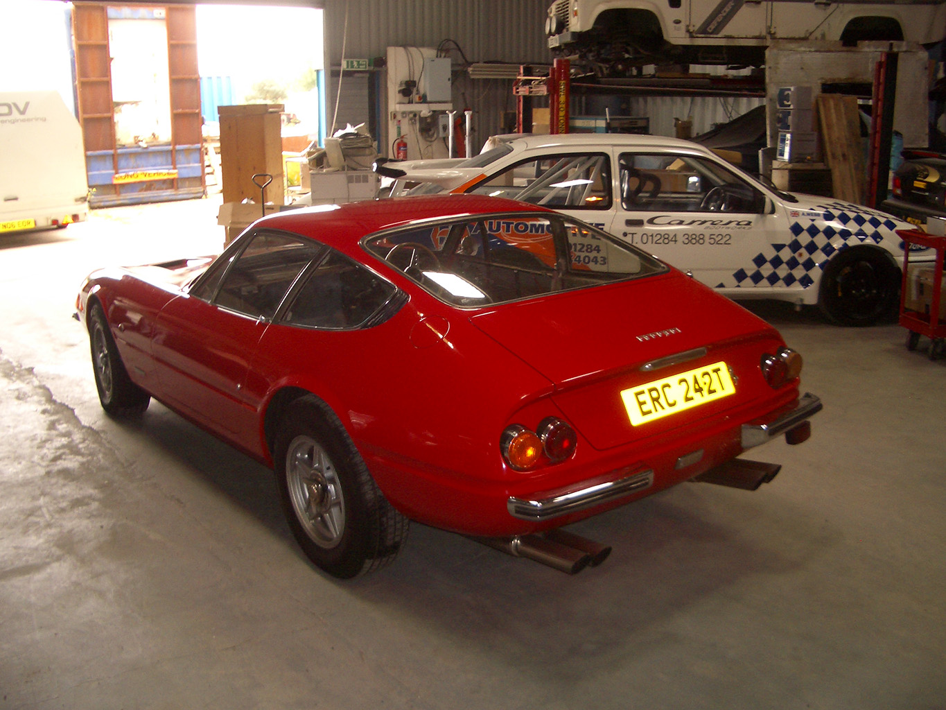

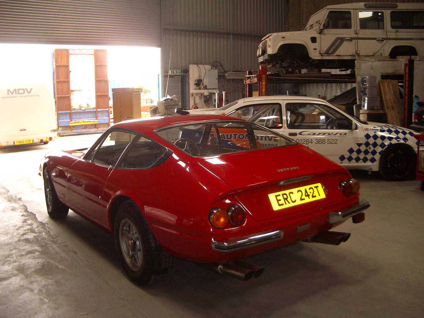

My car is one of the only six EG Autokraft Coupe Replicas built by Emilio Garcia. The EG Autokraft is without doubt the most accurate replica of the marque (Ferrari 365 GTB4 or Daytona as it was known), dimensions are exact and allow genuine Ferrari Daytona parts to be used if required. The EG Autokraft was the work of Emilio Garcia and Peter Jacobs, Emilio had been turning genuine Ferrari Daytona Coupes into Spyders for years and the next logical step was for him to engineer a replica based off the original cars he was modifying. He turned to Peter Jacobs to make the molds and bodies, Peter was the man who built the bodies for the RS200 Ford Rally car and the GTD, a very well know GT40 replica. The EG bodies were Kevlar reinforced composite and only 6 coupe bodies were known to have been produced. The chassis is an authentic tube replica of the original Ferrari Daytona, but the car utilizes V12 Jaguar mechanical components (V12 Engine, gearbox, steering, suspension and axles). MY car is dismantled, see story and pictures below. Im now based in the US whilst the car is located in the UK.
I’ve owned this car for many years, driven it occasionally and then decided to create an even more accurate version of the Ferrari Daytona with this car. I was very happy with the exterior look, the body is in amazing shape with high quality finish of both panels and paint. However the interior was not ‘authentic’ enough for me (it used the Jaguar instruments and switchgear). So I set about collecting the complete interior parts from an original Ferrari Daytona, it’s taken me 5 years to collect all the parts but now I have everything that is required to make this the most accurate Ferrari Daytona Coupe replica ever built – every switch and original instrument gauge, including a complete Ferrari steering column and NOS Daytona steering wheel! I even have the rare material that the dash was originally finished in – a type of Alcantara called ‘fuzzy felt’ that I found in Italy. The fibreglass dash was re-shaped to more accurately represent the original Ferrari and allow for fitment of the original gauges as well as replicating the air-con plastic box which I had vacuum formed. I also have many other original Ferrari Daytona parts, such as Cromodora wheels, complete headlights cans, seals and lenses, taillights, glass, badging, grills, bumpers, door locks and latches etc. I was in the process of changing the colour combinations of the car – I'm planning to have a silver exterior and blue interior, and as such had already had the seats re-trimmed in blue Connolly hide (I have a number of hides specially coloured by Connolly Leather in the UK). The seats are also very authentic replicas of the original seat even down to the inner frames and headrest and I even had the inserts accurately copied with a special press tool I had machined.
The engine is a Jaguar V12, with the very hard to find set of 6 vintage downdraft Webers, Hayward & Scott stainless steel tubular race headers and authentic Ferrari Daytona back boxes with quad outlets. The gearbox is a manual Getrag 5 speed, and the linkage for the shifter has been engineered to replicate the offset of the original Daytona mechanism. I had specially commissioned aluminium castings to replicate the cam covers of the original Daytona, which sit on top of the existing Jaguar cam covers. There is a brand new wiring loom, once again, that I had specially built specifically for this car. The brakes have been completely overhauled and many suspension parts re-plated. Still quite a lot to do to get this project back together and on the road again......

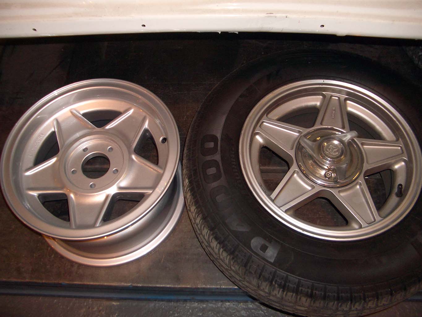

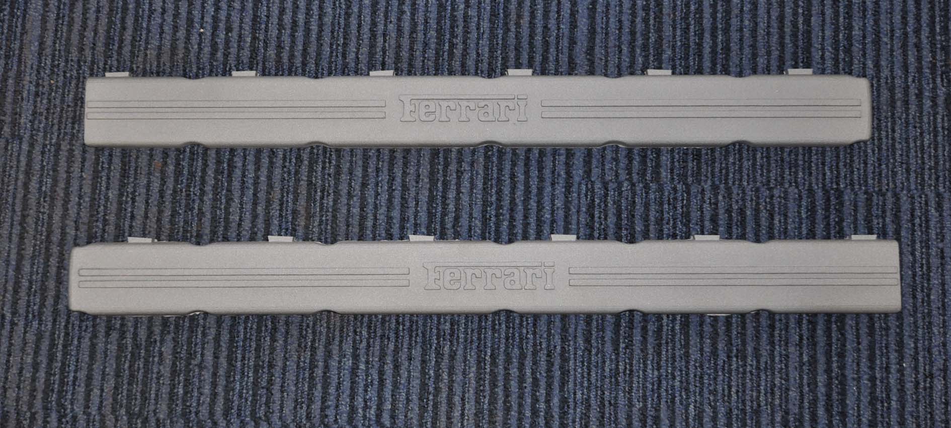

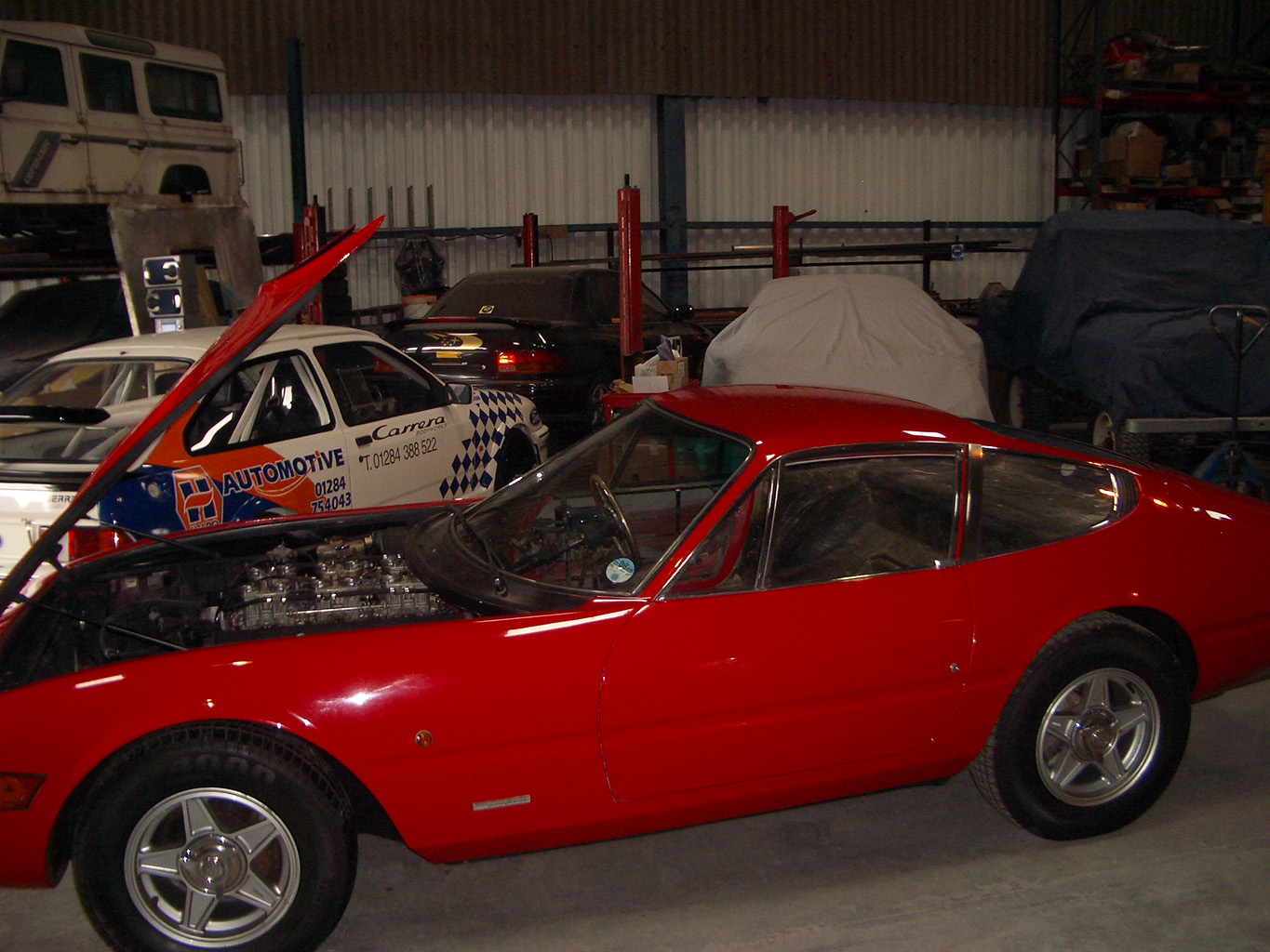

Here are some the parts mentioned above and ongoing modification of the car......

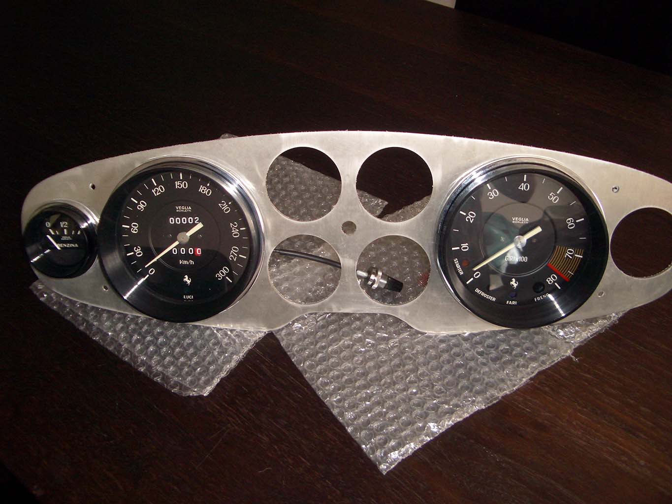

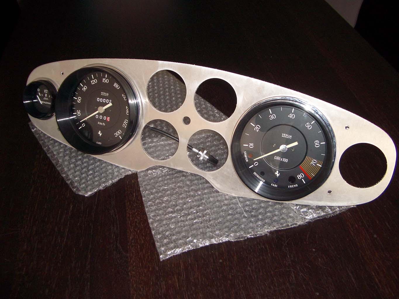

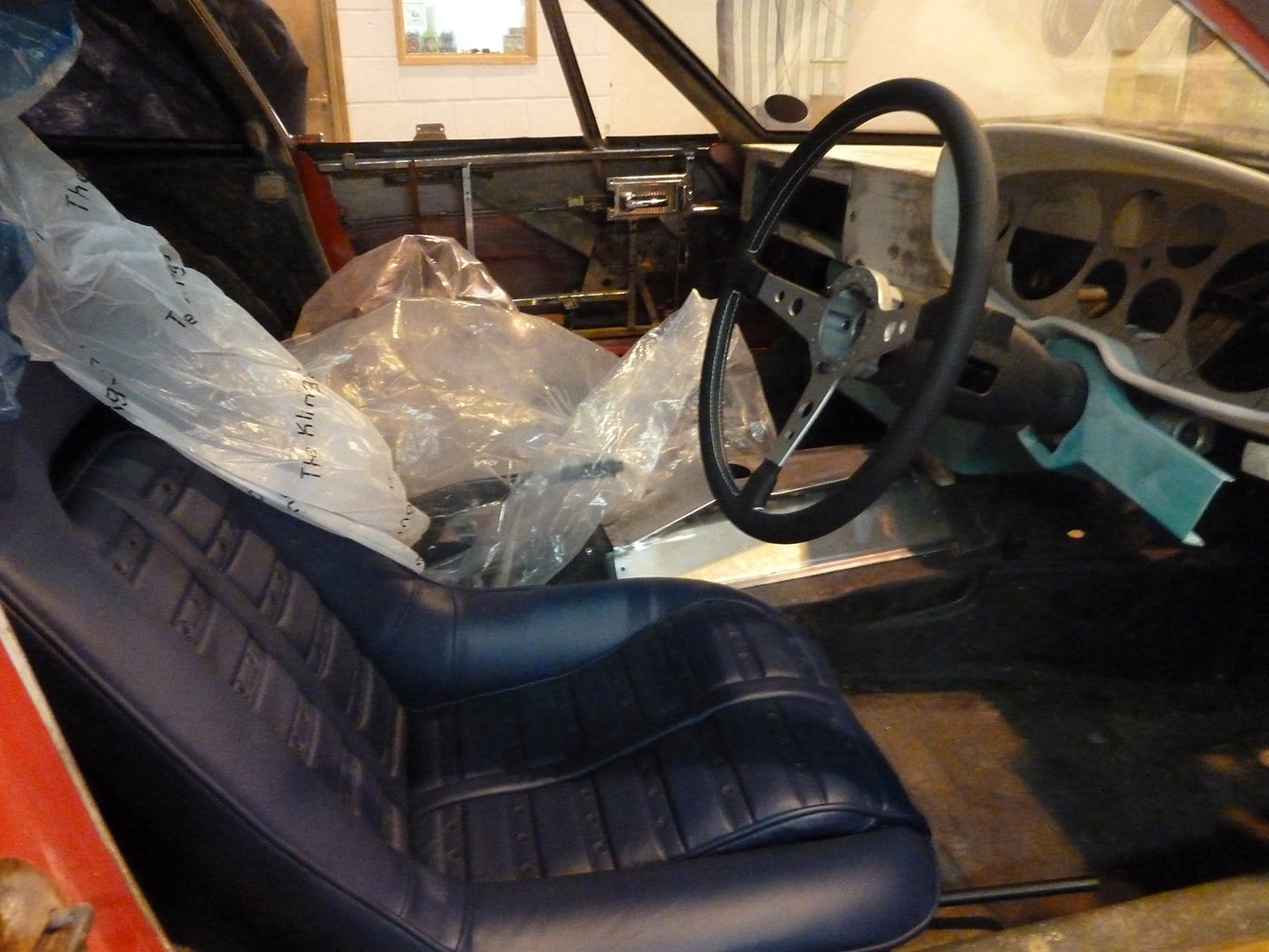

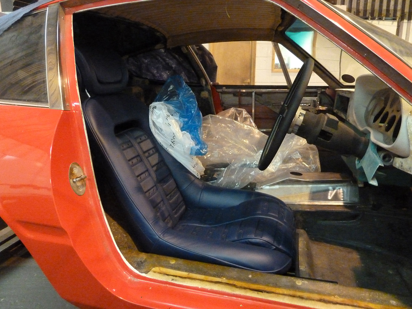

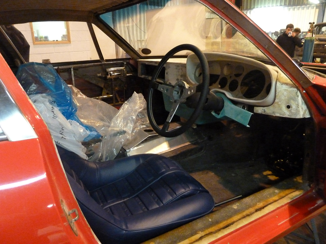

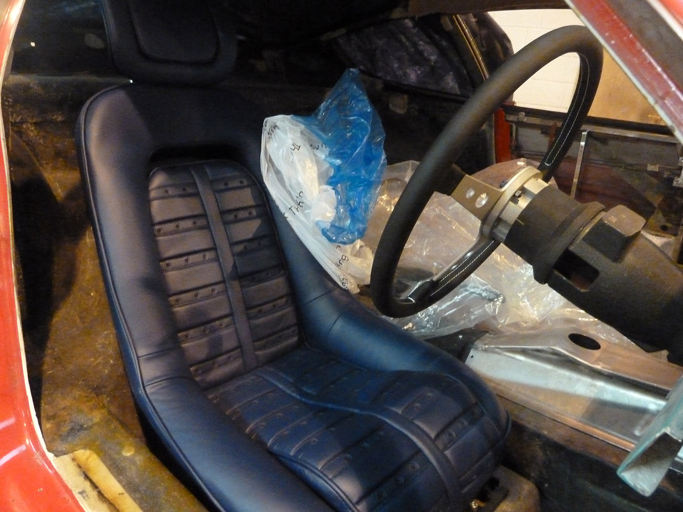

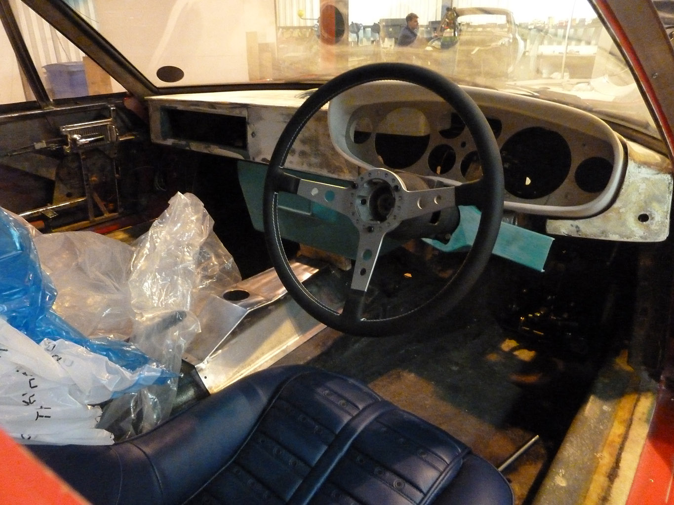

The interior is coming along nicely and the addition of the original Ferrari steering column, wheel and gauge pack make a huge difference to the authenticity of the car.....

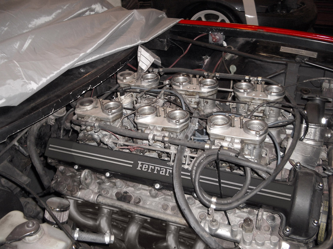

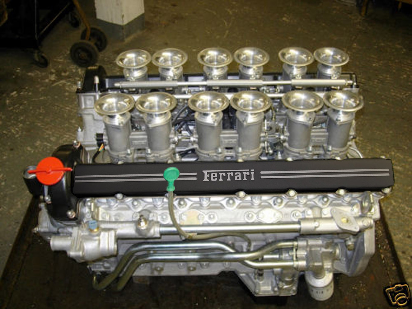

I did a couple of Photoshop mock-ups of the engine with the new cam covers I had cast. The first image is the engine with the Weber carbs, currently on the engine, and the second image is a mock-up of something I'm considering, which was to convert to injection to make the drivability a little better. The carbs, when you have 6, can be a little temperamental! The first image is also prior to strip down.......
Chris

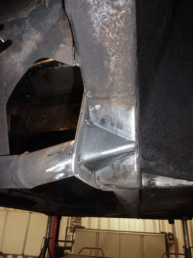

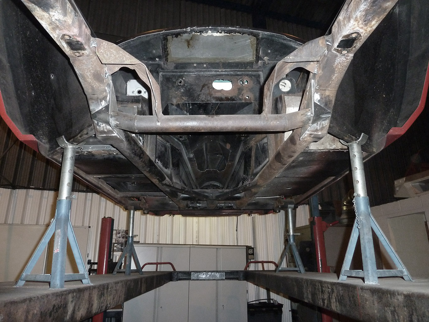

When I was using the car prior to restoration and rebuild, it had a modified Jaguar V12 automatic gearbox which wasn't ideal and also the engine sat too far back in the engine bay that the final two throttle intakes of the Webers were under the cowl (not good if they back fire!!). So these were also a couple of the things I wanted to change when the restoration was undertaken, and as I’m not very good welding or the mechanical side of the business, I commissioned a small Engineering firm to do all the work for me. This firm (MDV Specialist Engineering in the UK) specialises in rally car builds and one-off special performance cars so they were perfect for this kind of work. Pete, the owner, is a brilliant engineer, fabricator, performance guru and great bloke to boot…..
MDV - Home
Chris

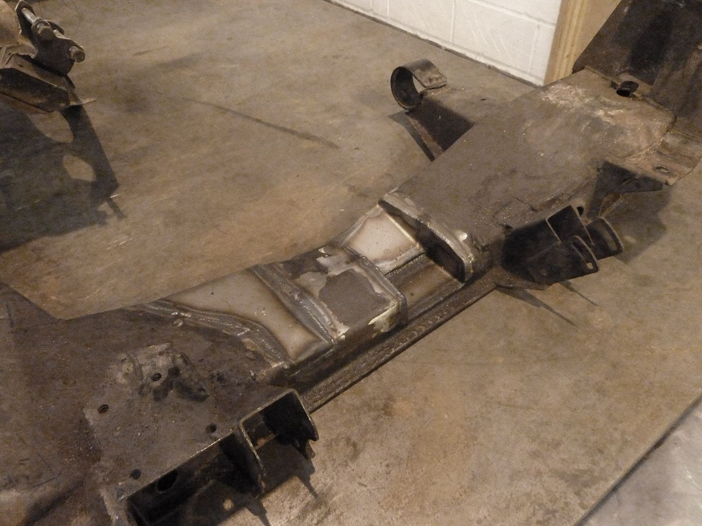

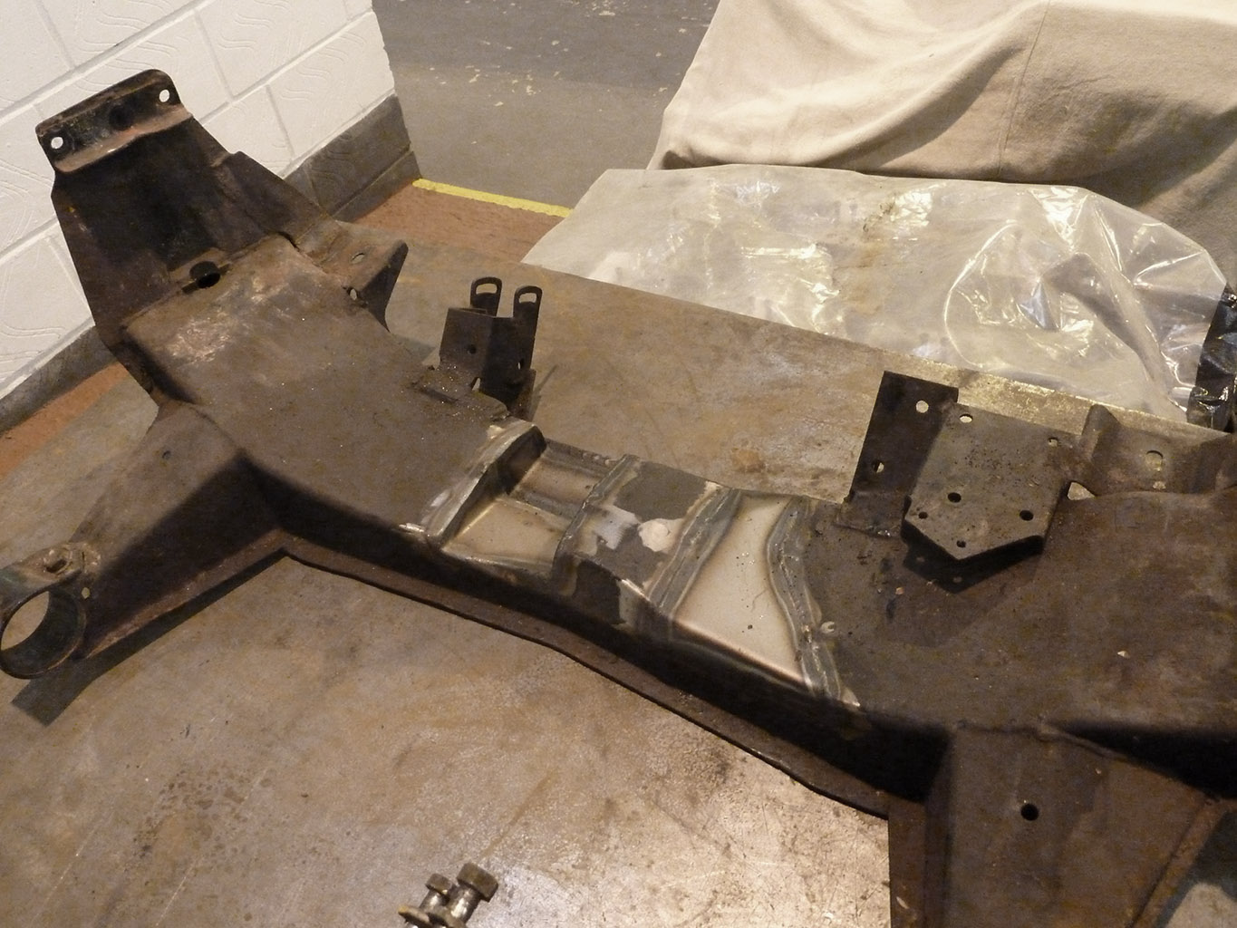

The conversion from automatic to a five speed manual would change the character of the car immensely and would better suit the nature of the car, just finding the relevant parts wouldn't be easy as they never made many manual V12 Jaguars! As mentioned, we also moved the engine forward approximately 25mm to give clearance to the back Webers but this move dictated other modification, such as revisions to the stamped Jaguar cross beam, engine mount location and steering column. MDV did a great job of modifying all the chassis pieces and the engine slots into location beautifully, with sufficient clearance to not cause issues.

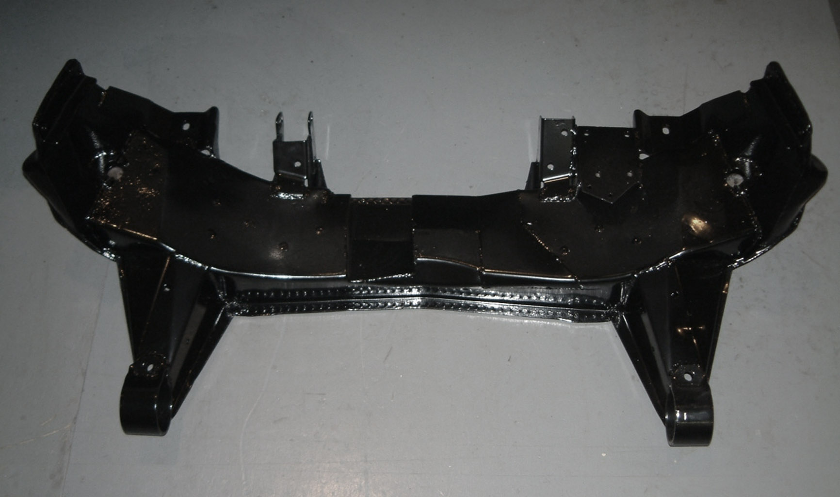

Here is the stamped beam, with modifications required to clear the repositioned engine.
Chris

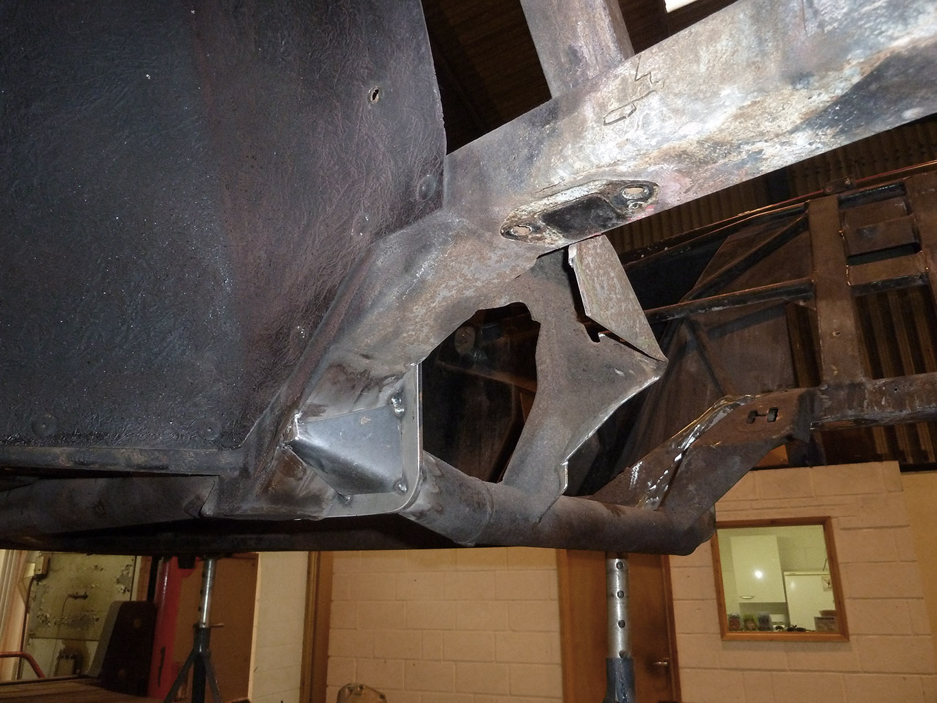

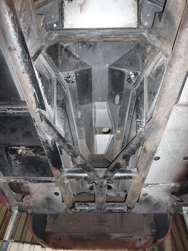

The modifications to the engine mounts and structural supports.
Chris

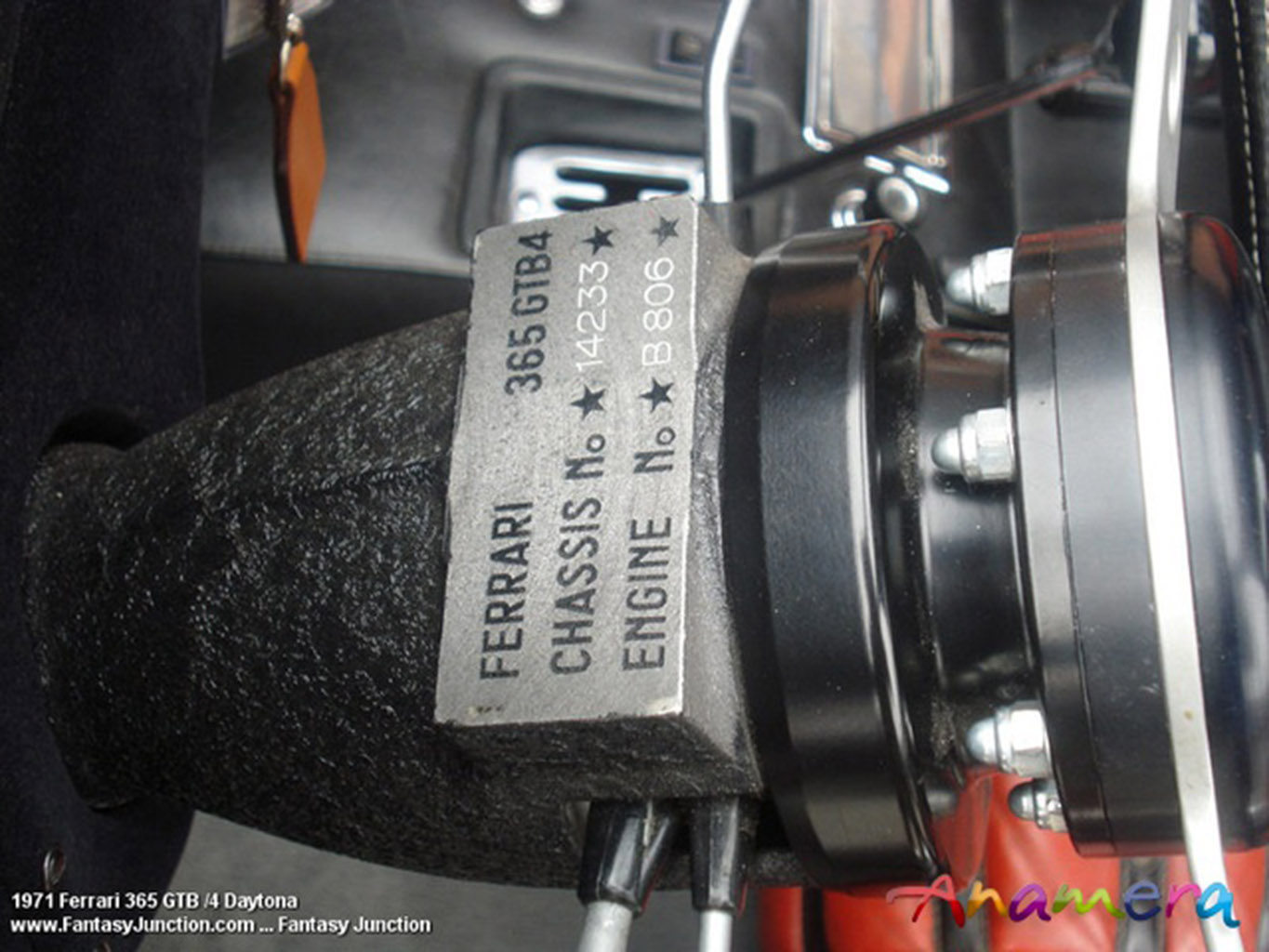

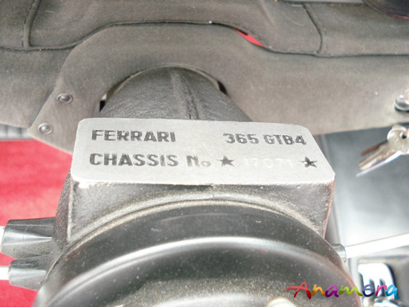

The original steering column of the car was a Jaguar V12 column, I wanted to change this, therefore I sourced a Ferrari 400 column - the same exact part as used in the Ferrari Daytona. MDV mounted the column and modified it to fit up to the Jaguar steering box. The NOS Daytona steering wheel now fits perfectly to the column and everything looks as an original Ferrari Daytona. For those that know the original Ferrari Daytona, the chassis numbers are embossed on the top of the steering column surround - this once says ‘Ferrari 400’ - I will probably need to change this to ‘Ferrari 365’ as some point.
Here's a couple of original Ferrari Daytona columns......
Chris

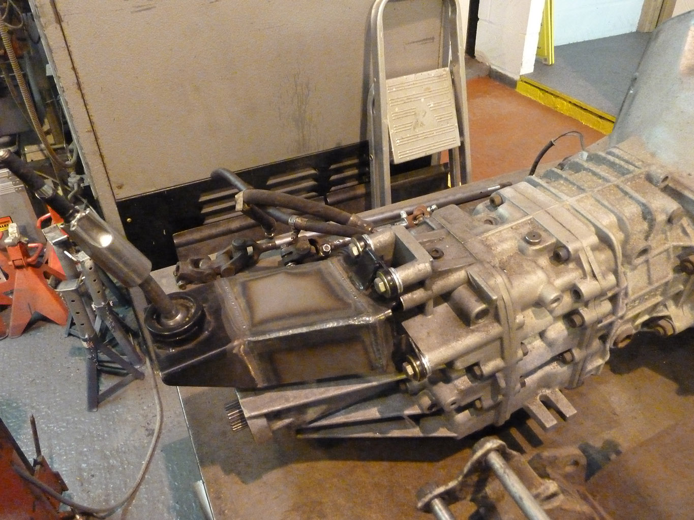

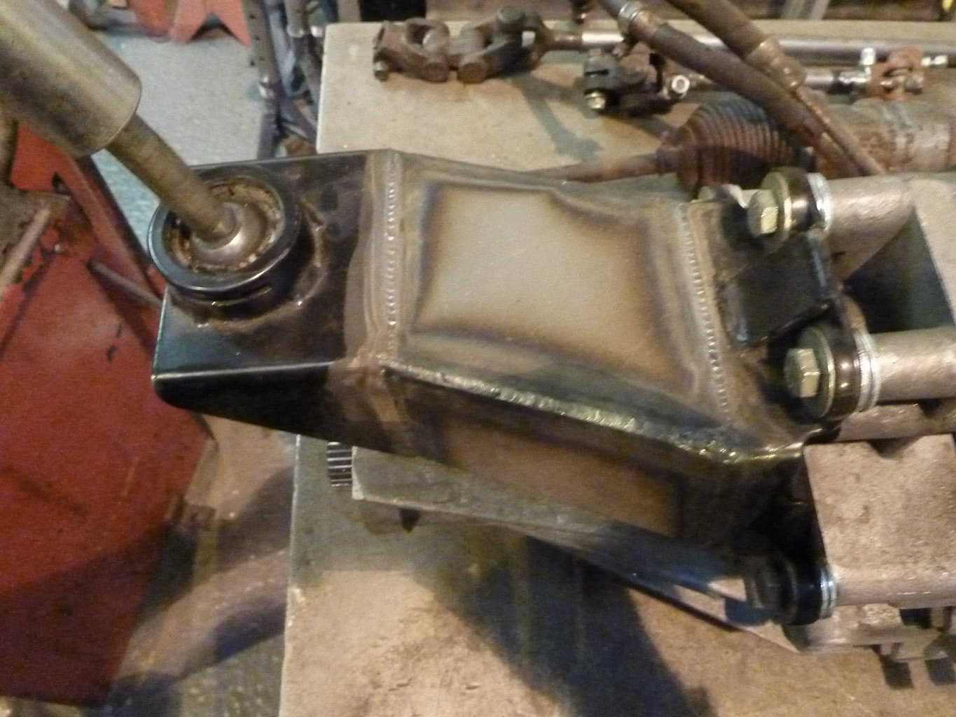

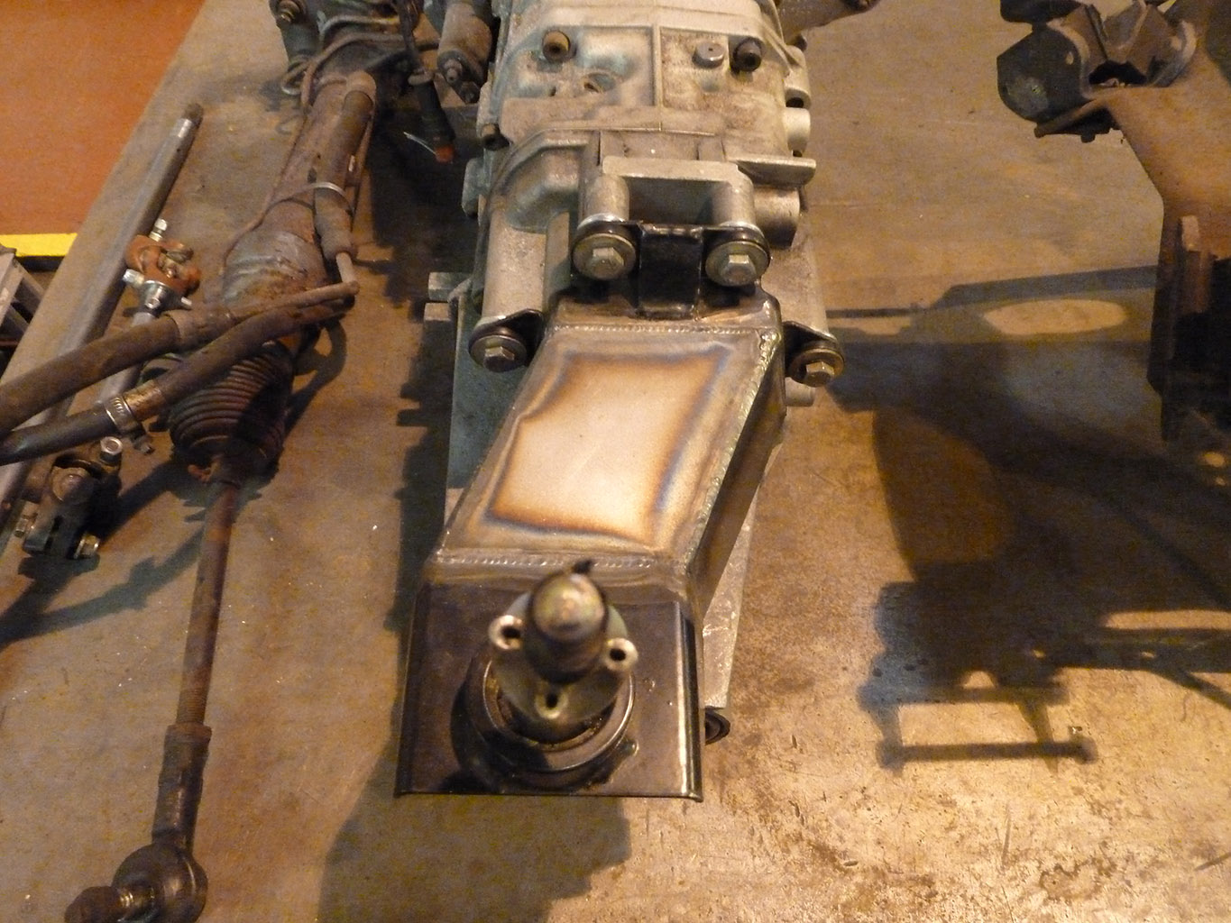

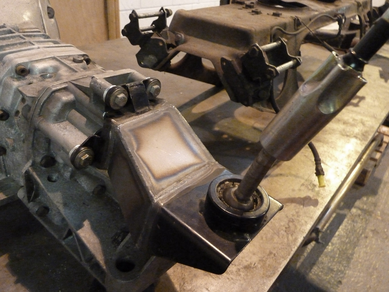

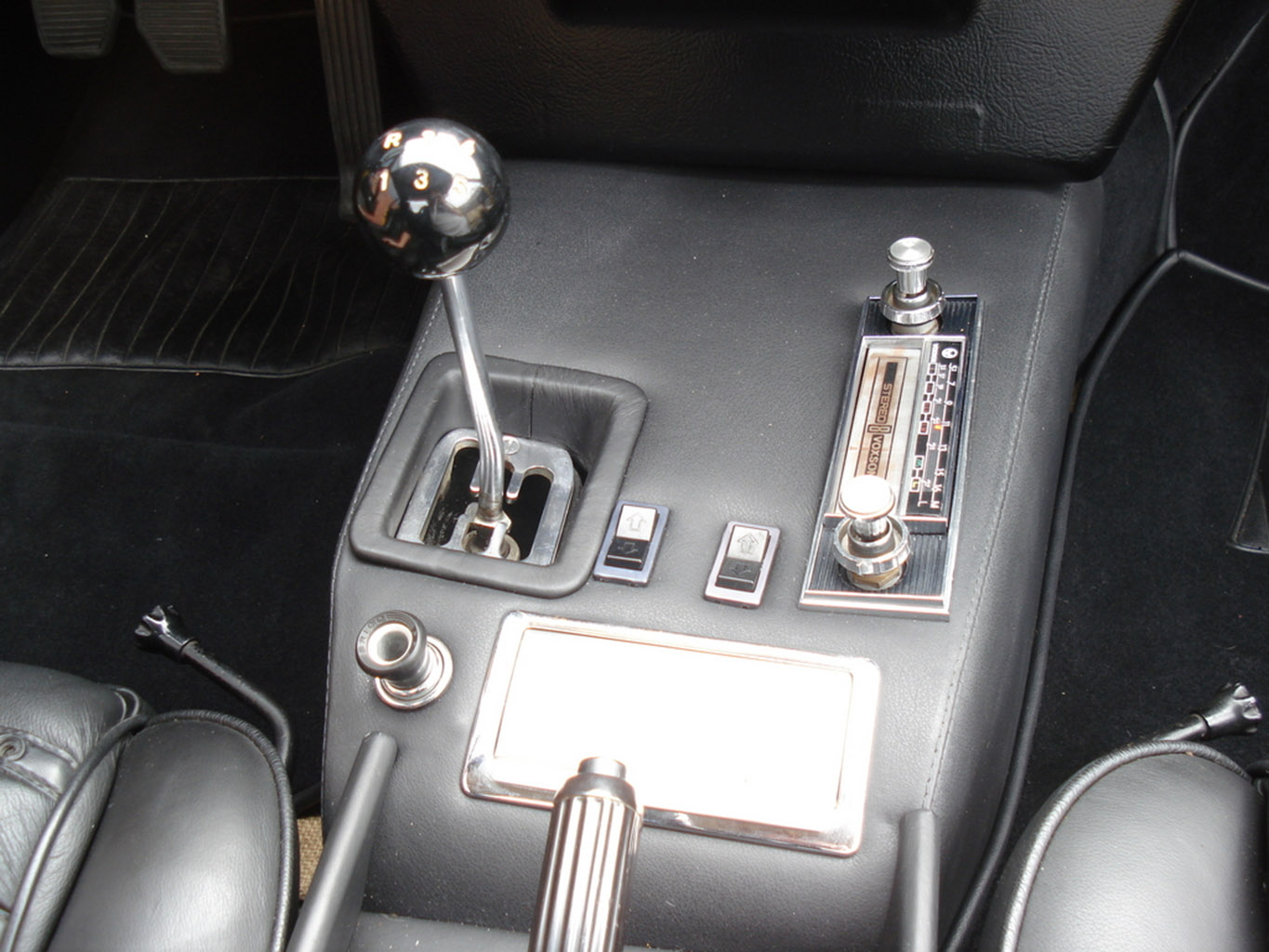

The gearbox and associated parts were sourced and mated to the rear of the engine - and we wanted to ensure the final gearshift mechanism exited in the same location as an original Ferrari Daytona. For those that aren't familiar with the Daytona - it is a front engined car with rear transaxle gearbox, and as such the shifter is located offset to the left to allow the drive shaft to pass through the tunnel centrally. Replicating this position was important to ensure the authenticity of the car I was modifying - and as my car is front engined with conventional gearbox mated to the back of the engine an adaption of the final linkage would be necessary. Once again - MDV did a great job of correctly locating the shifter and modifying the gear linkage appropriately.
Here's an original Ferrari Daytona with offset gear shifter - all Daytona's, be it LHD or RHD are offset to the left.
Chris
The Getrag gearbox with new revised linkage and offset positioning for the shifter.
Chris

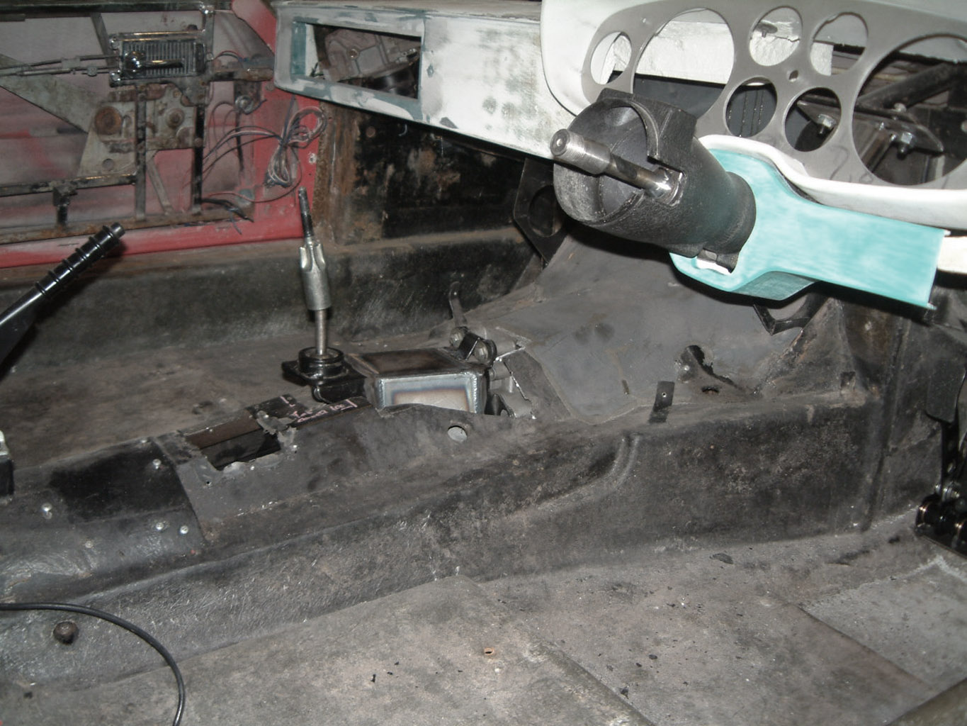

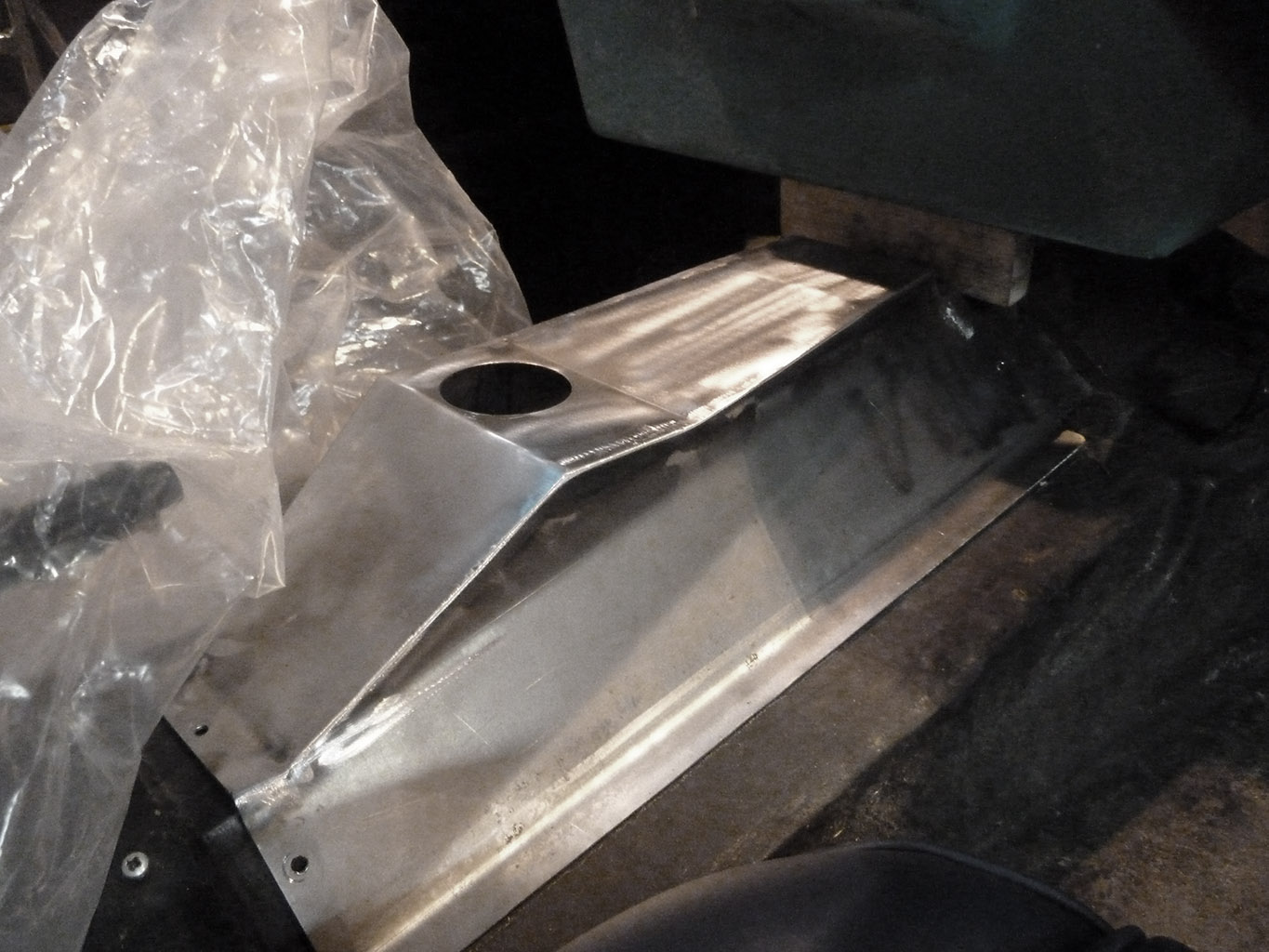

Modified tunnel and offset hole for shifter.
Chris
