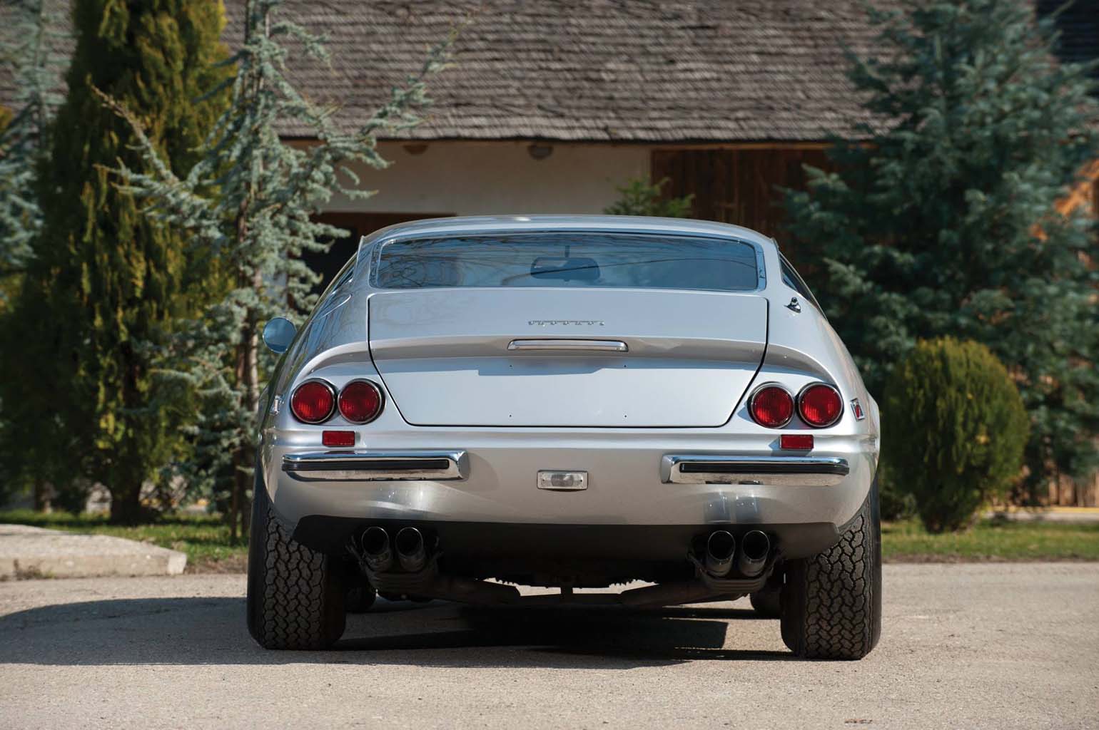

Some inspiration....... as I said, these cars look amazing in silver!!
Chris

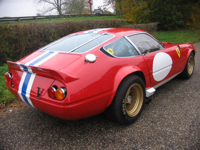

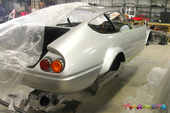

I know this is an unusual project, and probably not the kind of car that would appeal to the more ‘race’ inspired builders that frequent these pages. But I would love to hear some comments, feedback and general input into this restoration/build. I’m currently at a stage with this car where I could go a couple of ways for the final execution - build an exact copy of the production Ferrari Daytona car - this being a solution that would make for a very ‘usable’ and rare street car. Or, build a race car replica of the Ferrari 365 GTB/4C Daytona Competizione – creating a pretty unique track day car unlike anything currently available – still streetable but with a different character completely.
Let me know your thoughts…….

My .02 Chris, where do you think you'll get more use, fun, enjoyment from all the hard work that will go into the finished product? When you answer that you'll have most of what you need. Personally, I've always loved raced inspired cars so I'd probably go with the track inspired version. Something else to consider....what would your "better half" enjoy more? Assuming they'll be with you some of the time.
Hi Jimmy,
I already have two vintage race cars and another couple of weekend cars, so my options are pretty open regarding this one. I guess it's probably more a decision about which direction would ultimately add value to the car if I ever decided to move it on.......
Chris
And the 'better half' would probably say I have enough cars and I should get rid of this one - so best not to ask her!!!
Chris

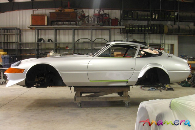

I bought this car a few years ago - because I absolutely love the purest proportion, knife like surface execution and delicate detailing of the Daytona and it was the last beautiful front-engined Ferrari in my humble opinion. I couldn't afford a 'real' Daytona - even more so now that the coupes are fetching $800,000, and this was as good way to experience that purest form and V12 power without the worry and cost of owning the real deal. However, I'm also passionate about racing (no great driver here, just a bloke that likes the whole racing scene and going somewhat fast occasionally). So the thought of converting this car to 'race' spec is very appealing. But being a realist, I've already spent more money on this car than it's ever going to return to me - and at some point I will sell it for something else that grabs my attention, therefore I want to ensure I make the right decision for the next steps on the restoration/rebuild.

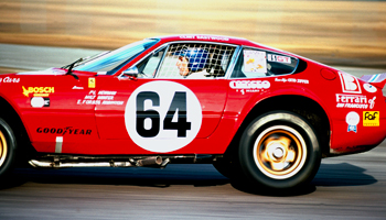

Thought you might like this - an awesome Ferrari Daytona GTB/4C driven at Daytona 24 Hours race in 1977 by three US drivers - Paul Newman, Elliot Forbes-Robinson and Milt Minter……
it’s amazing how the production car can sometimes look so delicate, but the race car looks very butch and aggressive just by the addition of some front end changes and extended wheel arches! - I really like the the look of the 9X15 and 11X15 inch Campagnolo wheels with vintage high wall tyres - very cool.

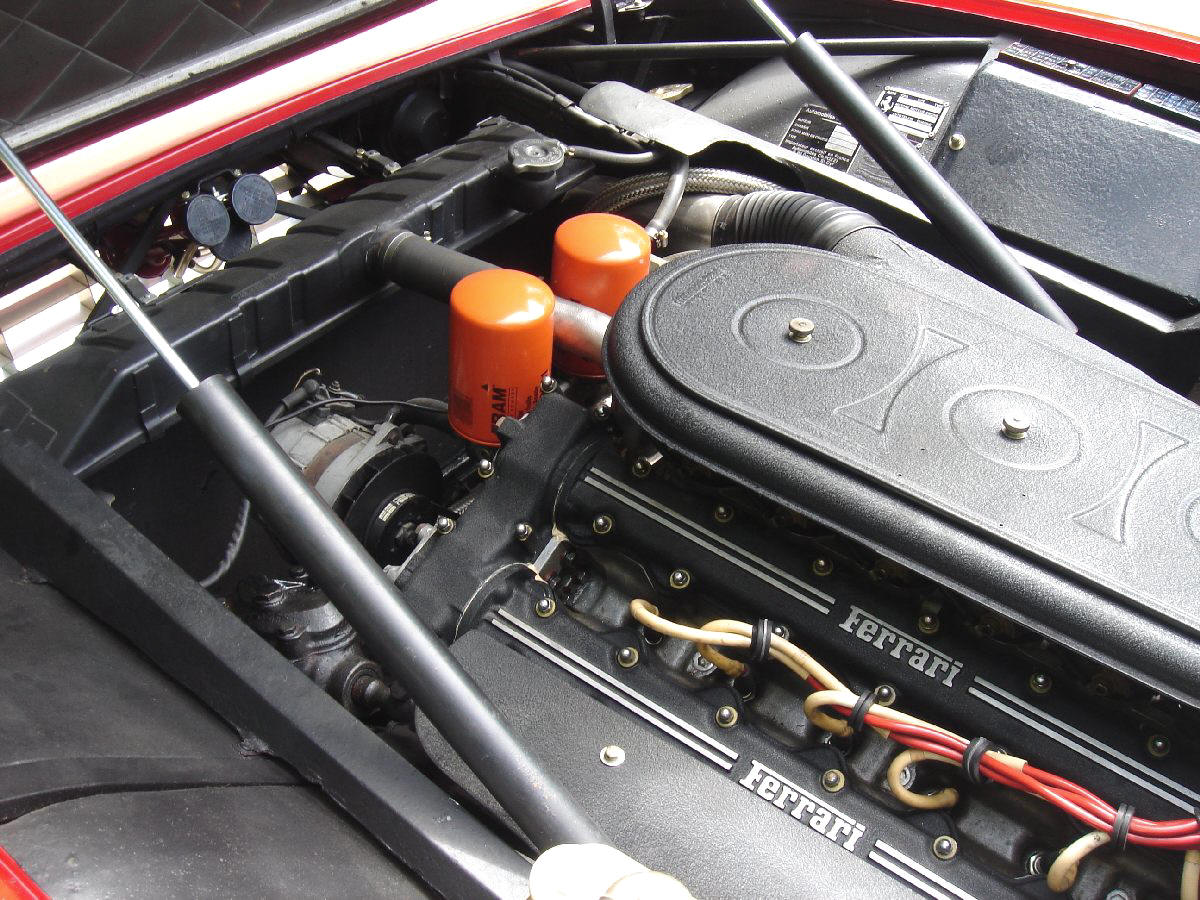

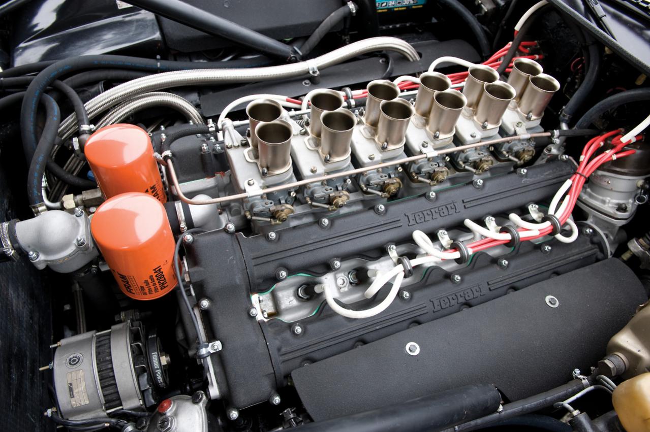

More detail -
I did look into swapping out the Jaguar V12 for a real Ferrari V12 and a couple of options were available - the cheapest being a Ferrari 400 V12, the most expensive I contemplated a Ferrari 456 or 550 V12. But this would have been a big undertaking, the fabrication to convert the chassis to accommodate these engines, gearbox and final drive systems would have been a huge hit on my wallet, as well as the initial cost of said Ferrari engine and box!! Also, just to setup and maintain these Ferrari engines is far more complex than the Jaguar V12 so I decided it was money not well spent. I therefore decided to try and make the Jaguar engine a little closer in appearance to the original Ferrari Daytona V12 motor.
The Weber carb setup on my engine looks pretty similar to the Ferrari so the next area that really stands out as ‘Jaguar’ was the cam covers - the Ferrari cam covers being very iconic. So I decided to recreate a cover that would look like the Ferrari cam tops and although the Jaguar is a single cam per side and the Ferrari is a twin cam, the change would be quite convincing. I did contemplate making complete new cam covers, but decided the fit and sealing of the original Jaguar covers might be difficult to recreate. Therefore I decided to create replica alloy cam covers to weld onto the original Jaguar aluminium covers.
Chris

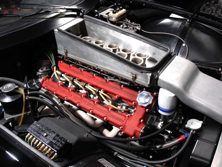

Some images of the original Ferrari Daytona engine - originally the cam tops were painted all black on Daytona production cars, but many owners had the two horizontal strips and the Ferrari script highlighted in silver - it looks much better with the highlighted script. As you can see from these images, the second cam top isn’t always easy to see when looking into the engine bay, so the single cam of the Jaguar is quite convincing at first glance.
Also of note - the race cars always had red cam covers - I believe this is where the nick name ‘red head’ came from when describing Ferrari race car engines.

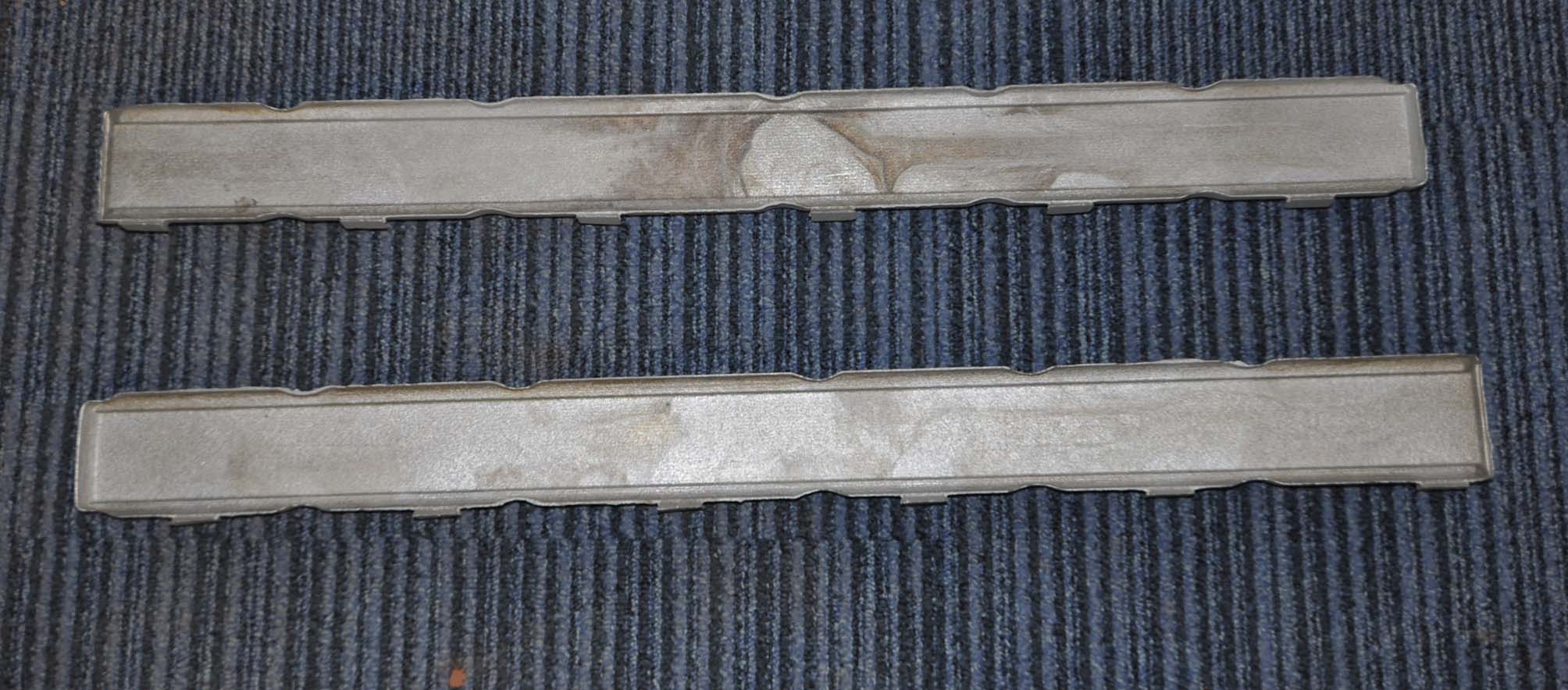

I scanned the original Jaguar covers and created a CAD model of the Ferrari cam tops to fit perfectly on top of the Jaguar parts. I measured the original Ferrari Daytona cam covers to get as close as possible to these parts. The final CAD data I created was then sent out and cast aluminium parts returned to me, these looking amazing in the raw metal. They slide over the top of the Jaguar cam covers and just need tig welding into location, powder coating to complete the look (another job I need to finish!) Not quite the Ferrari engine I had hoped to actually install in the car - but the Jaguar V12 is a much more affordable and useable motor for regular driving, and probably pretty close to the power of the Ferrari V12…..
