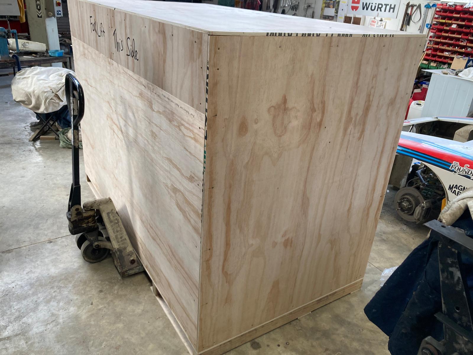

BIG CRATE! parts are boxed up at Carteroni

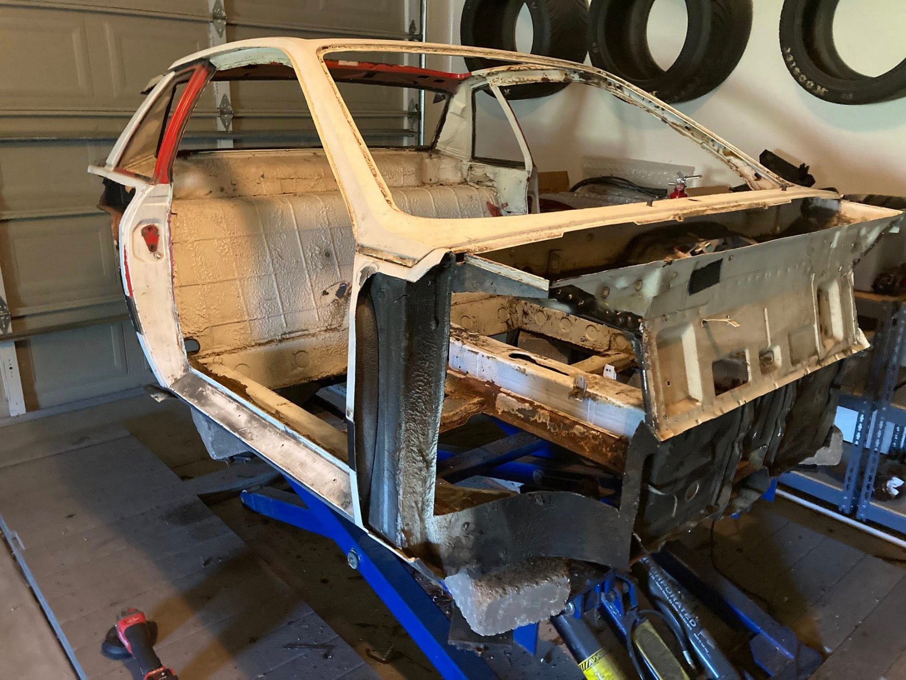

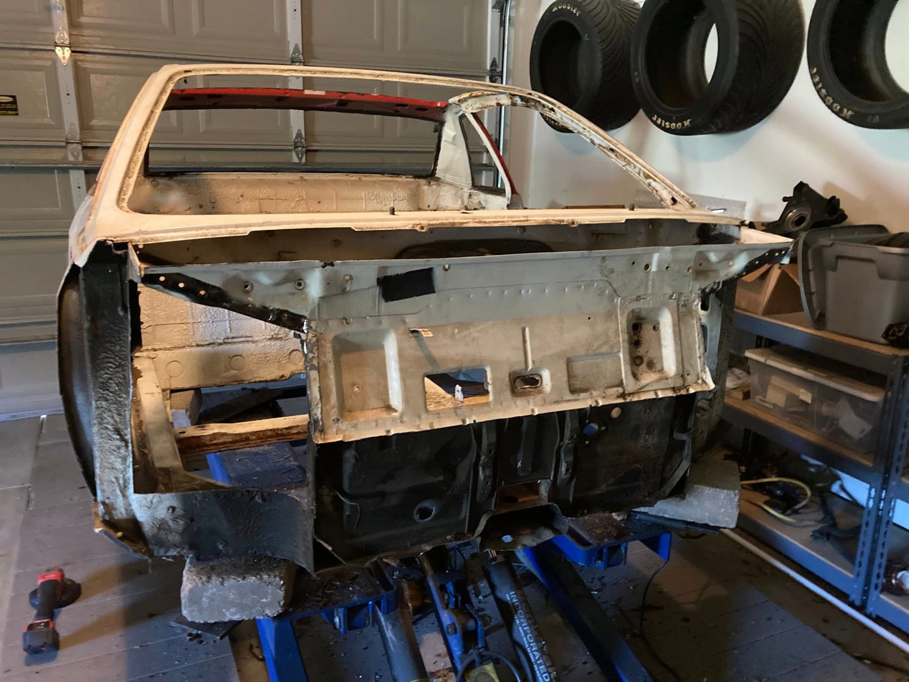

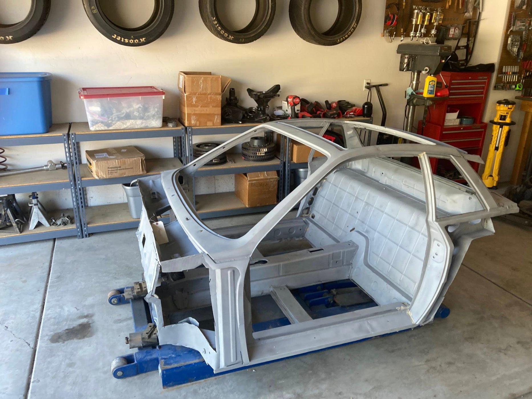

Started hogging out the wheel arches. I am going to stop there and try to get the chassis sandblasted this week or next.
Hi John, is there a specific reason you want to sandblast your chassis?
In Europe chemical stripping and cathodic dip coating becomes the industry standard (at least for high end restaurations)....
Not sure about avaiability in the US.
Please find a link for reference for what I'm talking about:
Hope the Google translator link works...
If not, here is the original link but German language only
It would be sad to see when you put so much effort into your built and later on the chassis get's eaten up by hidden corrosion (the chassis is basically the foundation of your 037 built).....
Just my 2 cent, not trying to be a smart ass......:rolleyes:

I appreciate your suggestion. I haven't found any places around here that do chemical removal. I will take another look though to make sure. Thanks!
I Europe chemical dipping is a pain in the ass afterwards as that chemical fluid isn't rinsed all the way and creates several issues even months after.
Thermal paint stripping ( in a vacuum controled container) is a better option these days in Europe.
Markus
SPRF40
JP,
Yes, thermal paint stripping is also very common but does not remove existing corrosion.... (which seems to be already present :().
At the end it is about the best solution for a given project.
From the website mentioned above:
-“chemical paint stripping” process consists of several steps and stages in different media. Only “paint stripping” in an immersion bath does not make technical sense and is not common practice
- The chemicals used in the paint stripping process are basically the same as today's pre-treatment in the vehicle manufacturers' paint shops, only longer / more intensive
- no acid is used for paint stripping
- Bodies that have been “chemically stripped” at Carblast Fahrzeugtechnik GmbH have, without exception, undergone the steps “paint stripping”, “washing”, “rust removal”, “passivation”, “washing”, ‘neutralization’
- a final “cathodic dip priming” is a mandatory procedural conclusion to the “chemical paint stripping/rust removal” process
Translated with DeepL.com (free version)
Their recommendation is to analyse the project and decide with the customer what to do.... (they also do the thermal stripping;))
Sorry, only in German....

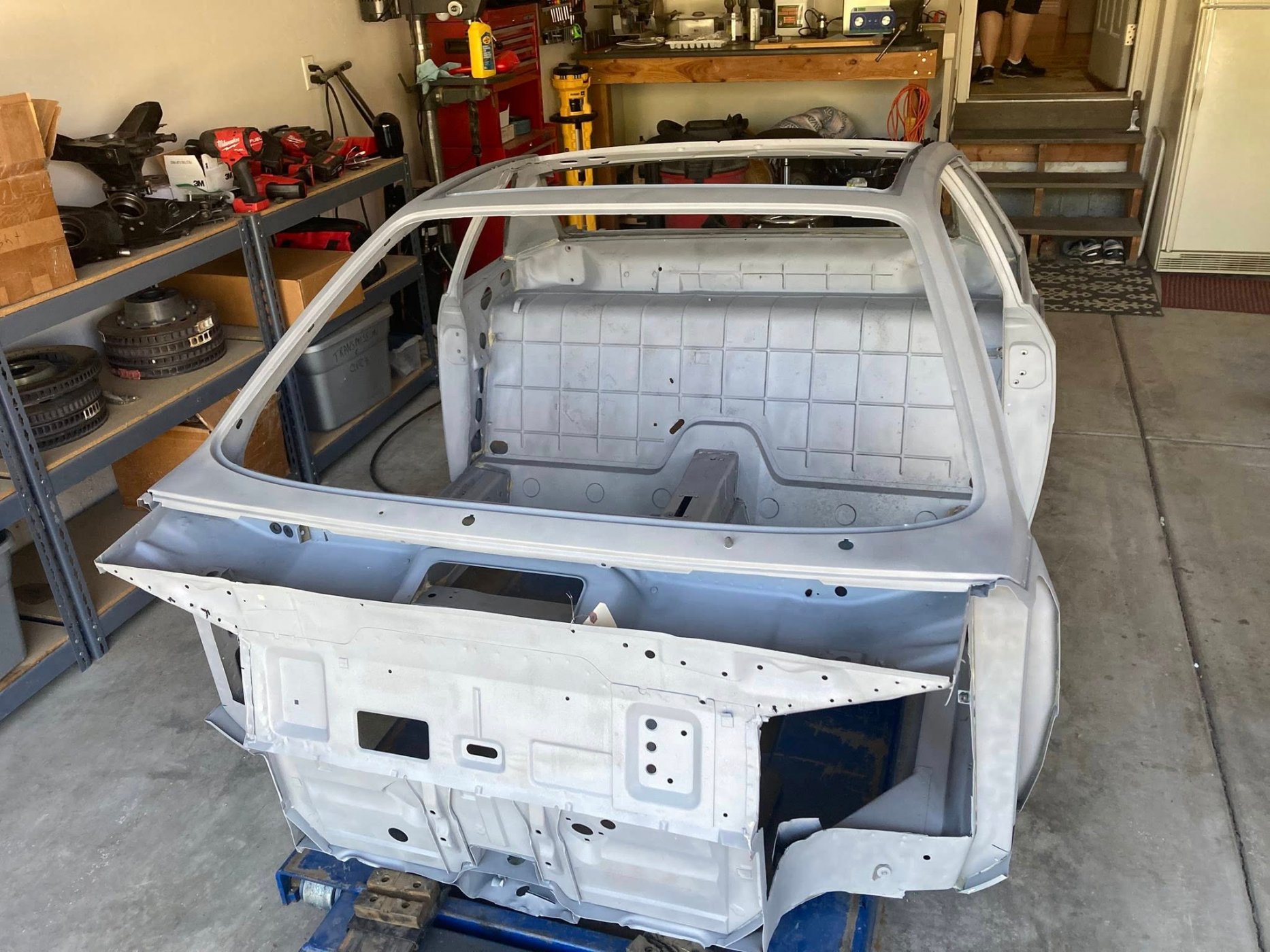

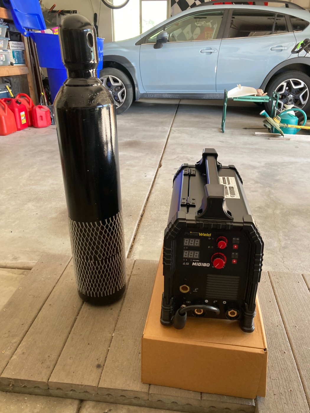

Bought my first welder, have some learning to do! I am planning to tack weld things into place and pay a professional to finish it. The cockpit is off to be sandblasted and should be back in a few weeks.

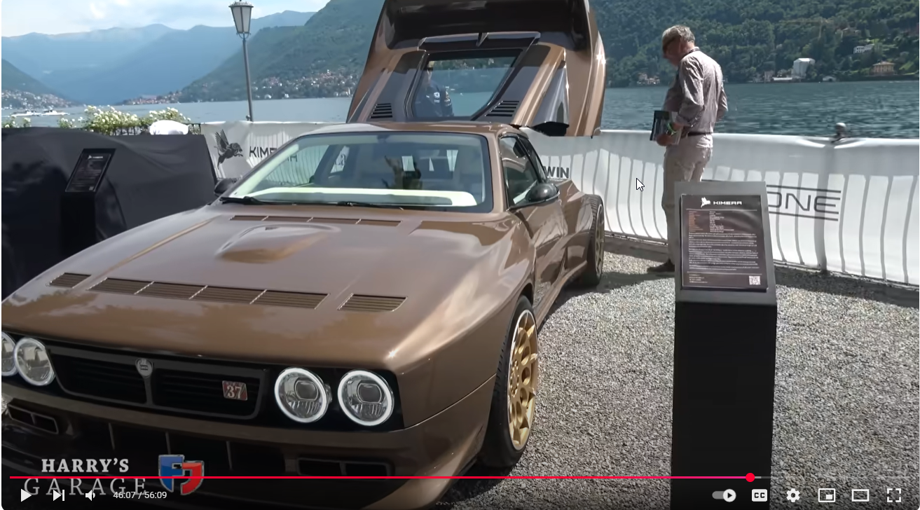

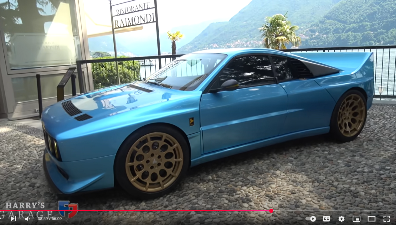

Harry Metcalf just briefly reviewed a restomod 037, i believe they are selling for 750k Euro.
