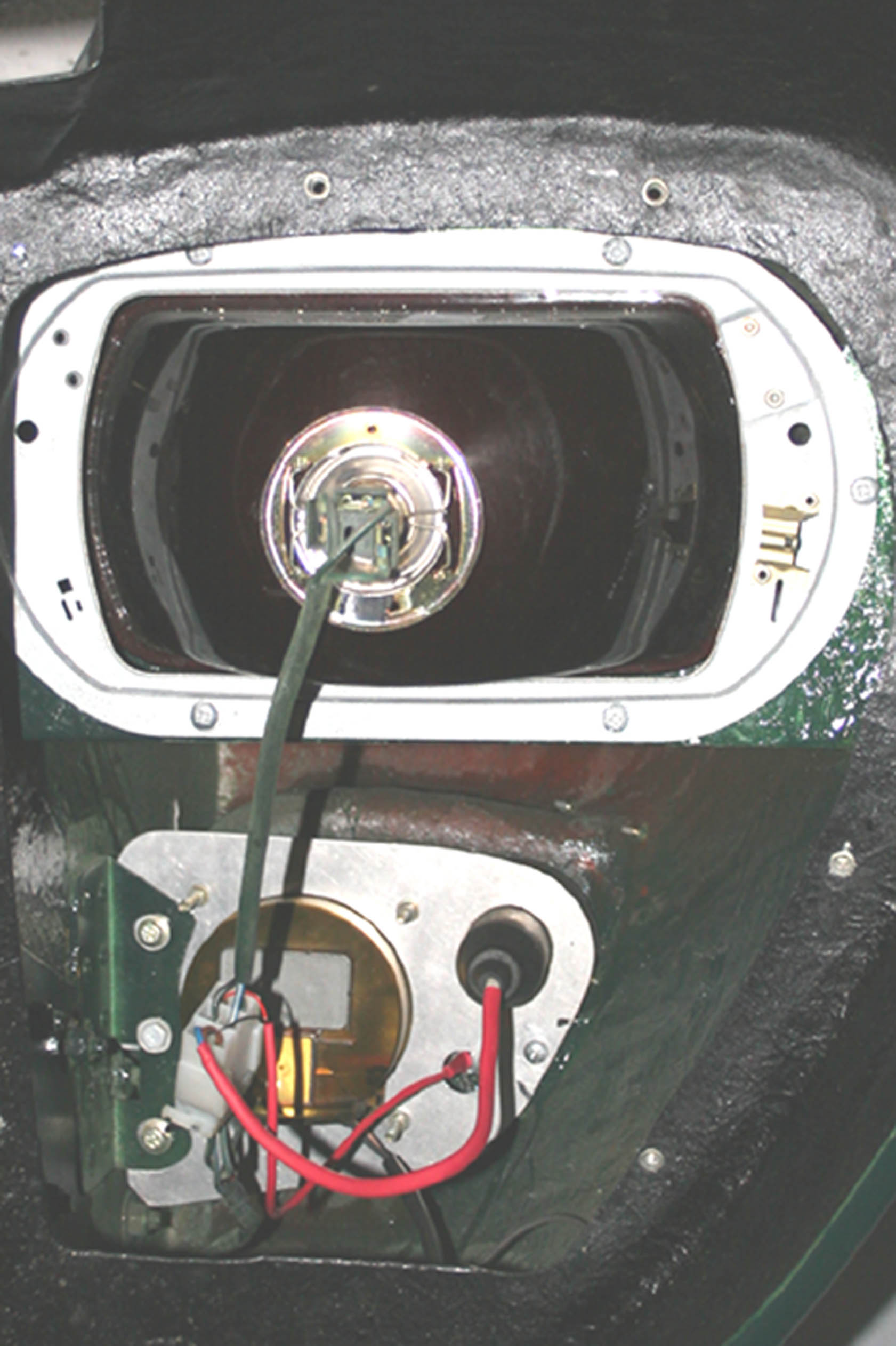

Paul ended up bonding in some metal brackets into the rear on my car (DAX Build up) in builders section - the metal lug locates on a hole on 1, (Bottom left) The top right is bolt fitted wit a pressure spring to take up slack and do rough adjust and the others are for the alignment.
Good thing on these units is the (finally horizontal) bottom bit is metal and can be drilled to take a side light bulb!

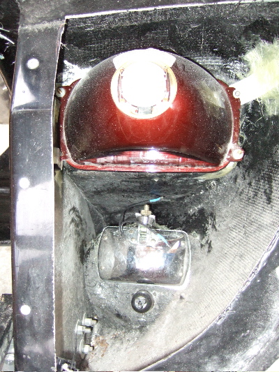

Geoff just advised it is all assembled and he would have to dis assemble to take pictures
He did say this is a picture from an original and I believe his looks very similar
Ian-
My headlamps are the ones shown in your first picture.
David-
Those look to be the corect mounting brackets. Where did you get them? And where can I get the bulbs?
