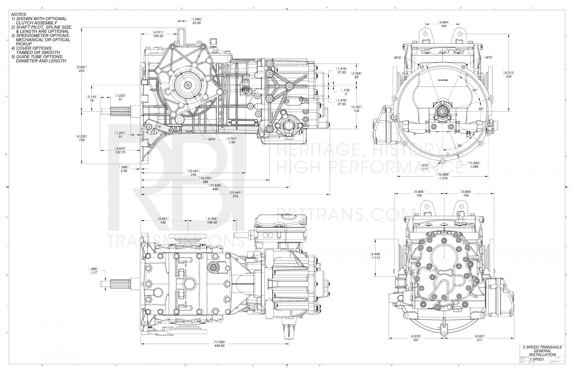

RBT 5spd ZF trans-axle:

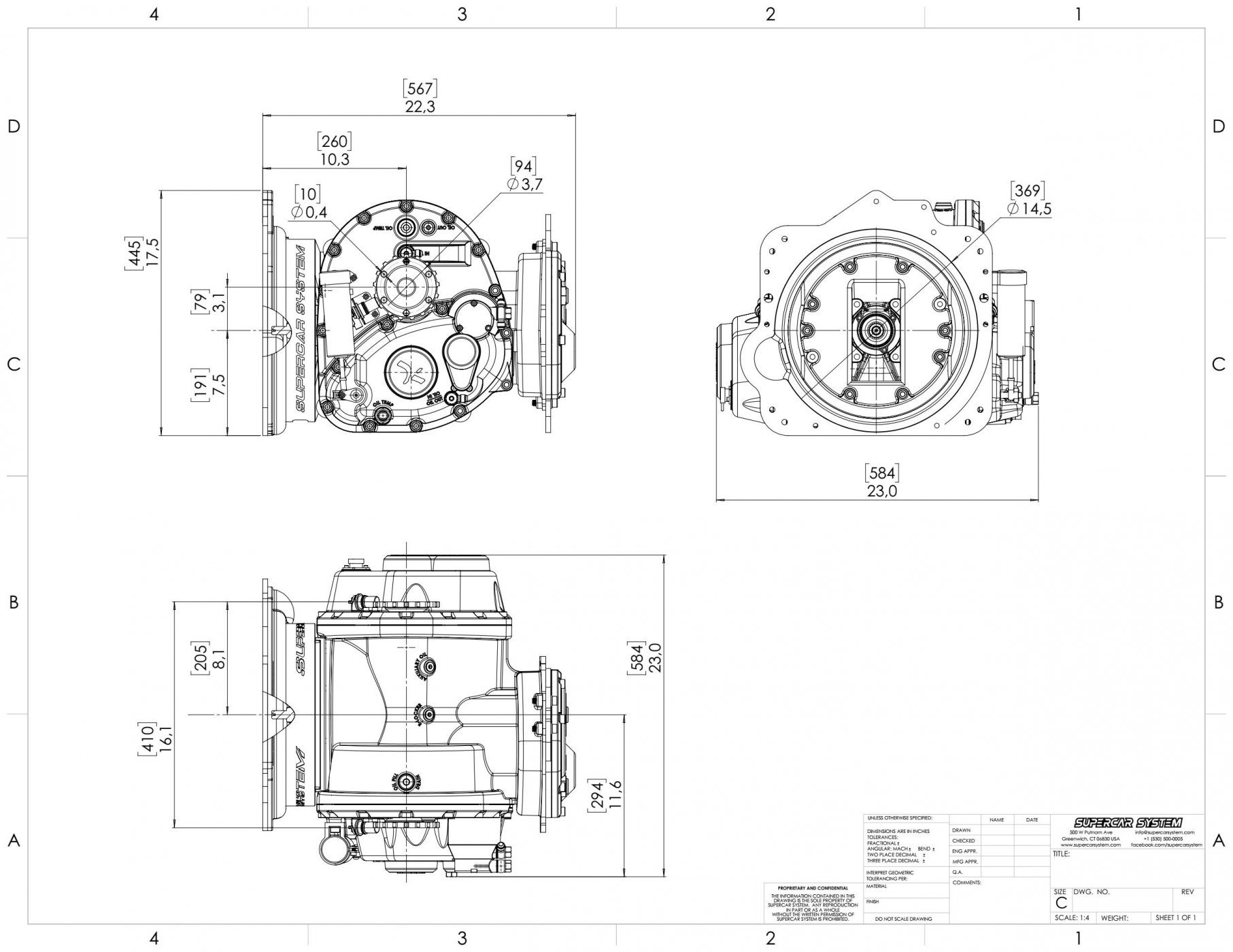

Supercar System (SCS) Gearbox:
I'm not savvy with trans-axle terminology, but I'll make the following observations. Assumptions: RBT does not show a bell housing and the SCS does. I'll assume the input shaft of the SCS is coincident with the face of the bell housing.
Dimensions
RBT SCS Difference
Input vs Output 79mm 79mm 0mm
Input end to Output 264.75 260 4.75
Length 692.75 567 125.75
Width 378 584 266
Output flange width 300 410 110
TheSCS challenges seem to be adapting the SCS gearbox to the SB Ford, and fitting into the GT40 rear frame. Drive axle geometry will have to be 55mm shorter than the RBT. I'll be anxious to see how it develops.
