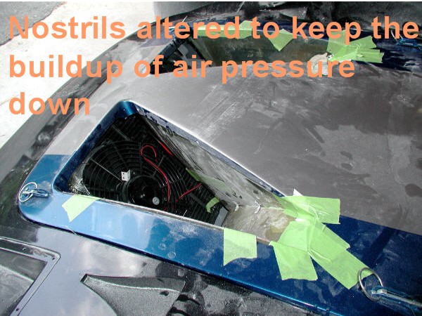

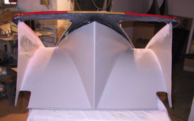

The twin nostrils don't flow air out as easy as the big single vent. however they can be improved by altering the shape underneath (see pic). They can be obtained from Frank Catt at Wealden engineering I think.

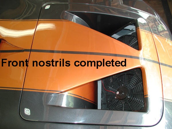

If you have the twin nostrils, any good fiberglass shop should be able to fix you up. I was lucky in that I had a guy who has worked on some of the originals and does work for several national race teams.

Looks really nice Bill - I particularly like how the stripes were done!
thanks guys. I have always thought the stripes should be completed instead of being leftout of the nostrils. Sort of gives it that finished look I think.
