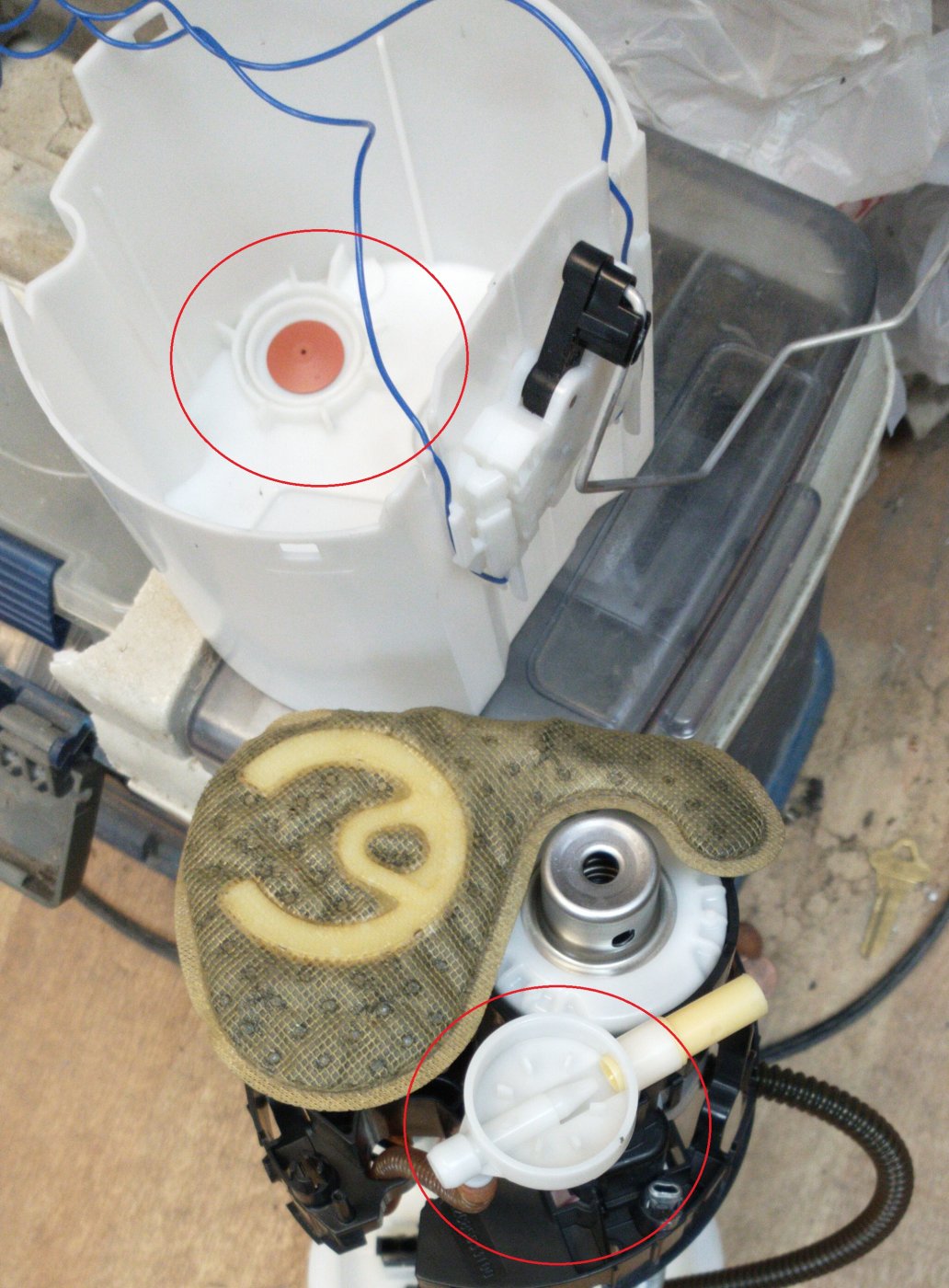

Well, one of my service van, a 2017 GMC has a dead fuel pump. Either GM had a batch of bad pumps or I don't know, but there are no fuel pumps to be found. Everyone is out of stock. So my mechanic brought this problem to me. For anyone else in the same boat, a 2010 canister with some mods on the indexing tab and pooging the connector looks like it'll make it work. But I found an interesting feature still present on OEM fuel pump modules.
I circled in red the venturi pump and where it sits in the canister. The little red disc is a rubber flapper valve that lets fuel in but not out. The little orange hose is from the integral pressure regulator.
This looks like a much better solution than the aftermarket solutions I've seen with foams and little trays and such. One out of a supercharged vette or camero (More flow that this 300 HP truck engine needs) may be a hot setup if you don't want to clutter the engine bay with a proper swirl pot.
