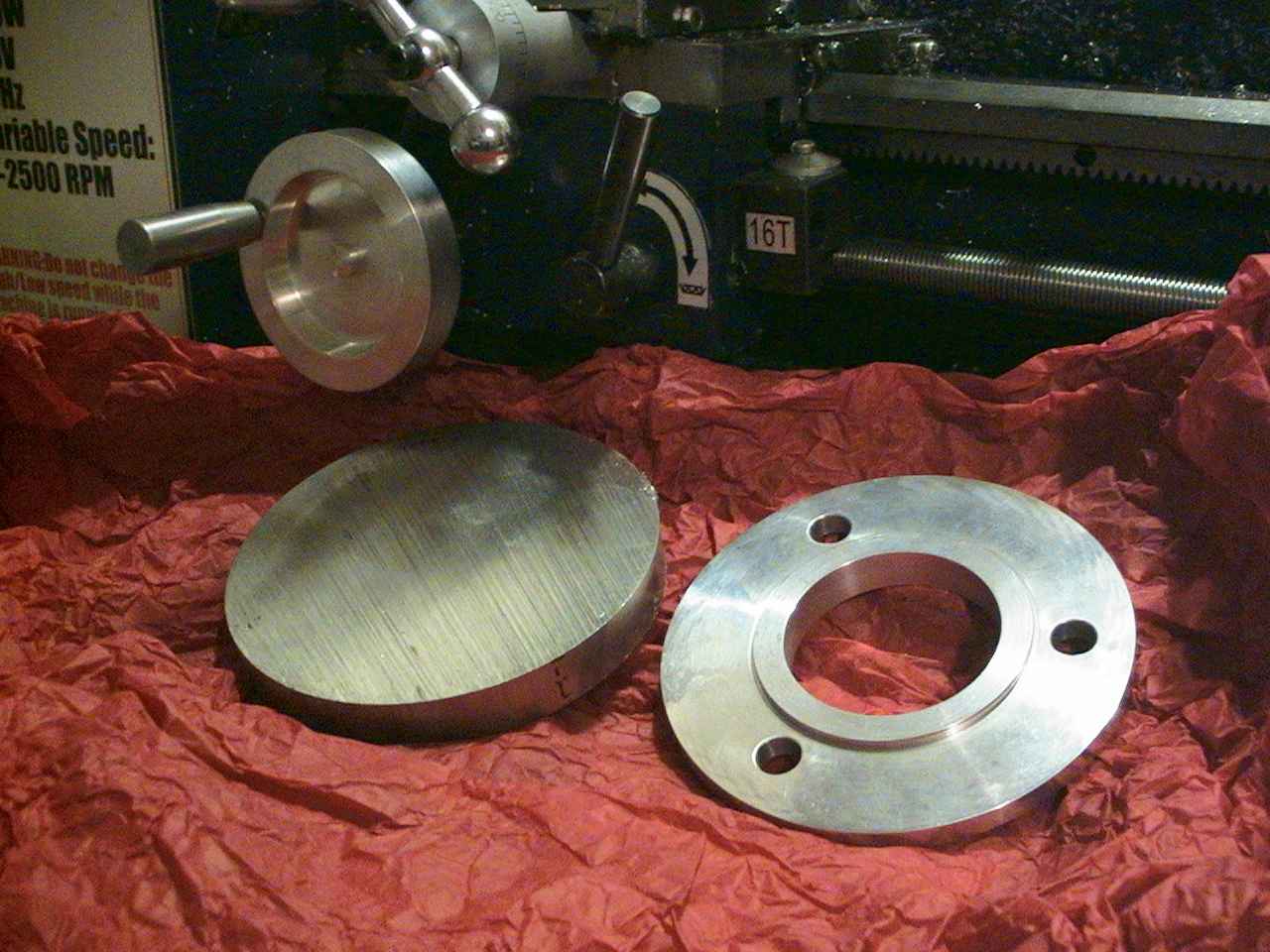

Not a pulley, but here's a before & after shot of a spacer made from a slice of 4.5 inch round rod. This is actually a little larger than the biggest practical size that my mini-lathe can handle, but where there's a will there's a way... /ubbthreads/images/graemlins/smile.gif
