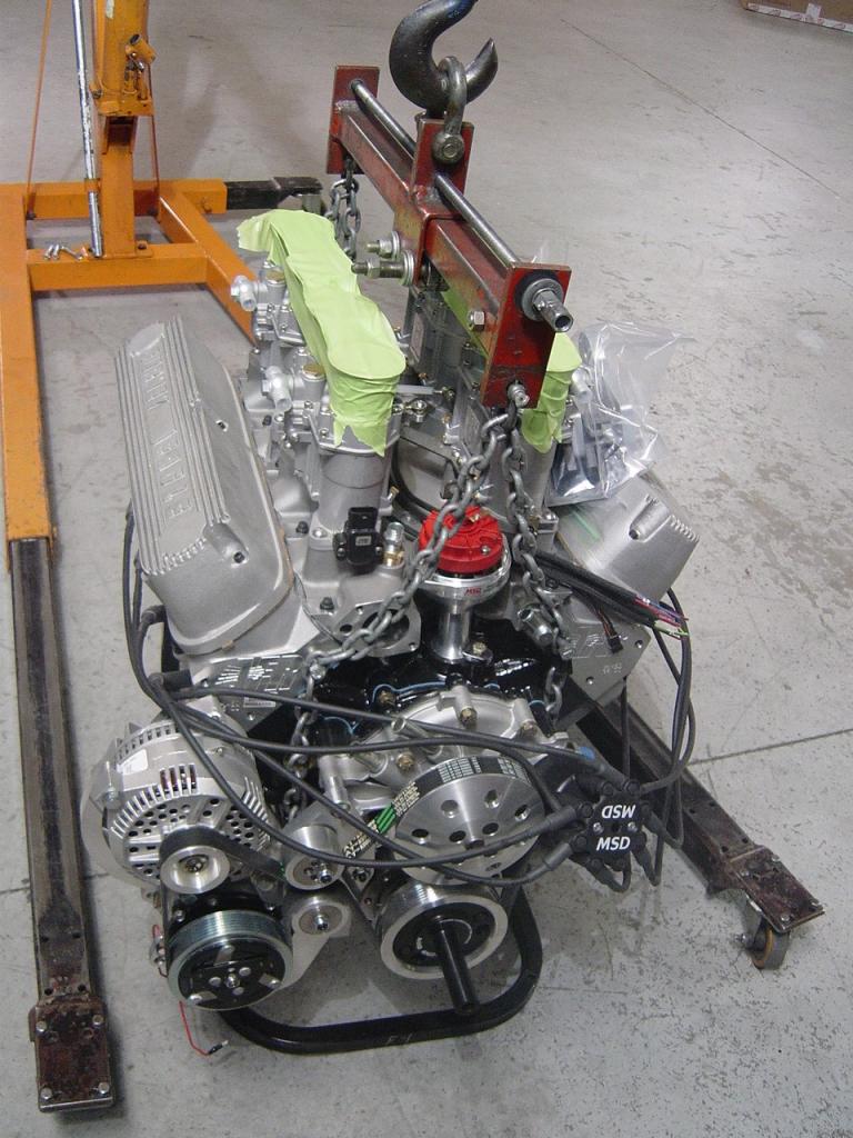

Rich,
I agree with the comments about alignment but since your question was about opinions on the Olthoff Serpentine system, I thought I would add my two cents.
Dennis did my install and I went with his serpentine setup. Based on my experience, I would give it a thumbs up. I carry a spare but in two years of use, the original one is still in great shape. As for motor Rpm, I have my rev limiter set at 6800, not that I go there very often, and have not seen any issues. The brackets and pulleys are machined nicely and the compact design seems to fit pretty good.
Hope this helps a little.
