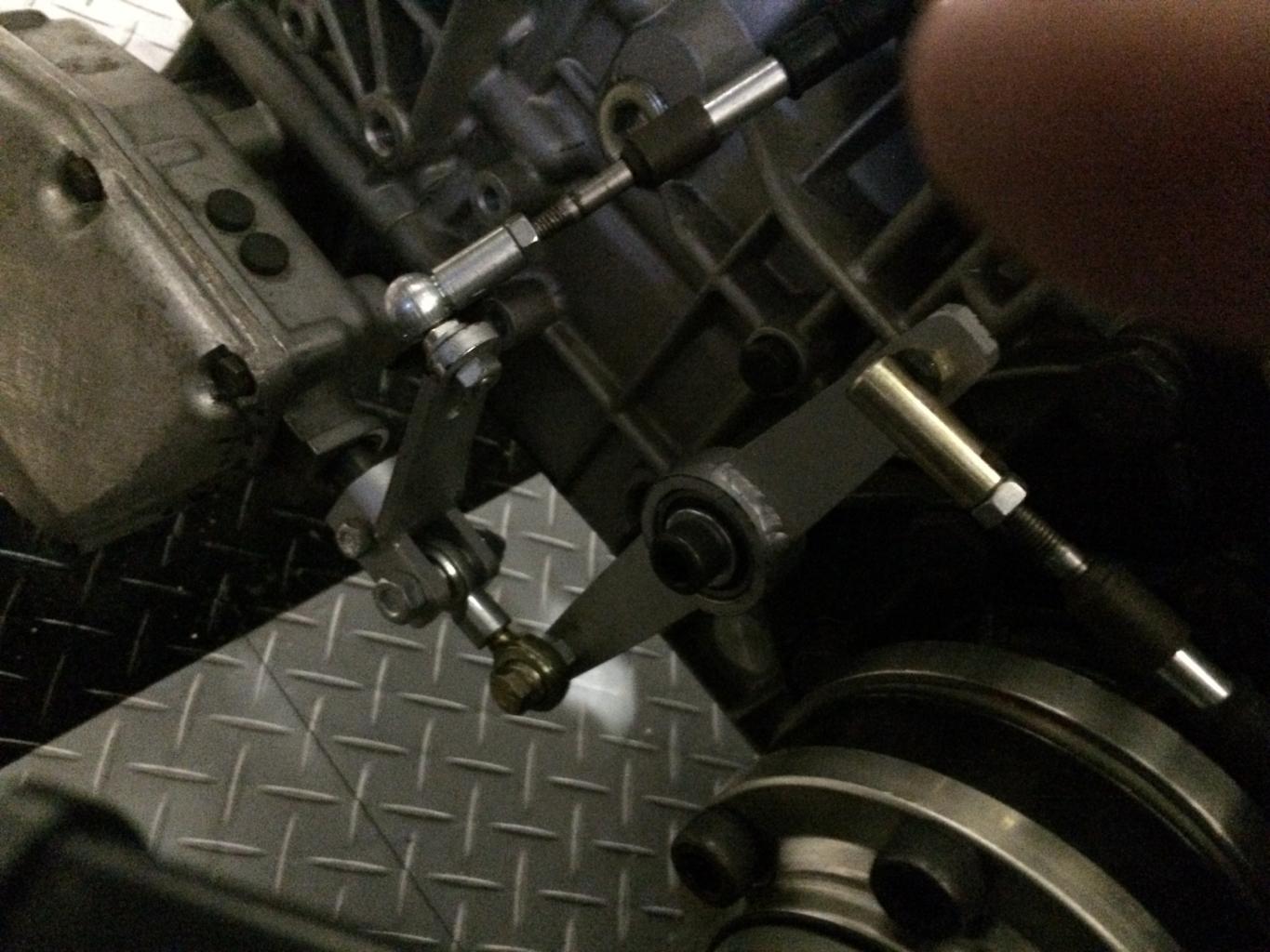

Some have asked me to post a photo of the new linkage. Maybe someone else can post a photo of the original linkage?
The biggest visual differences that I can see are as follows. The original linkage has a triangular base plate that bolts to the transaxle in addition to the linkage arms. The upper vertical arm on the original is tapered in steps, where the replacement linkage has a straight continuous taper from base to upper part where the linkage attaches.
- Jeff

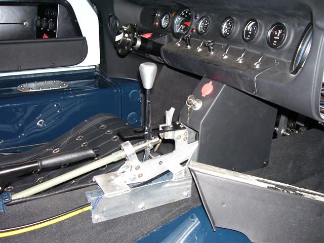

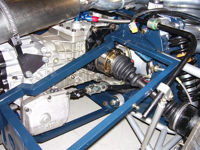

Here are some shots of the first car done P2125.
