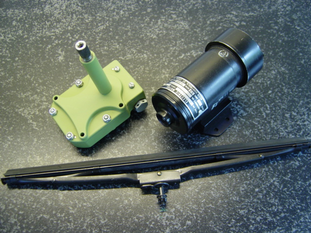

Got any pictures / dimensions of those Boeing Wiper motors Ian?
Thanks!
Ian Anderson
Oh yes and in case anyone is interested (or in the plane scrap scheme) the units asre the same on 707, 720, 727, and 737 aircraft (Or so I have been advised) but the older planes are the ones that were scrapped.
I believe the ones in the photo were from a 727
