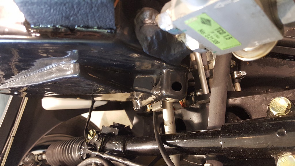

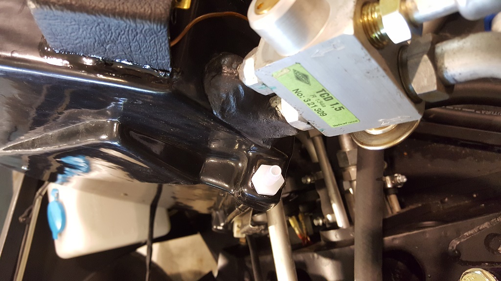

I have the enclosure out, as I have seen a couple of photos of completed SPFs with a clear tubing drain line exiting the front left (standing in front) of the enclosure. Thanks to those that weighed in or provided pics.
I have looked all over the outside surface of the enclosure and, unless I am temporarily blind - there is no drain hole. So, permit me a short rant:
HOW CAN SOMEONE FORGET TO PUT IN A DRAIN?

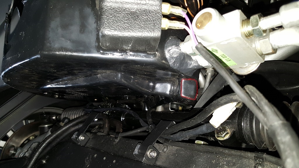

See attached photos, where I show the bottom of the enclosure near the front left corner. In the second photo, I have outlined what looks to be a "ramp" in the bottom of the enclosure - likely one of the lowest parts of the box. I believe the drain plug/hose should be in the vertical face of that ramp.
I plan to buy a threaded fitting with a push-on hose barb. The enclosure seems to be pretty stiff stuff, so I am thinking about drilling and tapping the threads, then installing the fitting with teflon tape.
Can anyone: 1) Confirm the placement of the drain from memory or pics, and 2) Lend advice for installation of the drain.

You're right about no drain Terry. Mine is just to the right of the red markings on your photo. Lowest point and slightly to the right of the A/C hard lines. The case plastic is thin enough I don't know you can thread it. I would use a plastic barb fitting and epoxy it in.
Dave,
Thank you! Check this updated photo. Is this the face you are describing (outlined in red)?
Tim

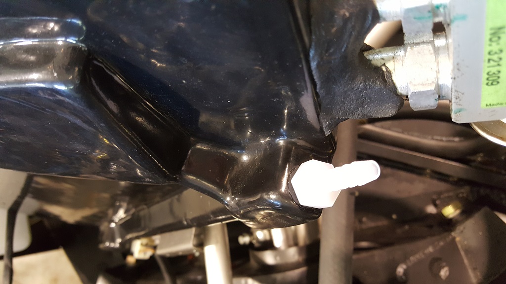

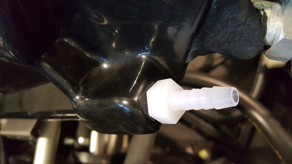

Thanks, all. I have a plastic barb fitting and will drill carefully. I let my dealer know, so they can provide feedback to Hi-Tech.
Update: Drilled and used epoxy for barbed fitting. 1/4 ID - 3/8 OD clear hose will be used.
