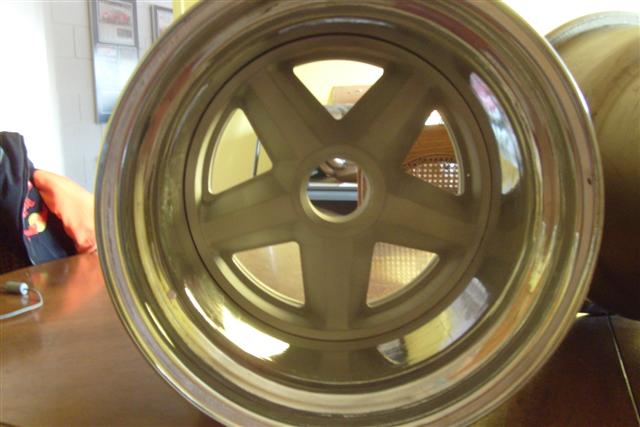

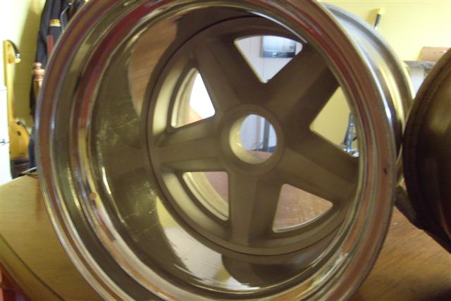

P4 and 917 Billet wheel centers....more coming

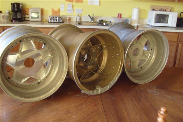

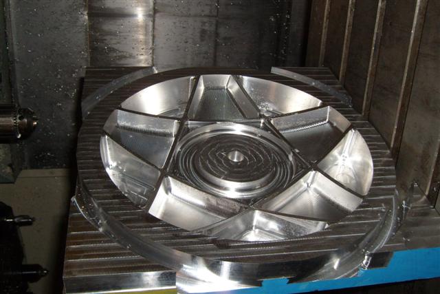

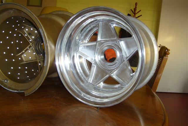

In an effort to continue bringing cool parts to our hobby...we have been developing some more correct wheel centers for the rarer cars....

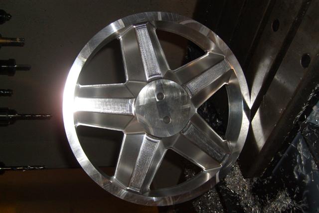

We have done a version for our RCRP4 and also for the RCR917's....the RCR70's are next...

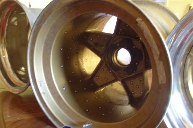

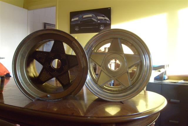

These are three piece 15 inch diameter wheels....

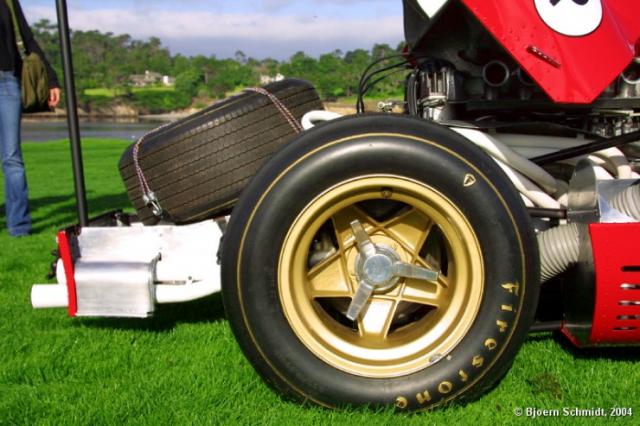

The gold wheel is an original Ferrari Campagnolo wheel....
The 917 billet center was media blasted to simulate a cast surface..
keep in mind these are prototype parts....but pretty representative of a production piece..

What's the inside diameter of the rim?

I will measure the absolute inside diameter for you....
We will be able to supply any bolt pattern and backspacing ...within the restrictions of the wheel halves obviously.

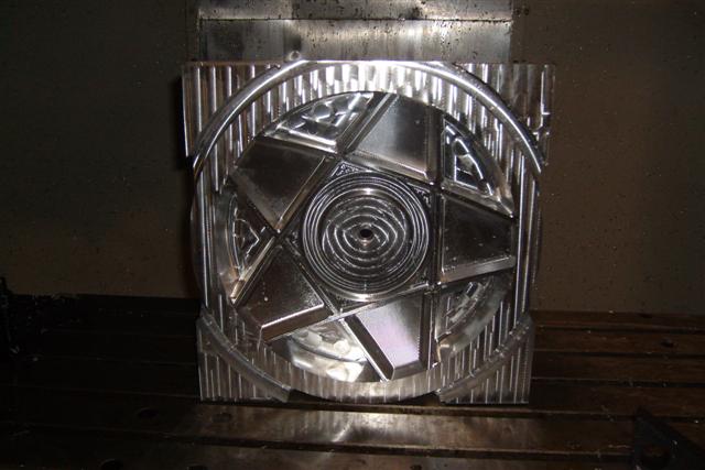

Is it possible to use a one piece rim section (as in a two piece wheel) and directly weld the spokes to the rim? Many rim makers use the two piece wheel method but like these examples you show for three piece construction - as you show they use a ring to provide meat (for assy bolts or weld surface) before joining to the rim. I imagine there would not be enough weldable material to just weld the spokes directly to the rim without the ring.
Nice work.
The inconsistent welding on the spokes only would potentially give you an out of round wheel IMHO....other more learn'ed people may have an opinion on that too....
The other thing we are experimenting with is an outer rim and wheel center being machined as one piece allowing a much shallower outer rim and then bolting on the rear rim as per a three piece...so it becomes a two piece wheel

Did you get to measure the absolute inner diameter for them 917 wheels?
BTW. 917 have the spokes on a angle normally don't they? the center is deeper than the outer edge. Are you going to do this?
Greetz,
Bram Boekestein
Holland
Bram,
I have original 917 wheels at the shop and the billet is a direct digital scan from the original.
The billet center has more draft on the spokes than may be visible in the pics...it is not a flat 5 spoke center.
The wheels we have, front and rear have the same spoke profile...but a much deeper offset obviously.
If there is a specific wheel you would like replicated for your RCR we can certainly explore that option too.....
