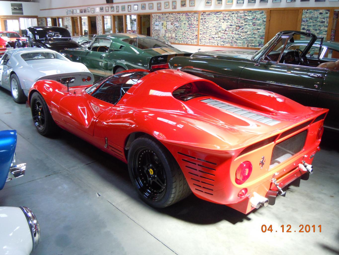

P4 with Maserati V-8?
Dusty
Wow that place had some sweet cars for sure. I had to catch my breath at the Porsche 935 and 959 pics.
That pic of the P4 replica at Fantasy Junction was built by my friend and his father in Arizona. It uses a 308 v8 and a heavily modified porsche 915 trans. Penski shocks, pushrod suspension, blade style swaybars, ISIS wiring system, A/C, keyless entry, really trick home made quick release windows. It started as one of the NF P4 kits but they modifed so much that it is really their own creation. The attention to detail and the quality of the car is AMAZING. And all done by a father and son in their home workshop. The ONLY thing they didnt do was the paint.

The 'Fantasy Junction' P4 is a fabrication masterpiece. I saw the car at SEMA and the construction and many modifications are first class to say the least. Spoke with the builder, he gave me a tour of the mods and was a real car guy who is rightfully proud of the creation he and his son built. I even think I spoke to TrevorM in the ISIS booth (?)
Luckily Fantasy Junction is juuusssst far enough away that I don't go and drool very often. For a treat go to the FJ website and look up the Ferrari, they have a nice collection of vids on the car.
Mesa...I am not the Trevor M you met at the ISIS booth, the TM you met is one of the builders (son). But we have met when Howard's SLC was delivered and a bunch of guys went to his place to check out the car. Joe and Trevor M certainly did build a superb P4.
