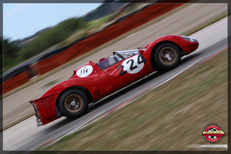

Thanks for the picture! I didn't think the 456/550 engine fit in the RCR P4?
Fran would need to step in here. My P4 isn't an RCR. I have a tube framed chassis, which may be easier to adapt than Fran's Mono? (Easier being a relative term). But Fran has fitted the 400i V12 into one of his P4's, so I can't see why the 456/550 lump couldn't be squeezed in there.
You certainly have an advantage as far as your height is concerned. The major problem is getting it all in and maintaining a reasonable drive shaft angle whilst maintaining enough cabin space for the occupants.

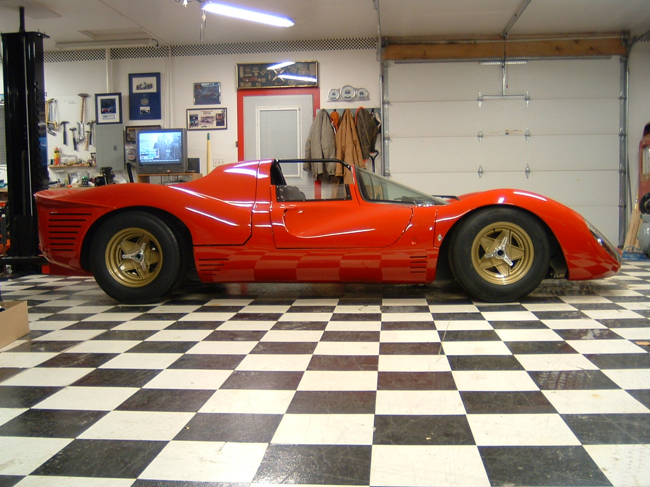

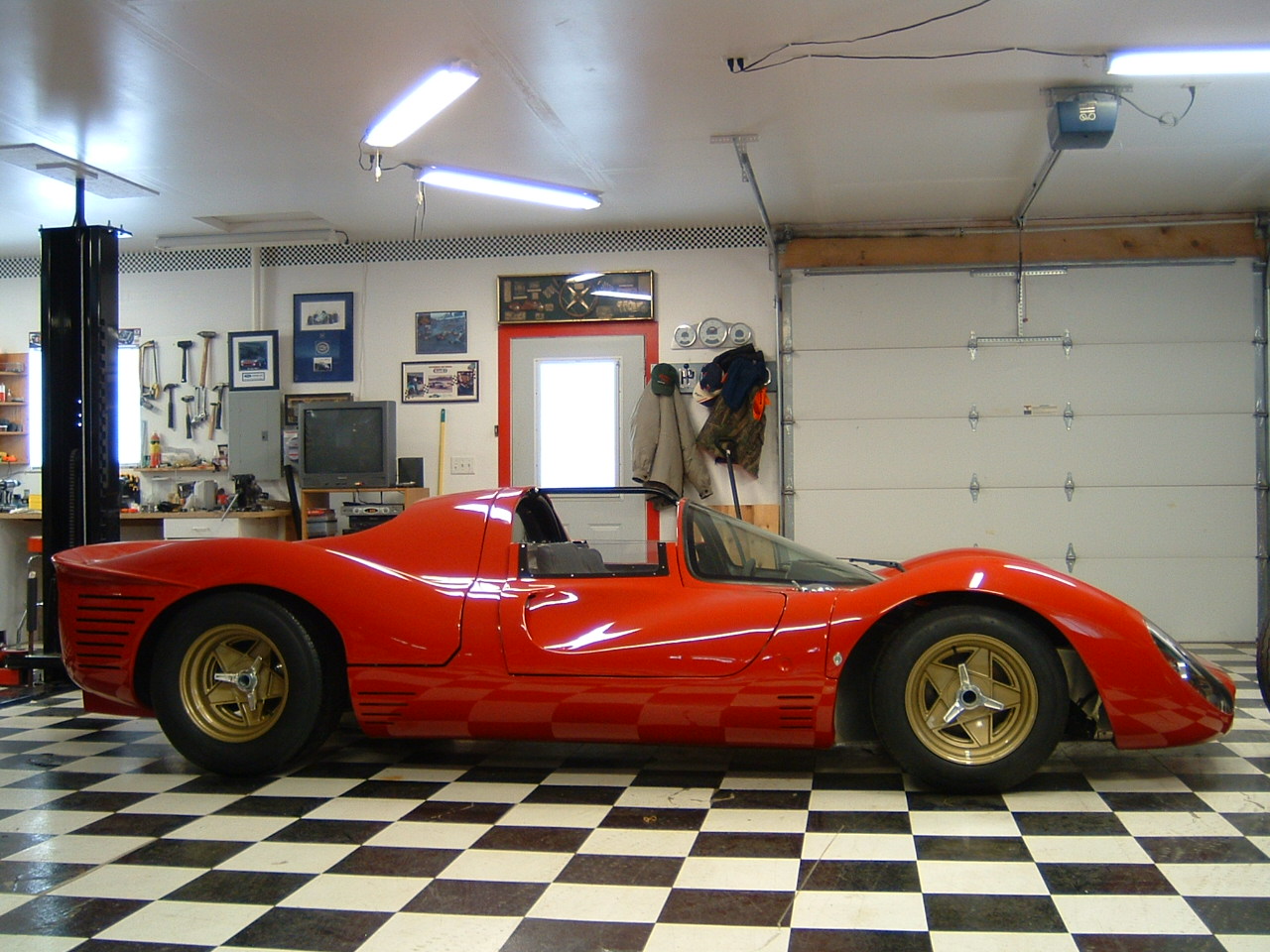

Thanks for the post Marc...those 15's do look great! I guess I am just worried about the lack of tire choices in the 15 inch sizes. What sizes did you go with front and rear?
The first photo is my P4 with 295/50VR15 Avons on the rear and 225/65VR15 on the front.
The fronts didn't fill the wheel openings very well so I replaced them with the 245/60VR15 Avons. I think they looked much better.
