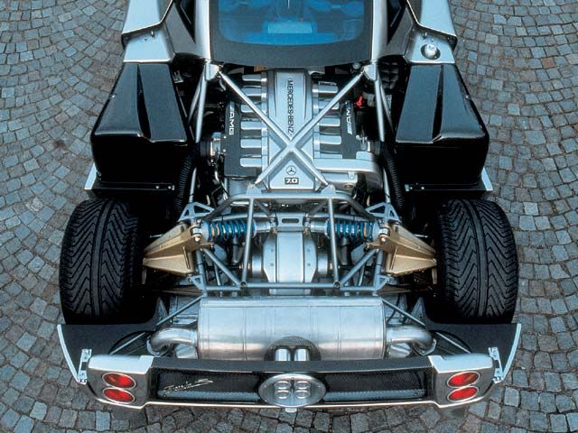

That Pagani sounds more like an F1 than a vintage Ferrari. i'd bet that with a proper exhaust the Merc could get pretty close to the Ferrari's sound. What about a BMW V12? The guys in South Africa used it in one of their cars.

Thank you for the warm welcome and responses everyone. I am very short, 5 feet 7, so perhaps that is a plus for packaging? The Pagani Zonda motor I thought was a 7.3 liter Brabus built engine, based loosely off the 600 engine? Please correct me if I am mistaken? I appreciate the comments about the 550 Spyder as that is another car I have been wanting for a while. I just received a quote for that car, turnkey for $45,000. A little more than I expected to be honest for that simple a vehicle. So with the P4 roller at $45,000 with me supplying the engine and gearbox, would around $65,000 sound in the ballpark for a complete car? Or am I way off and it would be higher? Thank you again everybody for your assistance.

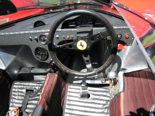

Yes I realize I would need an ecu and the engine accessories which I would provide. But headers, exhaust, plumbing, wiring etc..etc.. would need to be done by Fran's shop. I was thinking of Rosso Corsa or Fly Yellow for the paint, or perhaps Aston Martin Storm Black. I would love to have the Ferrari gated shifter installed also. Just got a ride in a friends straight piped 550 Maranello....wow what a sound! I am not sure that motor will fit in either the car or my budget....It seems that $95,000 may be a more realistic number with me supplying the complete engine and transmission. Does anyone have some interior pics of the P4 cabin...my wife is wondering if she will be comfortable....let's hope not!

I have a Ferrari V12 from a 456GT going in my P4.
Here's a pic of the Ferrari cockpit a few years ago when the car was in spider config.
Good luck on your journey.

Thanks for the picture! I didn't think the 456/550 engine fit in the RCR P4?
