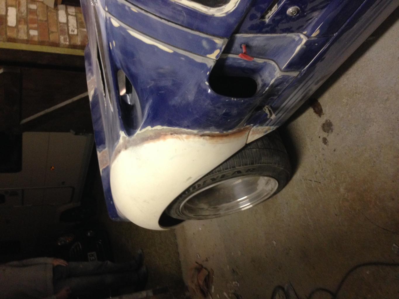

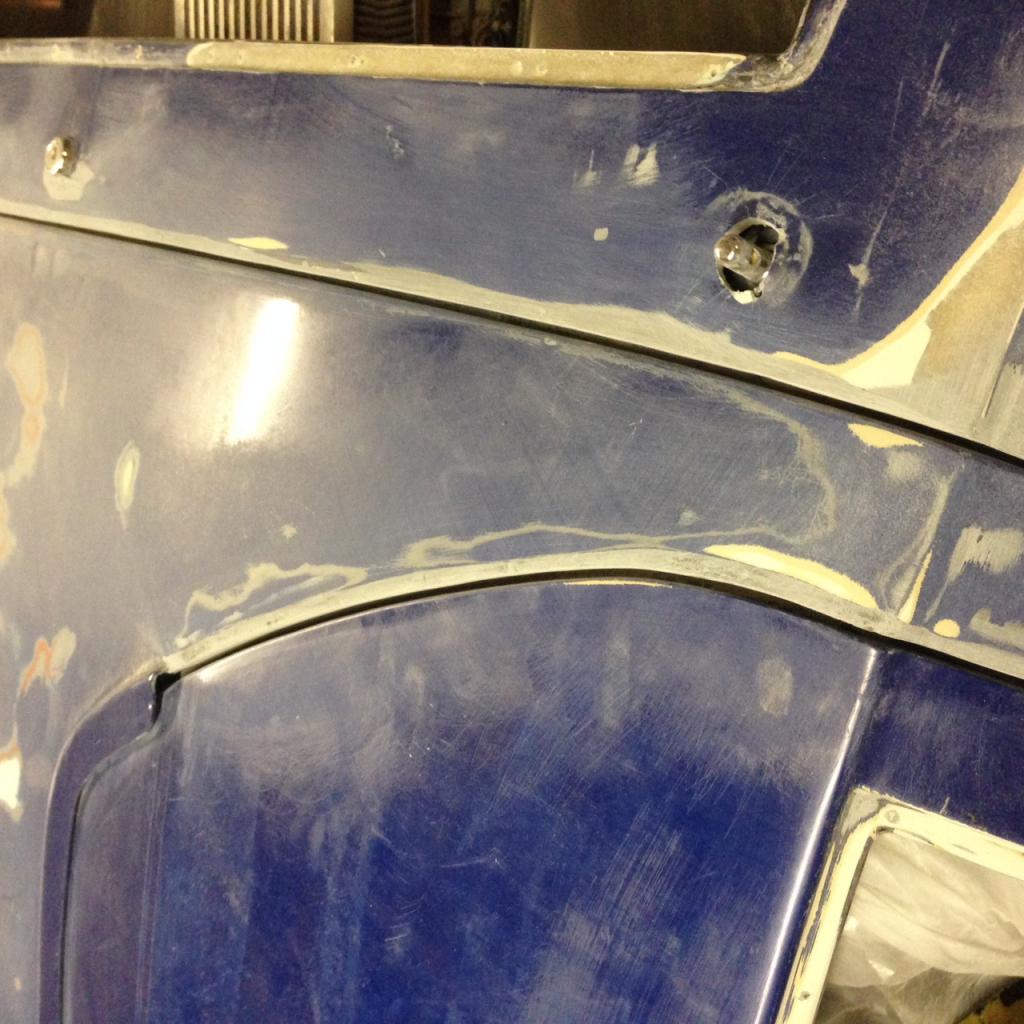

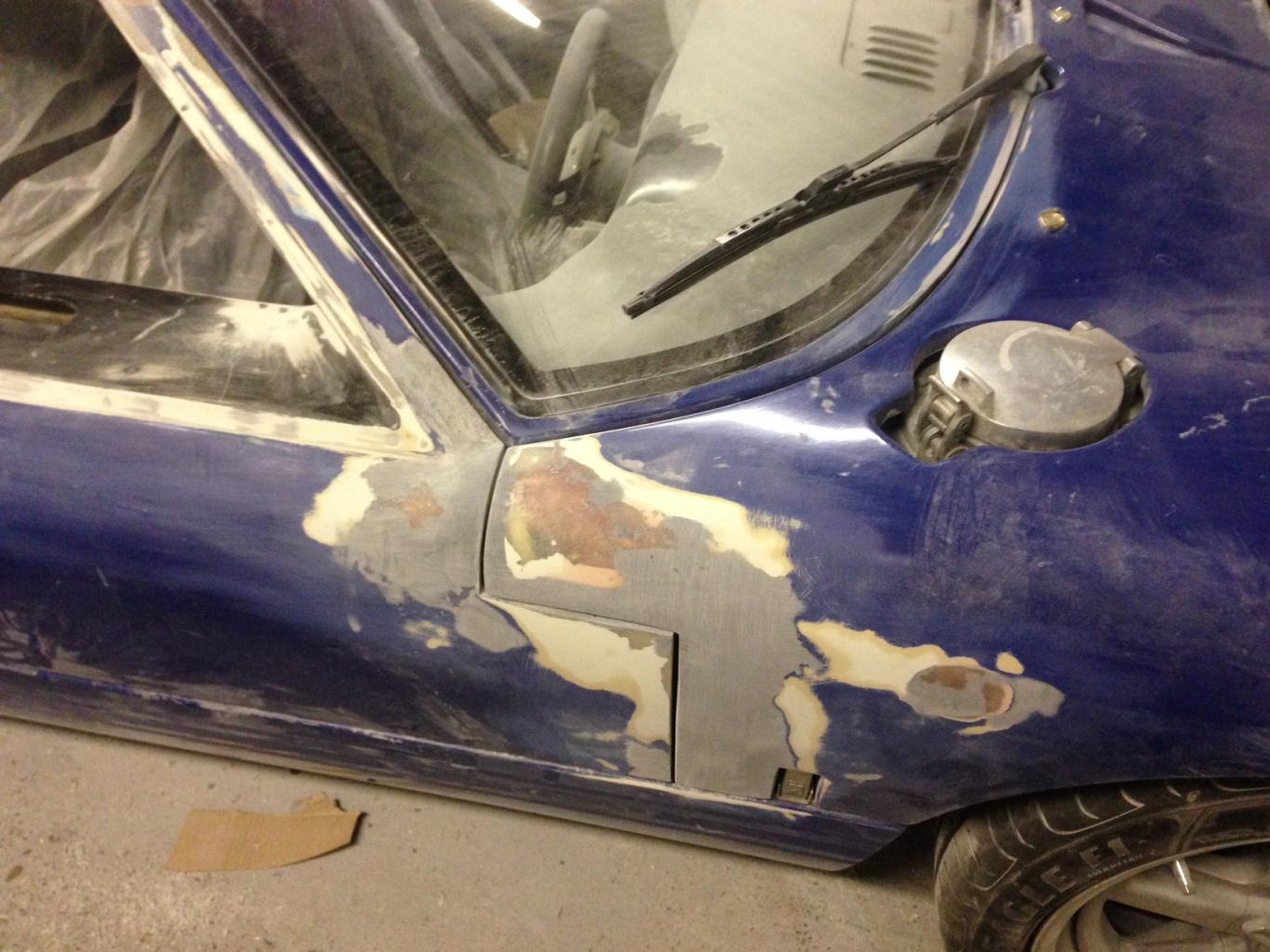

Here are a couple of pre-paint updates...
I made a new nostril by cutting the old twin nostril and forming a new single airway by making an MDF/flexi-ply mold and glassing over it - it's pretty deep but seems to have a great shape to it.
The rear arches are courtecy of Dick Townsend as the set I had purchased from eBay previously were a really bad fit.
I managed to glass & fill all of the panel gaps to a consistent 3mm using flexible Foamex strips as spacers.
I know it looks rough, but you should have seen it before!
