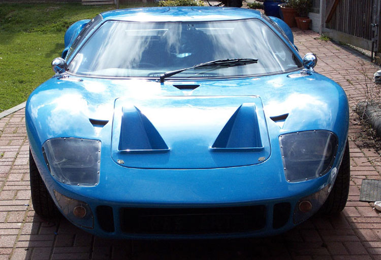

Hi Simon,
Yes, I painted the 'eyes' black & it improved the look of the car tremendously. (IMHO!)
I used Halfords Satin black aerosol with the correct primer. With careful preparation the results were really good.
My car is in for a re-paint at the moment & the sprayer remarked on how good the finish was. He was pretty suprised to hear it came from an aerosol!

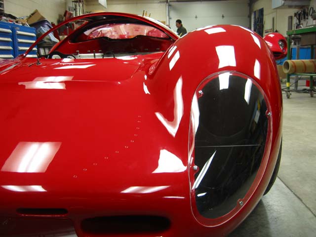

Here's a picture of mine.
I painted mine in a black satin finish.
From what I've read the drivers complained of the reflection of the headlights off these surfaces mostly in the rain or fog at night. It basically created a halo that was hard to see through.
I block sanded my recesses, masked off the entire front clip and sprayed.
Mark

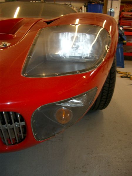

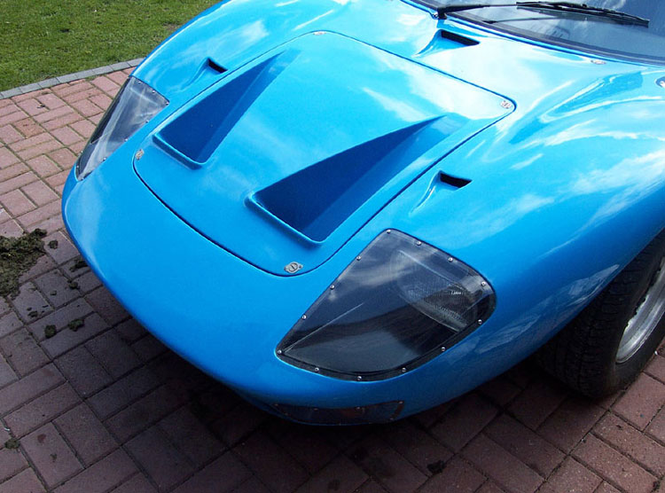

I've been thinking about doing this for a while, too, and this topic finally got me off my arse this weekend. Here is a shot of my car with the left side recesses done:
And another of the left side. I also used satin black spray paint. After a bit of block sanding I taped off the lights, adjuster screws, etc. and then covered the rest of the car. It took about 90 minutes per side and I really like the way it looks--more sinister than before:

Bob, seeing the one half done, shows how much difference it can make. Have to compliment you on the whole colour scheme, looks really good.
Dave
