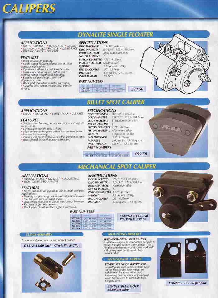

Wilwood (amongst others) do a mechanical spot brake caliper for handrake application. This is mounted separately to the normal caliper.
In the UK Rally Design sell them, along with brackets to weld to the upright.
Rally Design
