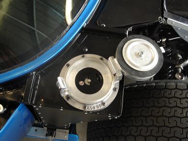

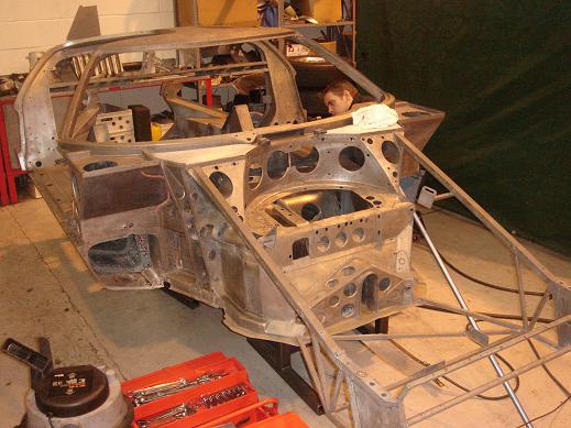

pics of 1062 rebuild

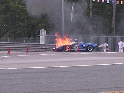

Enclosed are a few pics from 1062 being rebuilt after the Le Mans Classic fire.
A leaking fuel cell under braking for the first Hunaudieres chicane at some 175 mph, caused the fuel to fly out of the sillon to the front brake, ignited and flashed inside.
Fortunately the extinghuiser worked.....
Only the fuel burned and some of the paint, nothing else, but we decided to do a full rebuild anyway.

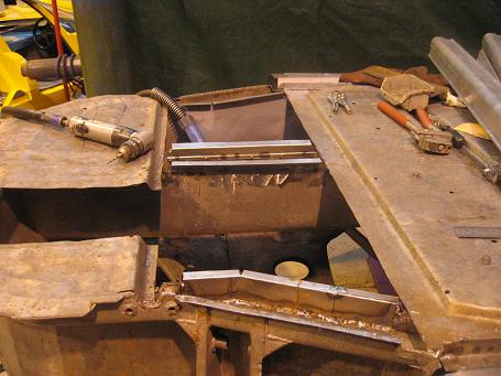

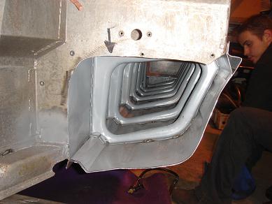

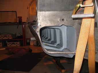

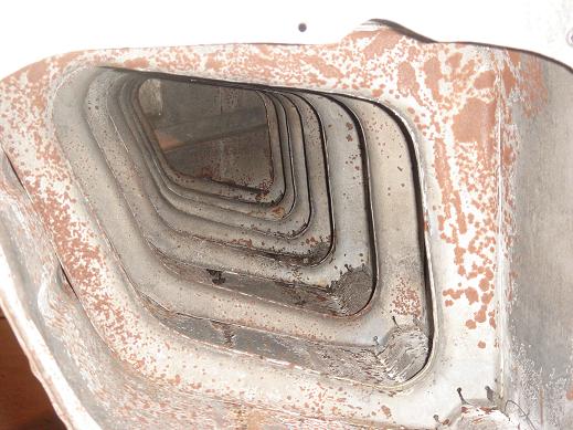

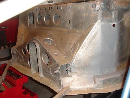

The inside of the sills was very rusty and the ribs had to be replaced.

More, more, more! I love these kind of posts. It is great to see fine craftsmanship and care put towards restoring a classic. Thanks for posting!
I noticed that the taper at the end of the sill is missing, this needs to be part of the sill before it is fitted to the car, that is why the profile doesn't seem fit the lower wheel arch closing panel and the same will occur at the rear, interested to see how it was rectified, any more pictures?
Roy,thanks for the tip.
I don't know hoe that's been done,I am going to check.

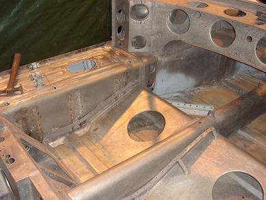

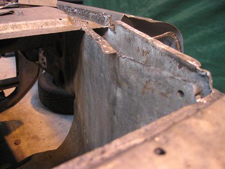

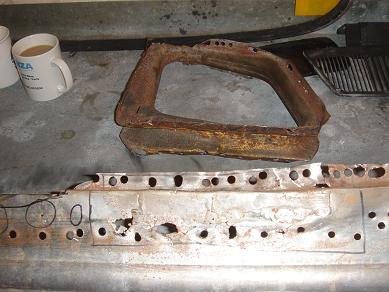

Some more pics of the rust we found after acid-dipping the monocoque.
You can see GT40's were never built to last this long.
It also shows the risk of not restoring an original car.

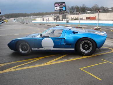

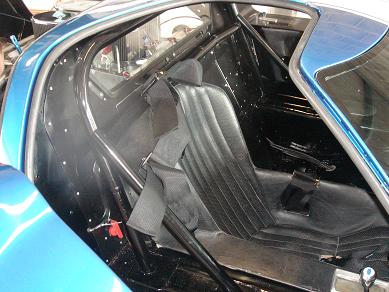

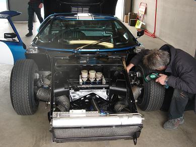

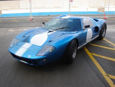

1062 had it's first tracktest today at Donington after the almost 2 year rebuild.
We had some problems in the beginning but once that was sorted we worked on the set-up; first in the wet and then most of the track dried out.
After having played with the shocks and roll bar we got it close to where it has to be.
Maybe we need to lower the front a bit; it had good turn-in and it was easy to slide neutrally on 4 wheels.
Great to have it back and ready for racing!

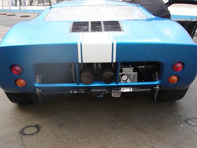

HHH, is the rear body section from an early car? I ask because I thought the dual tail lights ended around chassis P1036 or so. Terrific work on the restoration.
Mark,
These are the lights that have always been on there. We transferred them from the original rearbody which was like 50 kg's......
We hade a new thin fibreglass rearbody made to the same form as the original.
Lovely pictures of original car, please add further pictures of rear engine bay.

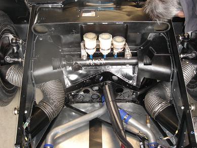

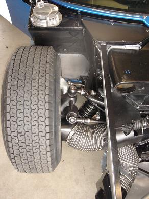

Some more pics; next time I will make a complete series.
Ran out of time after the track test, but at it's first race we'll get some propers pics.

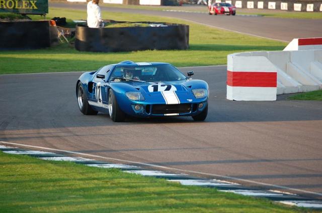

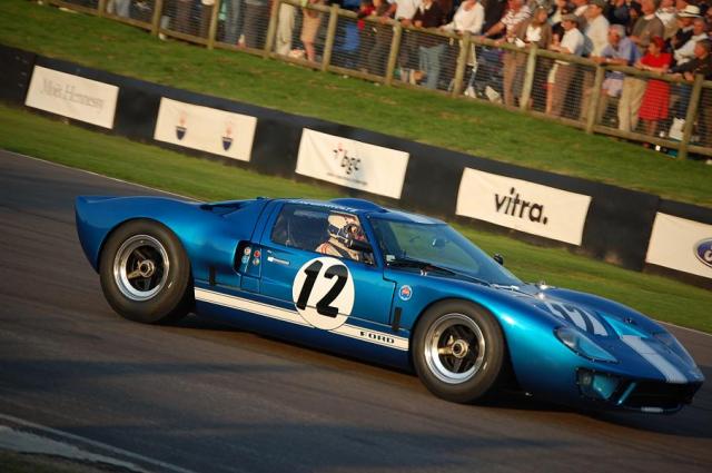

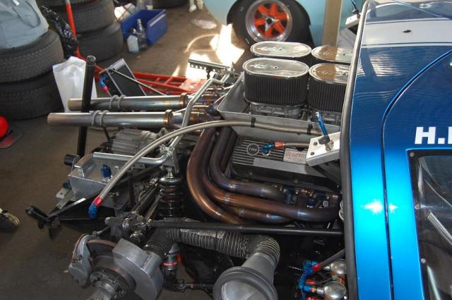

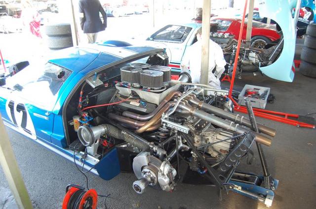

Some Goodwood Revival pics of 1062, showing the new exhaust system.
With the original discs being solid and the speeds we are running, you can never get enough air to the discs. They are effective.
The Le Mans lap on You Tube is 1062 during first practice.
You will see the rev-light come up as the diff was too short and I had to lift off at 7,200 rpm......
