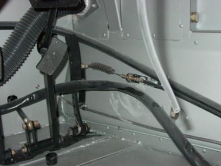

Anyone have a picture of how the throttle cable connects to the pedal at the pedal assembly? The manual mentions a bracket and picture but I don't see that in the manual. 2.3.3 is where it is supposed to be. Seems a simple pull affair but I'd like to see how RF does it before I decide to make a bracket. Thanks,
Ron
here's one

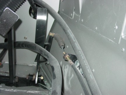

and another. I hope I did this right or I may be pretty embarassed!
These all look like right hand drive. Does anybody have any photos of a left hand drive configuration?
Just a guess, but could that bracket strap be cut down allot shorter and just riveted to the tunnel . The huge bolts seem like overkill and protrude a bit , making the covering or carpet come up just a bit in a sensitive area that may be rubbing the side of your foot. Just thinking ??? Dan /ubbthreads/images/graemlins/crazy.gif
